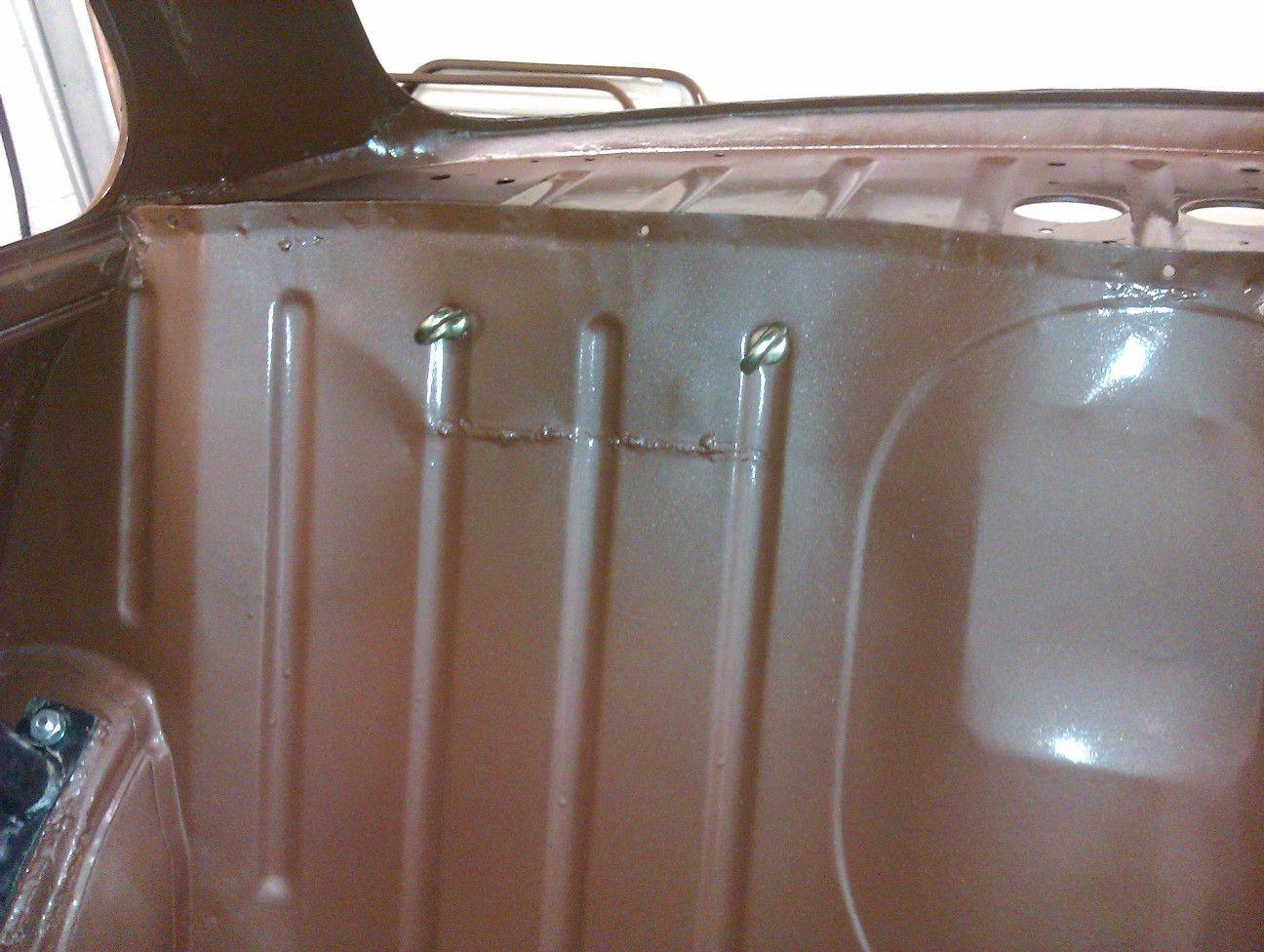

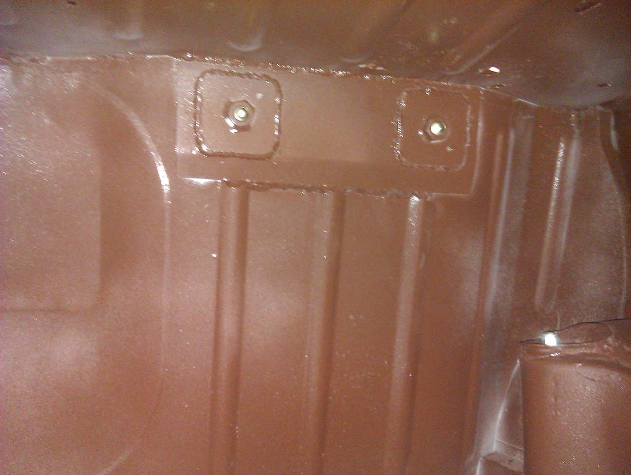

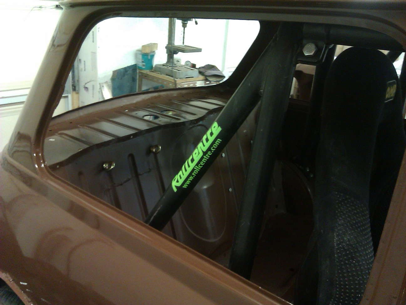

OK, here are some pictures of mine. In the boot I welded in a big plate. Then welded the I bolt plates onto that. I have also welded in the parcel shelf all the way round.
From the front it looks like this.
http://www.twin-turbo.co.uk
