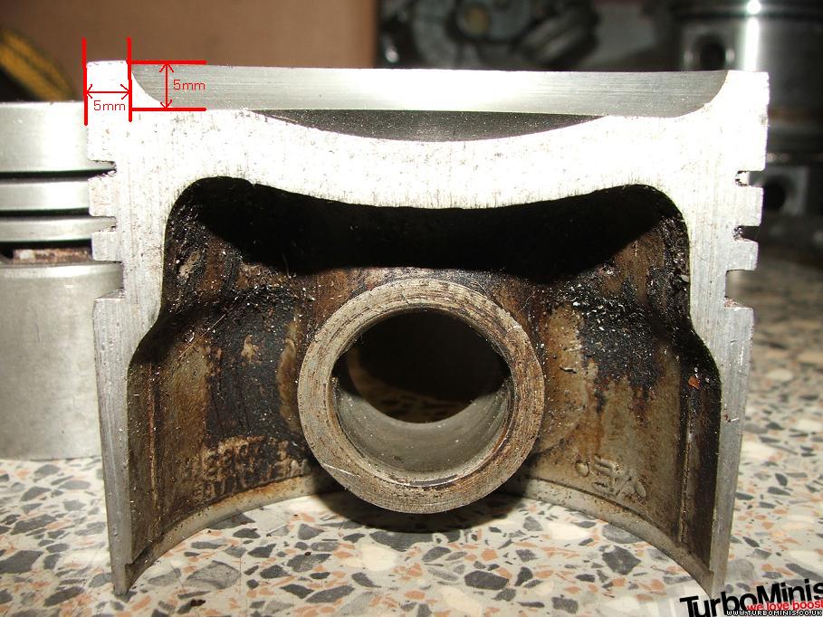

This is the best I have found so far
Basically cut the dish 5mm deep with a 6mm radious cutter leaving 5mm from the outer edge at the squish band. that resulted in the most even crown thickness and gaining another 4cc over an unmodified piston.
Note though that the pistons were removed from the rods, and that is the difficult bit.
Mike

that statement sounds familiar *happy* And that will give a dish something like this

I think that picture is of the sectioned piston that accompanied the ones now in the A35 - right, Colin ?
Indeed:)
The engine in Alex-B's old frag (whereever it is now) also had a very similar set of pistons machined for me, in about 1998, LOL.

on the pic of the piston it says 5mm deep, 5mm from the edge, but its looks to be machined twice as deep compared to the material thickness left on the outer edge of the piston in the picture.
so does that mean 5mm deep and 5mm dia not radially in from the edge?
You shouldn't have gone to SpecSavers*tongue*
That picture is 5mm deep 6mm rad, and 5mm squish band *wink*
have i missed the distance between the outer edge of the piston and the fire ring on the head gasket then? as that space would account for a certain amount of squish area???

the red lines just show up the difference more, if both are supposed to measure 5mm then fair enough. it was just obvious from looking that the 2 areas aren't the same size. thats why i asked about how the measurements are taken. the difference is alot less than the amount i was initially thinking. but i wont bother booking at specsavers just yet, the lines show my eyes work just fine *tongue*

No I think you'll find that my comment on specsavers suggests that you have already been, got their specticles and have worse eyesight, like the thousands of other people that use spec savers for their eye focal correction devices.
I'm still not sure how you would consider the two dimentions so different, that you have to be so pedantic about the lack of my drawing ability. what you don't seem to take into consideration is that there is a small radious on each edge of the squish band which makes it appear narrower, but it is certainly does not look half the deapth as you first suggested.
I'll say it again, wether the picture looks like it or not, the dimentions are 5mm deep 6mm rad 5mm wide squish band.

im not being pedantic at all, just an observation, and i also did just say
it just looks a lot, around .5 to a mm different, maybe just the photo, if you had of just given a straight answer to my genuine question in the first place instead of winky face's etc it would of been straight forward. like most people im on this forum to learn from others.
