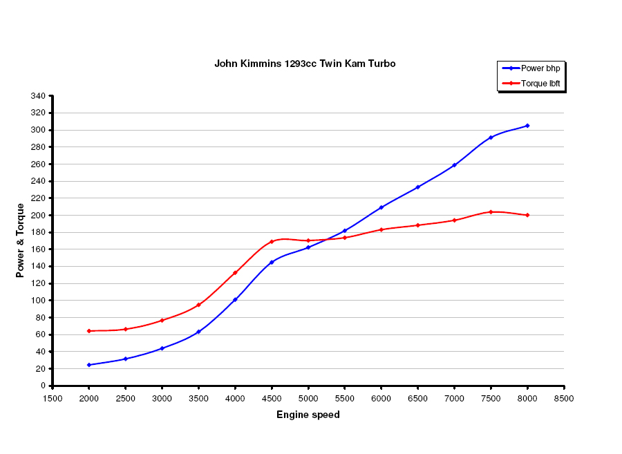

matts at nms rr day ,pk torque without wheelspin would be 270 to 280lbs/ft imo.
1275's at nms day ,mine on 16 psi.
mine using 21 psi at 5700 rpm ,17psi at 6500rpm.
jk's with a big turbo ,so missing the big trq number ,22 psi.
your car matt ,with a smaller turbo ,and the cams in as we set them ,would make a bucket more torque than johns below 5252 rpm ,so per pound of boost lbs/ft will be higher ,at lower rpm .
so i chose 350lbs/ft as a reasonable upper limit ,,bear in mind , gearboxes tend to go up in capacity relative to the distance between the two shafts ,the further apart they are the more power handling capability . while a 5x safety factor would be wonderfull ,realistically i'd say ,see what it will take ,expecting a tooth to go long before a bearing .
