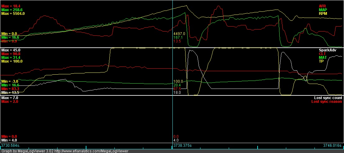

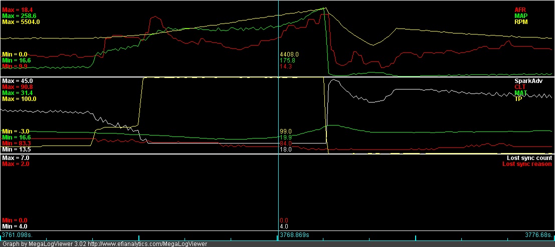

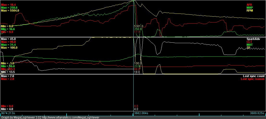

what do you guys make of this, engine runs beautifully but every now and again there is a misfire that is caused by ms loosing sync, never really managed to get decent logs of it but yesterday i got about 3 hours play time and have found these
i have tryed alot of things, but interestingly the rpm are very very close making me think it is possibly a vibration problem or some electrical noise

Reason 2 (as shown on your log) is usually a missing tooth error.
The other logs would seem to confirm it.
Many possibilities.
Vibration (moving gap) of the sensor quite possible.
Noise (at higher RPMs) also quite possible.
What about the VR pot positions - the standard VR input circuit really is crap - maybe just a small tweek of the pots, especially the lower one, would help clear it.
The VR voltage rises with RPM so maybe your gap is actually too small.
Also, double check the polarity of the VR sensor and your ignition input (rising/falling) setting.
Best I can think of at the moment.

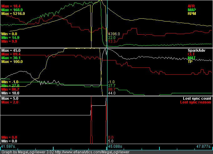

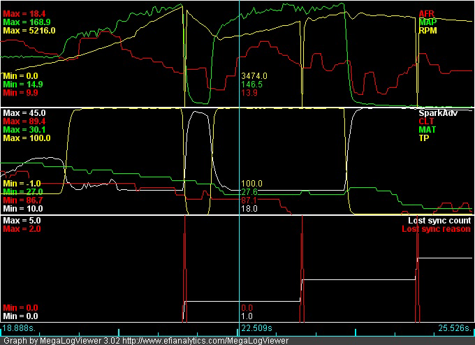

and the misfire at 4.5k is back so i spaced the sensor out another washer(~.5mm) more and it wouldnt start, i have adjusted the trim pots r52/r56
i can get a beautiful start but the misfire when running or pig to start and no misfire cant get that sweet spot in the middle
i cant get a log of the vr signal when its running,anyone know how/ if you can
have you paid for the full tunerstudio?
then under diagnostics select tooth logger and hit start.
