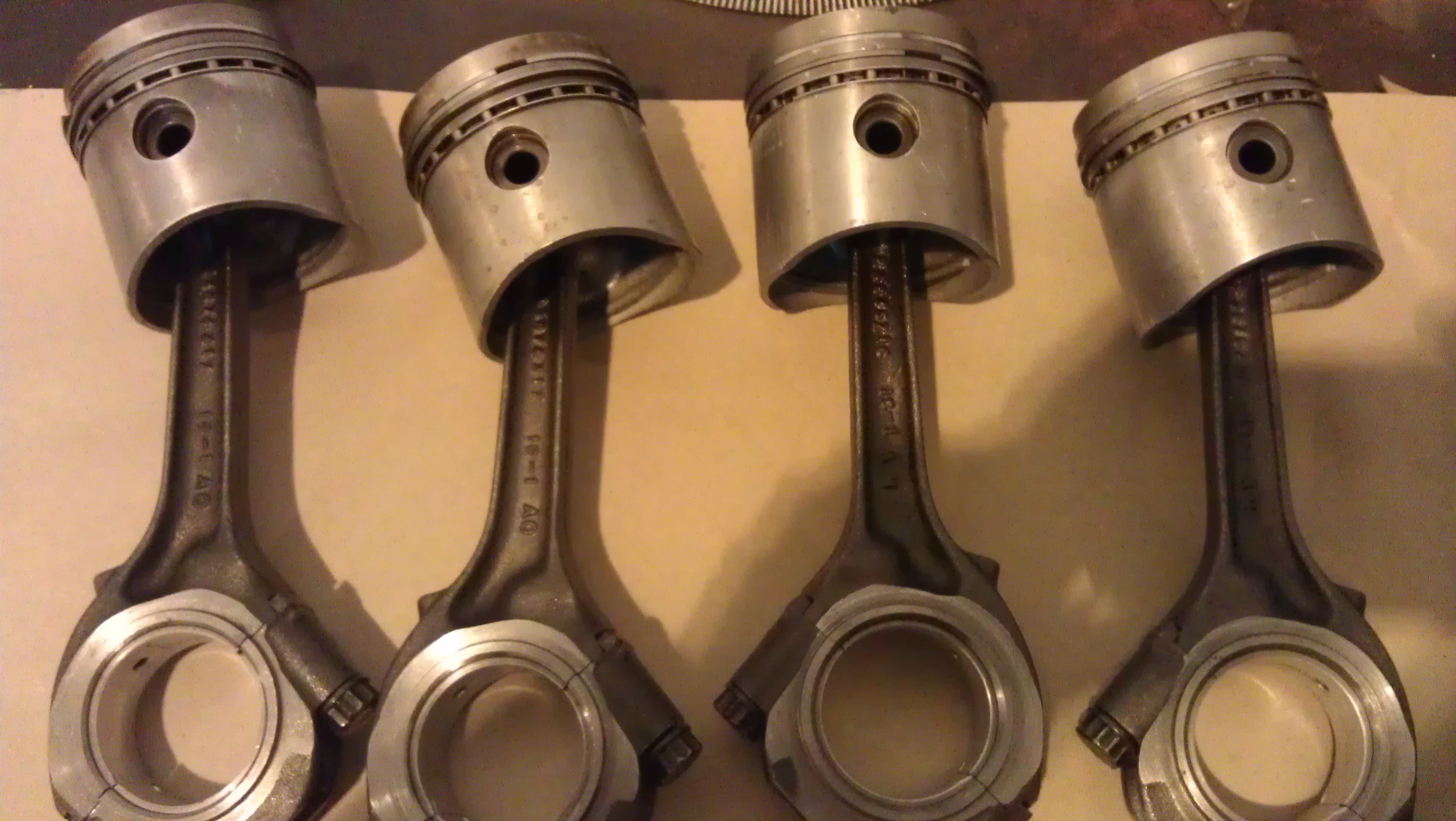

![]() 216 Posts Member #: 9845 Senior Member Staffordshire |
24th Apr, 2012 at 08:35:51am
The rods are 12g124. These are standard 998 rods I believe.
998 t2 ongoing project. |
24th Apr, 2012 at 08:42:06am
All 998s have offset pins (well all the ones I have).
24th Apr, 2012 at 09:05:44am
I just had a google and read up on it, the piston pin hole is slighty off centered.
24th Apr, 2012 at 09:27:54am
You'll need to rebore to fit either +0.040" or 0.060" 20773s. Saul Bellow - "A great deal of intelligence can be invested in ignorance when the need for illusion is deep."

Those pistons are most likely Powermax 20950s and would be better then the 20773s in a boosted application.
Edited by Paul S on 24th Apr, 2012. Saul Bellow - "A great deal of intelligence can be invested in ignorance when the need for illusion is deep."
25th Apr, 2012 at 09:12:35am
On 24th Apr, 2012 Paul S said:
Those pistons are most likely Powermax 20950s and would be better then the 20773s in a boosted application. You could get some +0.040" rings to fit, but it depends on the slot depth. Vizard lists the 20950 as having a 0.157" oil control ring, but the latest equivalent in my parts bin has a 0.125" oil slot. Have a measure of the slots. However, if you use the flat tops you still have the CR problem. Went down to the unit and measured the slots last night, weren't the best verniers but we measured the top ring as 1.73mm next 2mm and oil control ring as 4mm. The oil control ring would work out at 0.157" then. The guy whose helping me build said the rings that are already in should be fine as there hardly used, and the bore's are also fine. So i was thinking to bring the CR down i could possibly take some out of the pistons? and some out the chambers. 998 t2 ongoing project. |
25th Apr, 2012 at 09:24:57am
Top and second ring slots should be 1.6mm at most. Saul Bellow - "A great deal of intelligence can be invested in ignorance when the need for illusion is deep."
25th Apr, 2012 at 10:39:13am
Oh that throws a spanner in the works. I think im going to run these pistons and rings and get them machined to get the CR needed.
