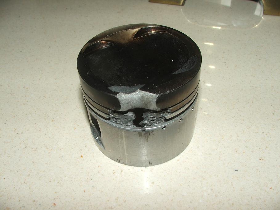

i thought it might be interesting to see where the A series pistons get melted most often.
your standing in front of the car ,and looking down on the piston top,
see the top of the piston as a clock face ...
12 o clock is the point nearest the scuttle/windsceen . 6 o'clock is the point nearest the grill .
pick a number !
i'll do another poll for what cylinder it is too .
regards

Nitrous meltdown. Melted spark plug electrodes probibly promoted pre ignition. Problem only evident on one cylinder which might be the symptom of something else.

2 o'clock for me, piston number 2 counting from the right.

No 4 piston, 3 o'clock position Robert. Have voted.
Rich.
great thanks rich .. on this one it appears across the pin seems to be the detonation area .
