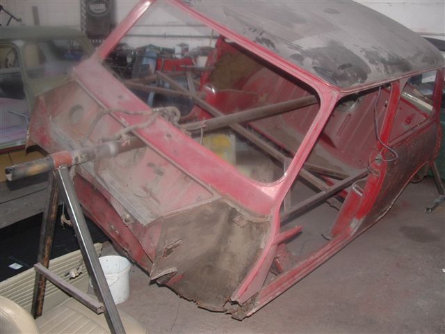

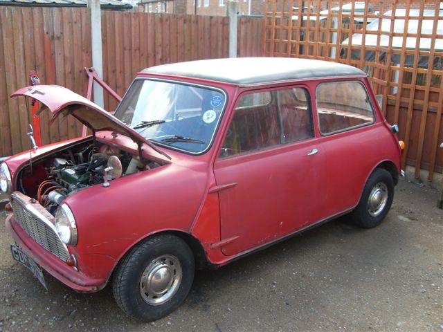

my mk1 before and after

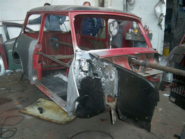

Thats a lot of work. Mk1s rule
looking good!
replacing full panels is a good idea where possible (as you are doing) word of advise though... put some door seals on it now and trial fit the doors if you haent already.

Most panels on the car were replaced as it was completely rotten and if i hadn't paid good money for it it would have been scrapped.
Panels were Boot floor complete with back seat, rear inner arches, rear valance, healboard, 1 full quarter, 1 quarter repair, floors front to back both sides with inner and outer sills and crossmember, door steps, wings, scuttle, inner fronts, inner front arches, front panel, both a panels inners and outers, 1 new heritage door, heritage bootlid, heritage bonnet. It did have a good roof and a,b,c posts though lol.
