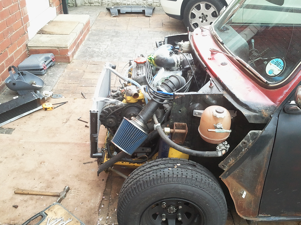

mine are from a ford ka you can just see them they go from the bulkhead behinds the rocker in this pic
