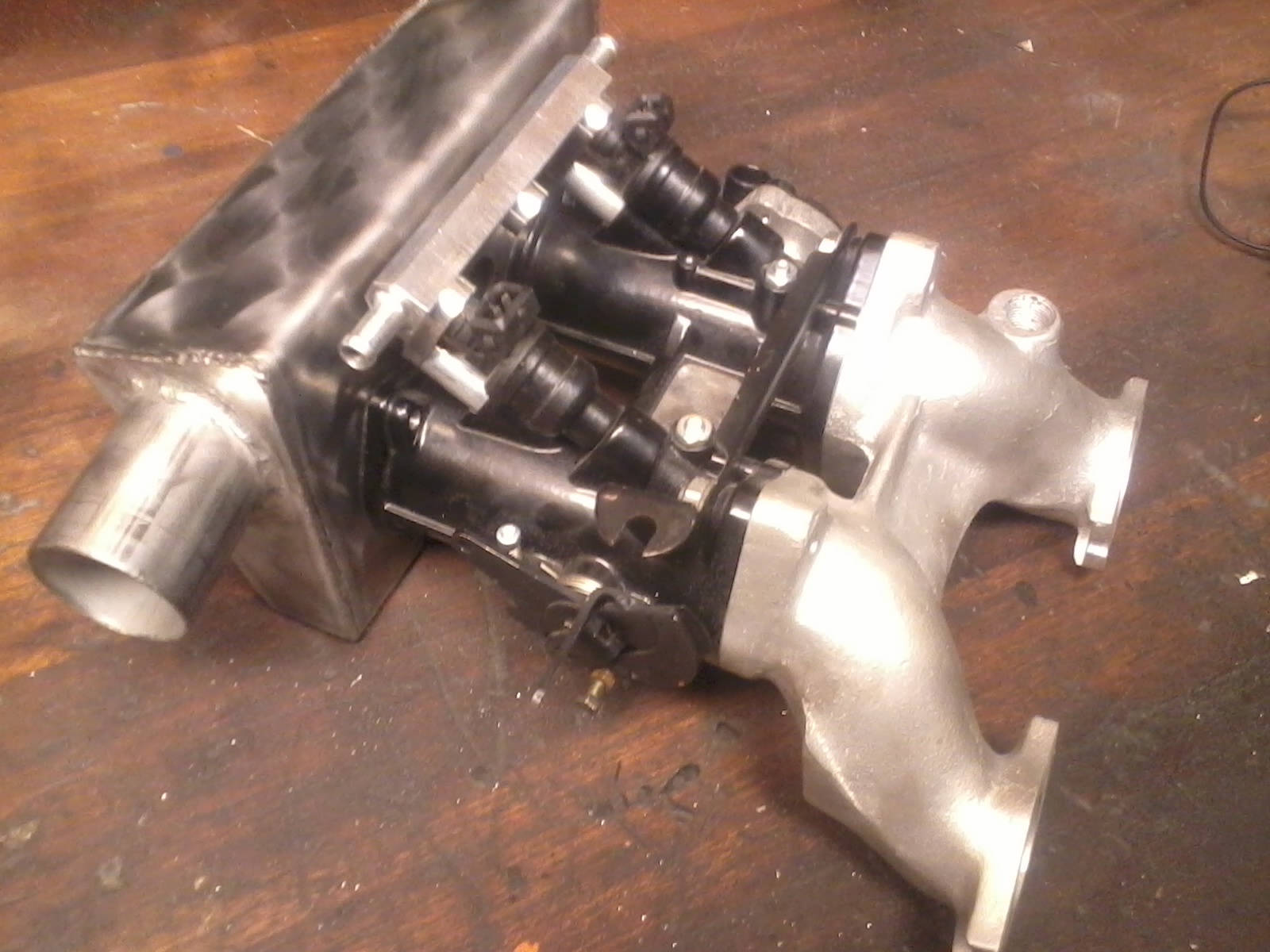

- KMS throttle bodies with 2x 1200cc injector in short weber inlet manifold

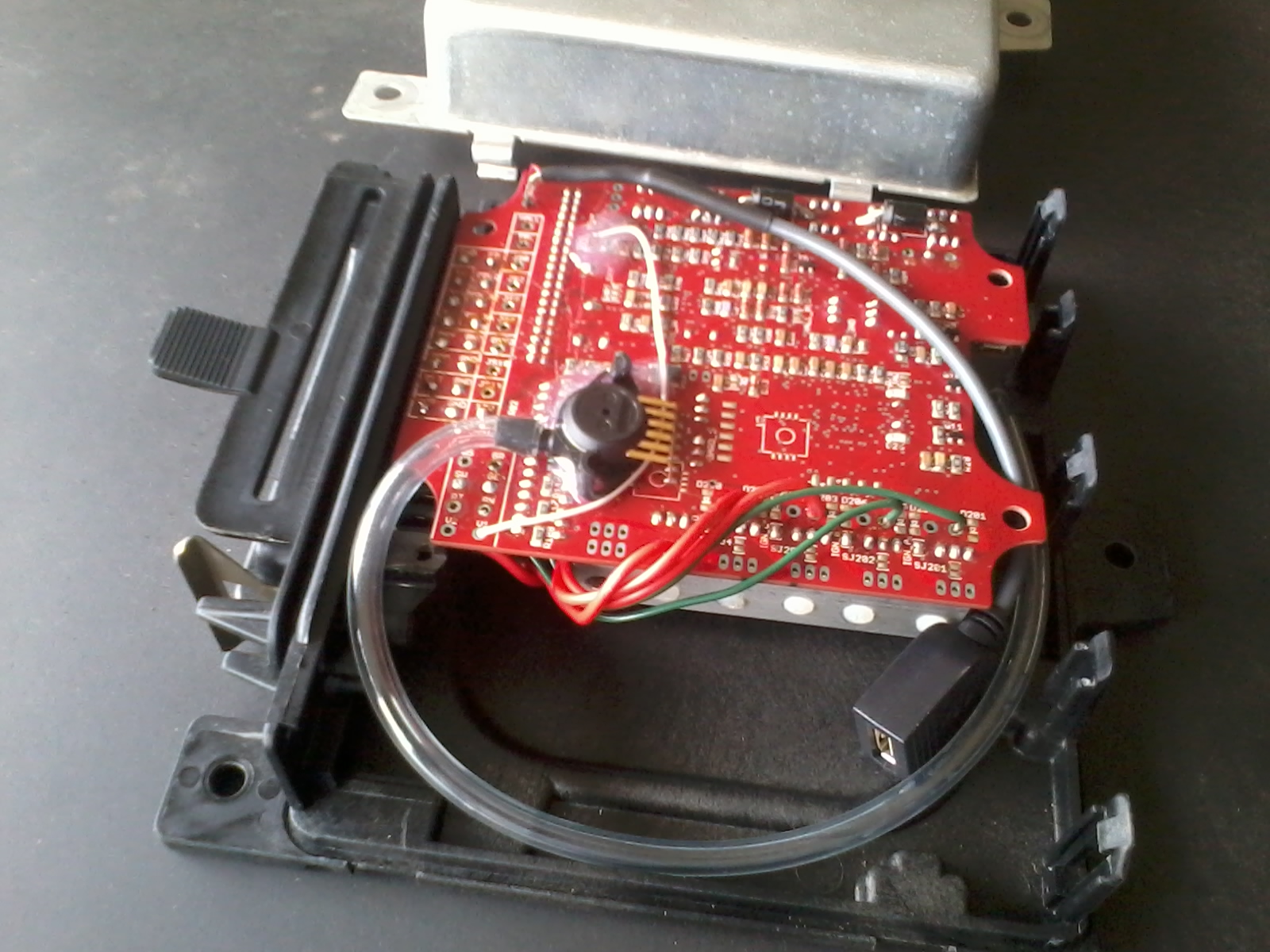

- KDFI ecu with siamese code

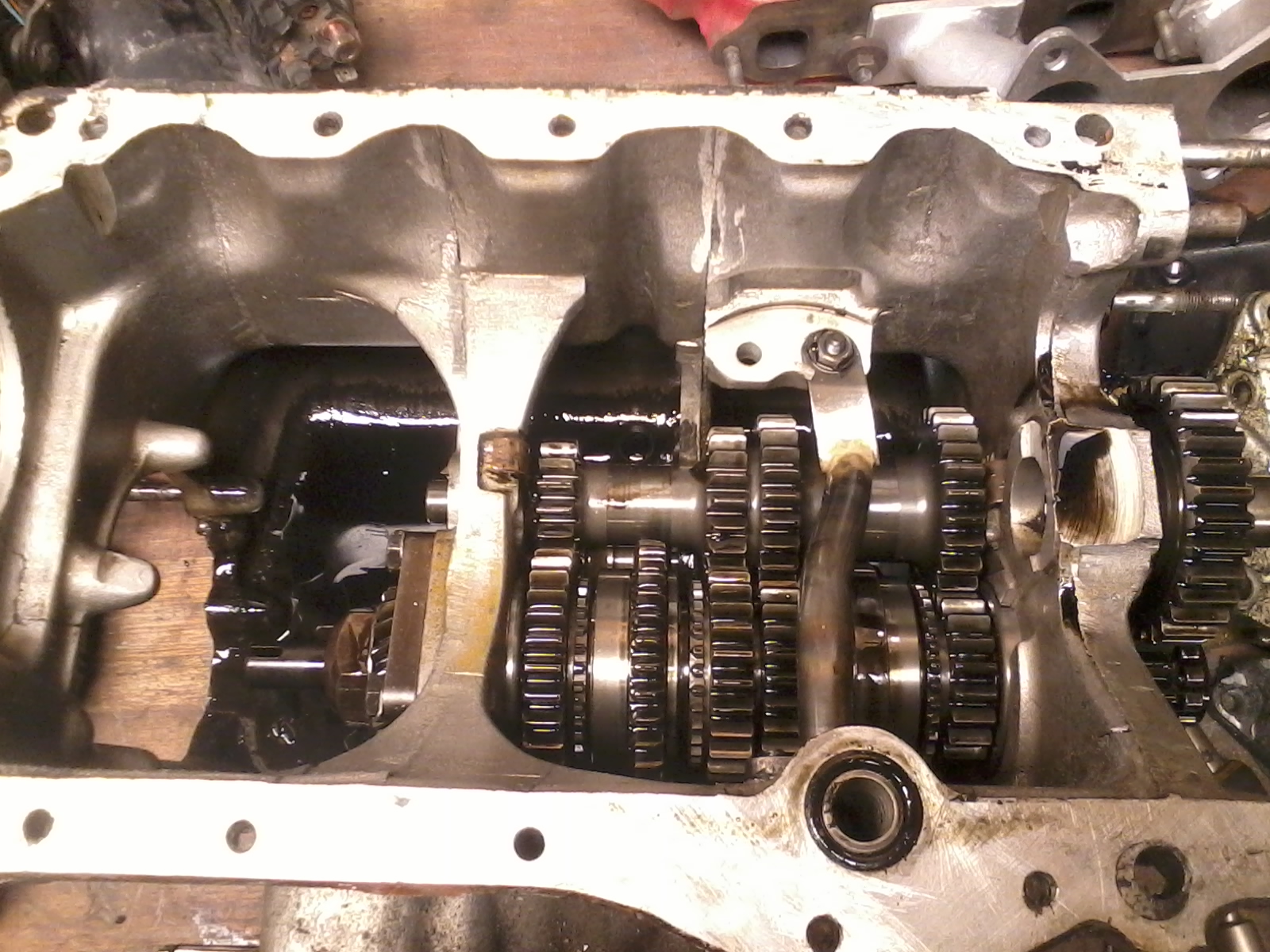

- Tran X SC/CR gearbox

I like that, especially the inlet manifold.

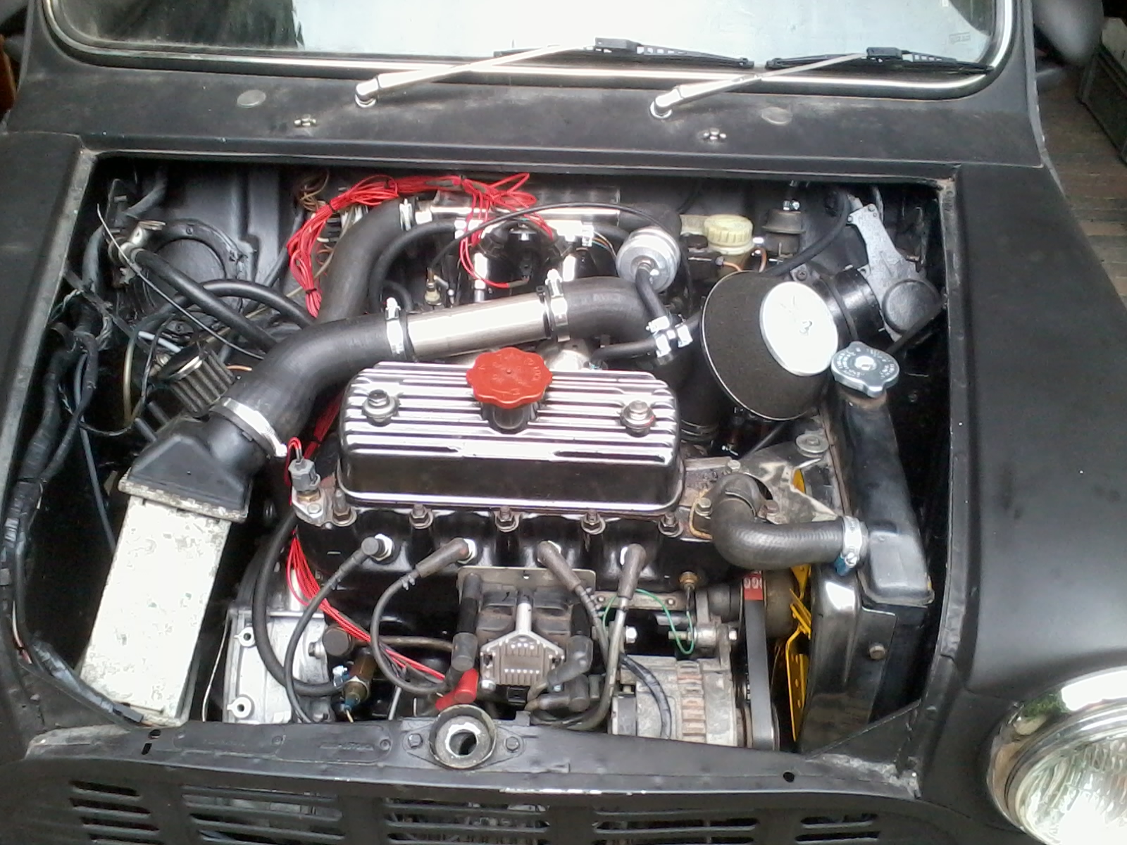

Is it sequential injection?
You could do with some ducting for the IC or moving it into the airflow to make the best of it.

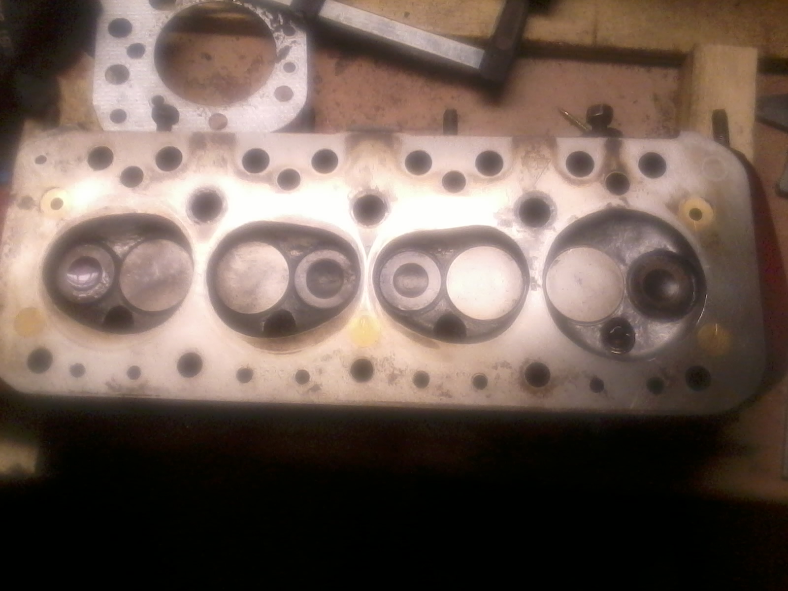

What's with the cylinder head? never seen one like that before
It's a very opend out 12G940, the chamber design has been discussed n TM on a number of occasions.

I thought it was very opened ill look in search

I agree wit Wil...get some good airflow to the IC and maybe try and move the intake to some cooler air out the front.
I like the inlet/throttle body setup.

Does forced induction overcome the problems normally associated with the swan neck manifold design?

It's sequential injection, the only way to do port injection on an a-series!
About the IC and airfilter: Bonnet is going to be a little open at the top, so there will be flowing some air trough the enginebay. Hope this will be enough...

I use a wideband lambda in the downpipe, so I use the average. In the future I will try to fit an extra lambda-sensor to find out if inner and outer are pretty the same, certainly before going to higher boost. For now I just check the colors of the plugs as I did in the past.... I know that's far from accurate!
As I use a weber-style throttle body it's not possible to use speed density as a single table. I use an alpha-n table (TPS) and from manifold pressure 70 I will sum that with a speed density table. I don't think the problem with megalogviewer is licence, but the fact that I use a combination of 2 ve tables.
