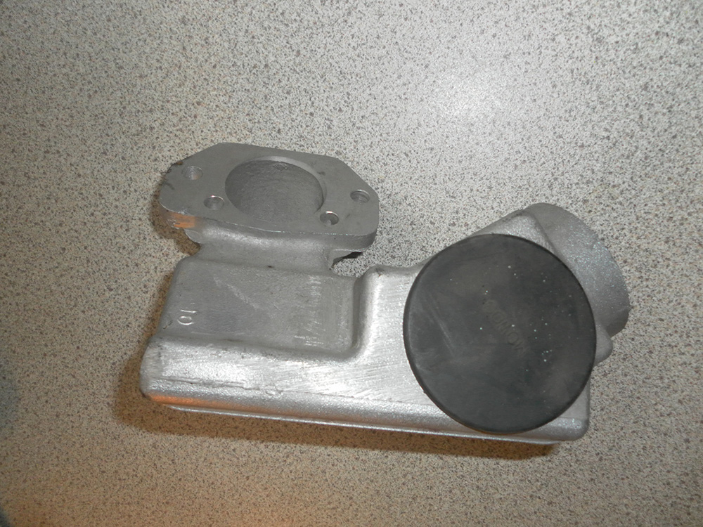

Guys,
I need some advice, somebody offered me a plenum, but I never saw this one before, can you help me out from which car it is and if it is usable for a Mini.
Rene

This is a plenum of a non-turbo Montego or Maestro. It's not suitable for use on a turbo engine as a direct replacement for the Metro type one.
It could be made to work, but it's lots of effort for no gain.

Basically, i did the mods that Wil talked about above but due to fuelling issues and hours of work trying this type of plenum to I eventually took this plenum off as it just wouldn't give me the right increase in pressure I needed in the float bowl to overcome lean-off, even with the necessary 37mm diameter restrictor plate between the carb and plenum.
It would work well on a Normally Aspirated engine but I wouldn't recommend this type of plenum for turbo use.
