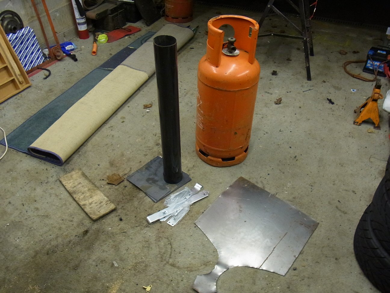

Started with this:

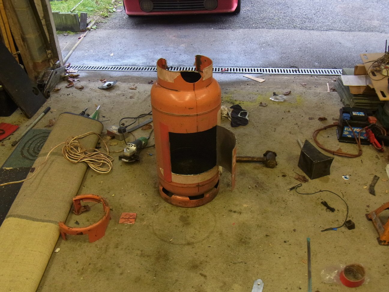

Then did some cutting:

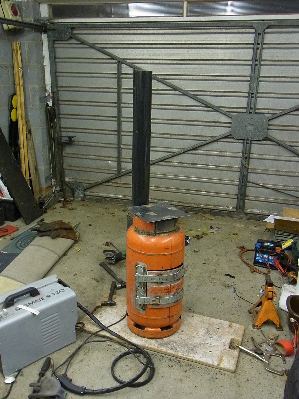

Then some shocking welding later:
The plate is so I can put a pan or griddle on it.

Looks good, Wil, but that welding is shocking. I might have to confiscate the welder when I am up this weekend.
I hope you have some good sipping Whiskey for a late one in the garden!
http://www.twin-turbo.co.uk
If it was on a car, I'd have stopped and asked the internet where I was going wrong, just not good enough, but for this I couldn't give a shit.

how did you get all the old gas out ,b4 you started cutting ,as ive got a 5ft gas cylinder im going to use for this purpose ,had the top valve open for ages but i can still smell stale gas ???
give em hell
unbolt the valve out and fill it with water.
mercenary62
641 Posts
Member #: 9937
cheers man will have a go tommorow
give em hell
My valve was stuck solid, so had to cut it off.
The smell is not necessarily gas. The smell is added and lingers longer than the gas. But yes, I filled it with water to expell any remaining before the first cut.
yep the smell is added so you can tell if theres a leak,
