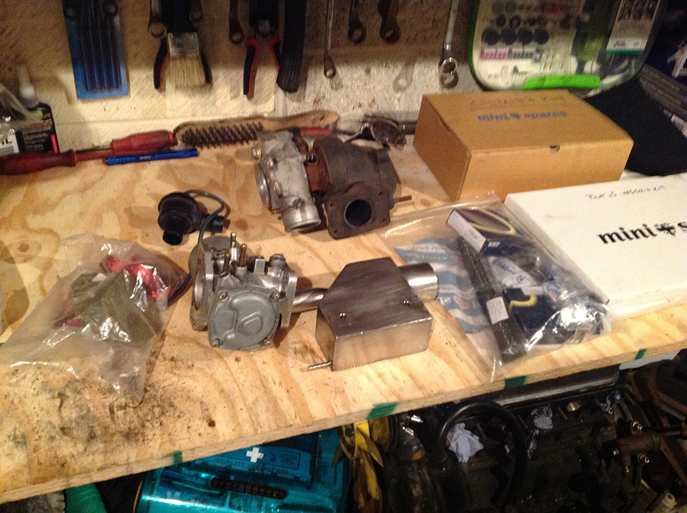

Just a little bit of progress guys, I now have quite a few bits in my possession, eg, turbo, carb, bosch dumpvalve, a full straight cut gear kit and a full rebuild kit for a gearbox.
hopefull this Sunday my old na engine will be out and gone and then I can get cracking solid mounting my front subframe and fitting my fuel return line,
Just a couple of questions the dump valve was off a saab 9000 will this be of any use to me or am I best to just go and buy a aftermarket one?
And will there be any need to buy an aftermarket actuator?

Looks good Jamie, nice clean car, With ref to your question, If it was me I'd Just use the one you have for now and see how it performs as it might be good enough.

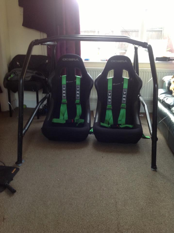

heres my new seats and cage.

i believe its a roll centre cage due to it having kicked doorbars, is it only roll centre that do this or is there others?

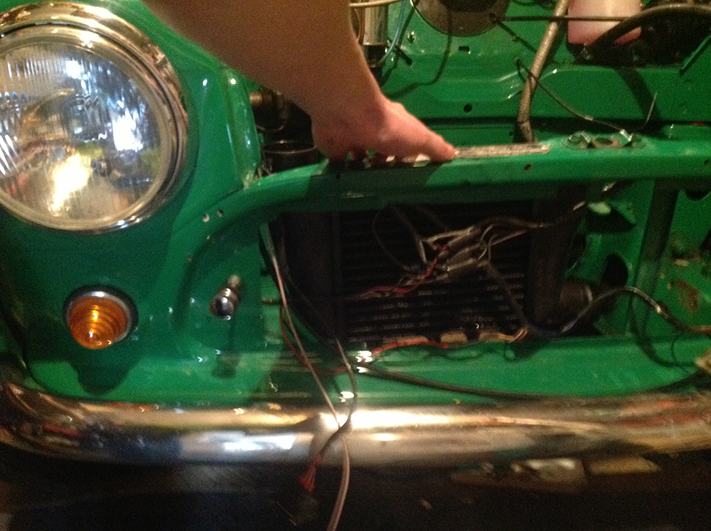

Here's a quick pic of the intercooler hope fully it should be able to be positioned exactly as it is then it should have optimism airflow, how close is a standard alternator to the support behind the grill out of interest?
