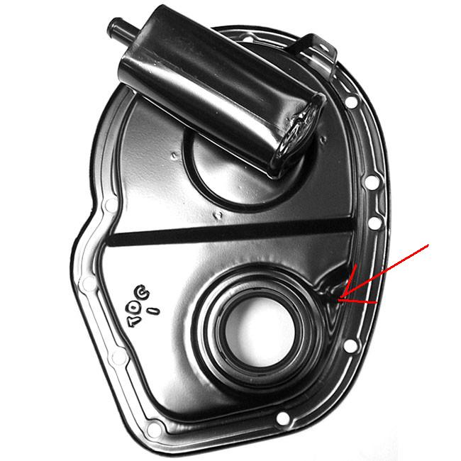

8th Feb, 2013 at 08:50:28am
Also - not being funny - but countersink the holes in the metal plate.

8th Feb, 2013 at 10:47:41am
thanks a lot guys the picture really helps, do I need to the same for the camshaft bolts |

8th Feb, 2013 at 11:43:12am
Thanks a lot Tom, Phil stated I need to remove the bump in the timing cover as well, does anyone have a pic of this, that I can visually see? |
![]() 6549 Posts Member #: 1149 #1 Basshunter Fan Force Racing ICT Dept Manager Miglia Turbo Am frum Yokshyer tha noes! |
8th Feb, 2013 at 11:46:14am
Bray this (from the inside) with a hammer so its flat

8th Feb, 2013 at 11:53:08am
Excellent that is great, thanks again for the advise guys |
