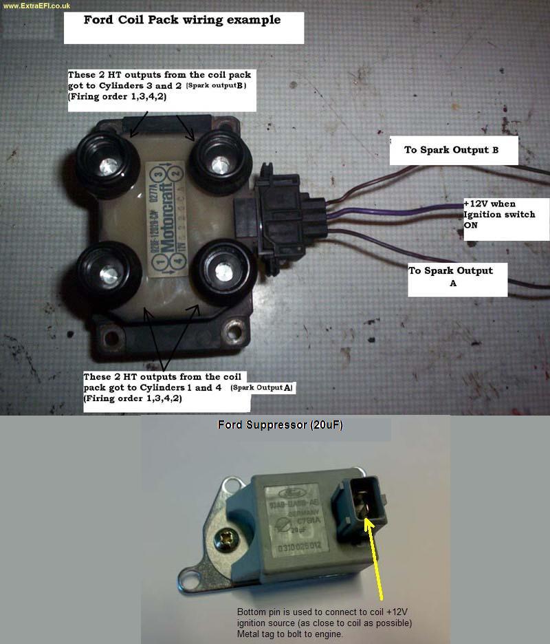

just started wiring loom for MJ today and was one of the questions i wanted to ask.
could someone confirm the picture below is correct for the coil pack connections.
spark output A to pin 10 on Edis4
spark output B to pin 12 on Edis4
sorry for the hi-jack
nala56
825 Posts
Member #: 9661
Sheffield South Yorkshire GB.
The top wire in your photo goes to pin12, middle wire goes to 12v suply, the bottom wire goes to pin 10.. Alan

lee.pb
1425 Posts
Member #: 9199
Lancashire
cheers alan, i suppose if you got it wrong you could just swap the pug leads over. *surprised*
