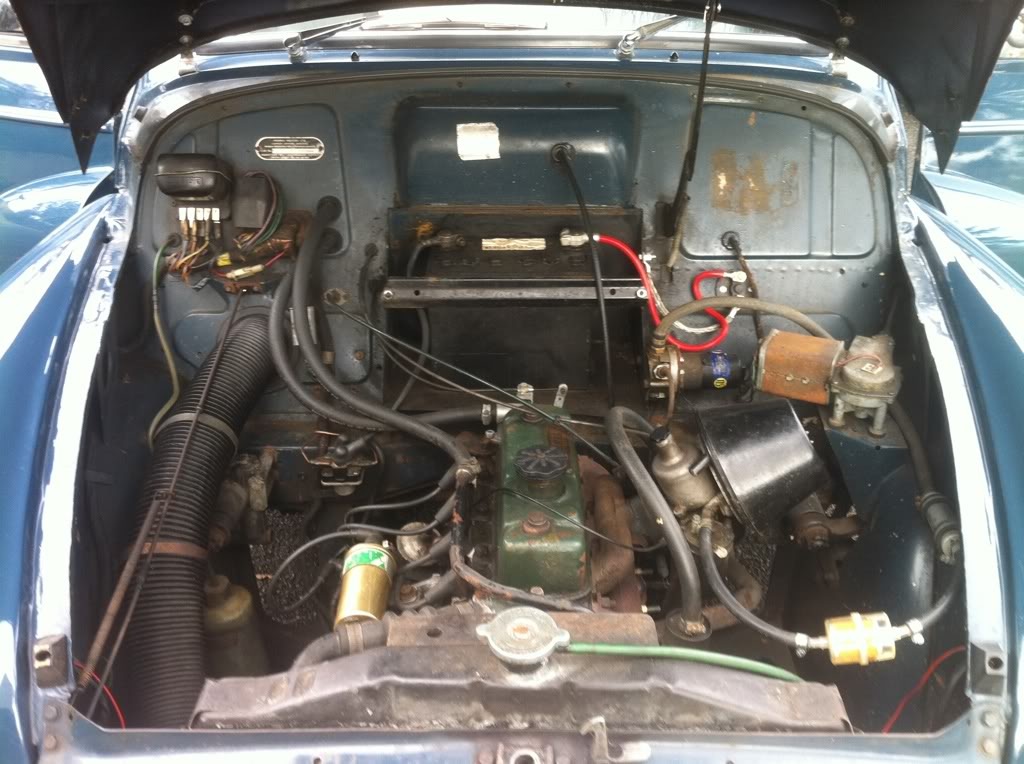

Can anyone think of anything different needed for a rwd engine or anything I can do to make all this easier with the added space in engine bay compared to minis? (Photo of bay attached)
