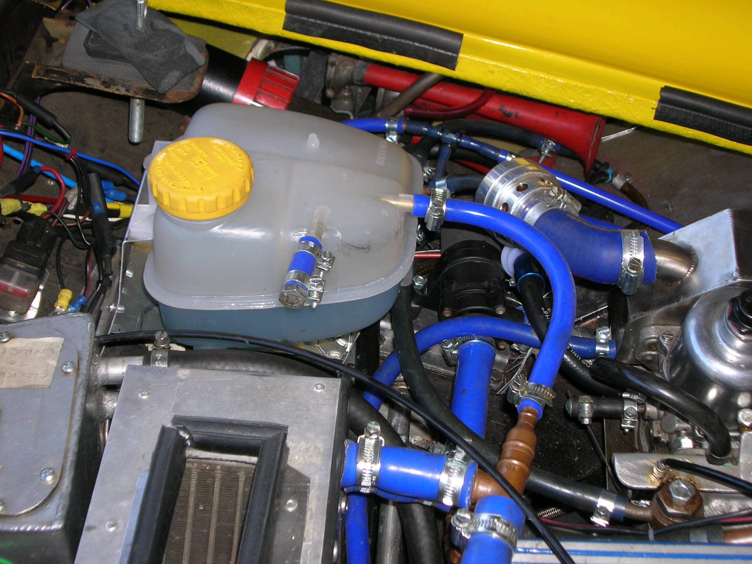

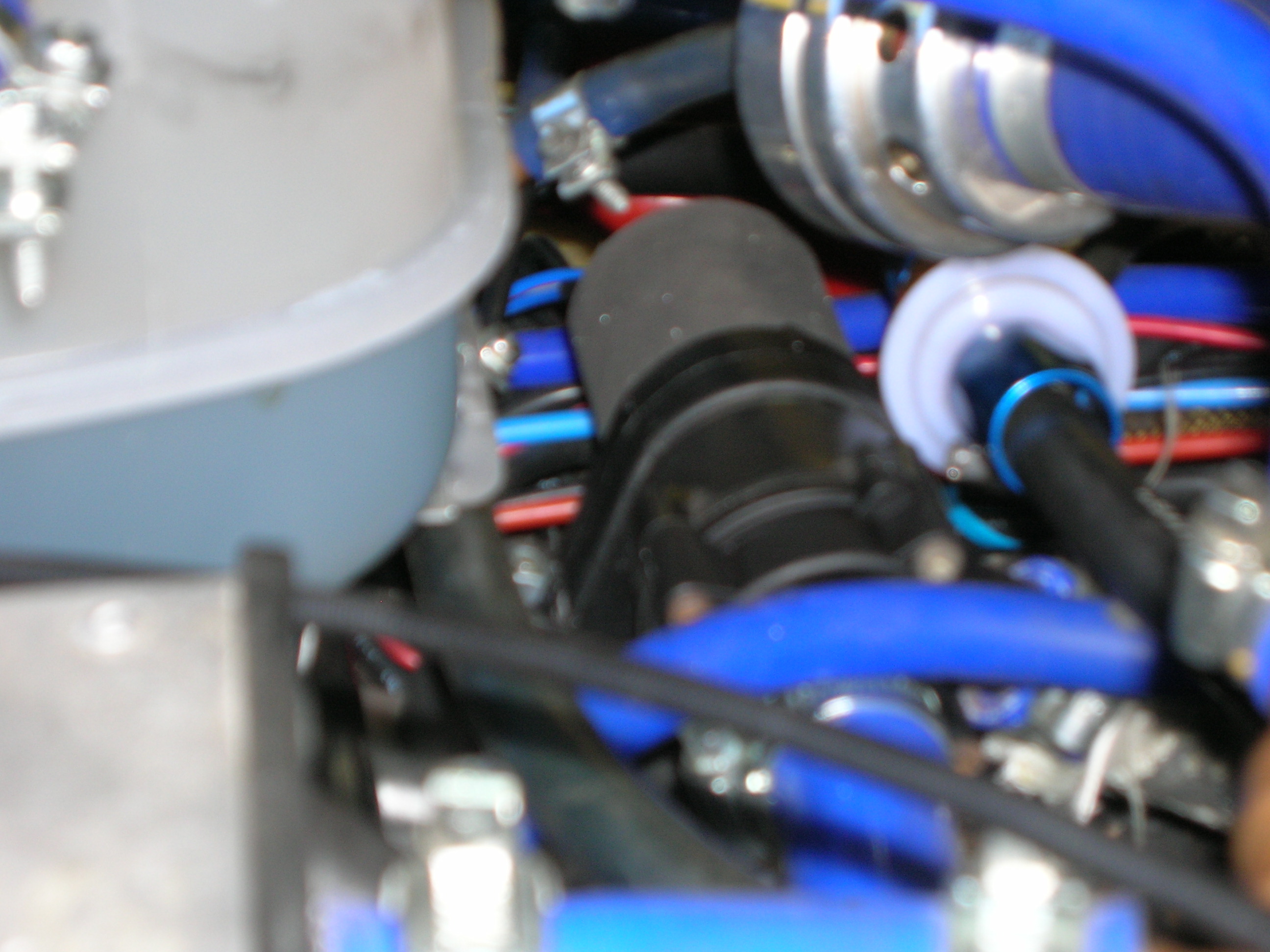

Bit of an update.Back together and retorqued head after 30 mins gentle running and 1 hour to let all the oil drain down.Most nuts moved about 1/8 turn up to 1/4 turn.Seems ok so far.Fitted an aux. water pump from a sprinter van between heater matrix out and turbo in.Also fitted it to a timer so I can run it on 10 mins after shut down.Tried this after a quick blast - the fan came on for a bit as usual,then the temp gauge climbed slowly until the fan came back on about 5 mins after shutdown,so seems to be working.Also modified the coolant cap with a weaker spring - now about 5-10 psi instead of 20.
