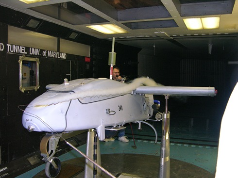

I will say it's amazing what time in the wind tunnel will show you... :) But then again what the hell do I know.

Tell us all about it then. We all know that the mini is a brick, but it has a very small frontal area. For this reason it performs better than you might think, comparitively.
However, before you comment on any design, what ever that might be you have to understand the requirements and the limitations. Especially in motorsport where regulations rule. What Jim did, above, is about as good as you can do in my opinion.
But I don't really know. I would be interested in how it could be done better, obviously.

As Ben said, 'what do you know'?
What I know is that time in the wind tunnel would be interesting, but I'd make no gains with what I can do withing the regs. This is quite well researched and documented for a mini.
I know blocking the air rather than allowing it to pass into the under bonnet area made a measurable difference to my car. This is to be expected from general theory of aero on a saloon car.
I'd be interested to know your thoughts on what would be better than the above, which will be difficult to prove either way I guess as this car and any proposed improvement will never have any data.
Having said that, as I said earlier, the above car no longer has the majority of this kit on.
