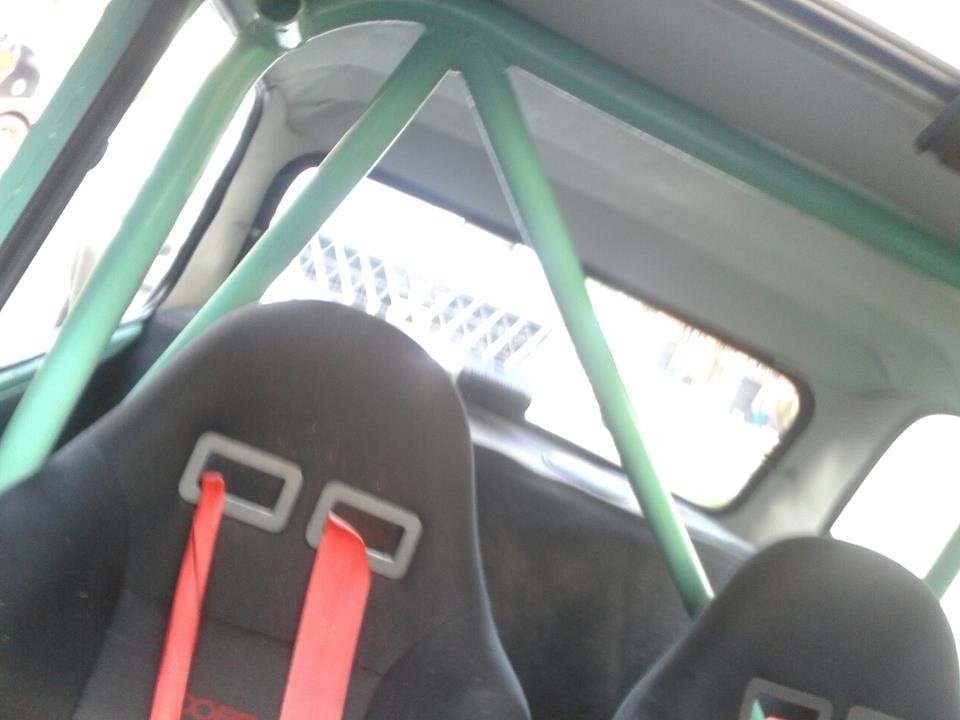

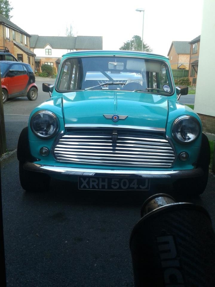

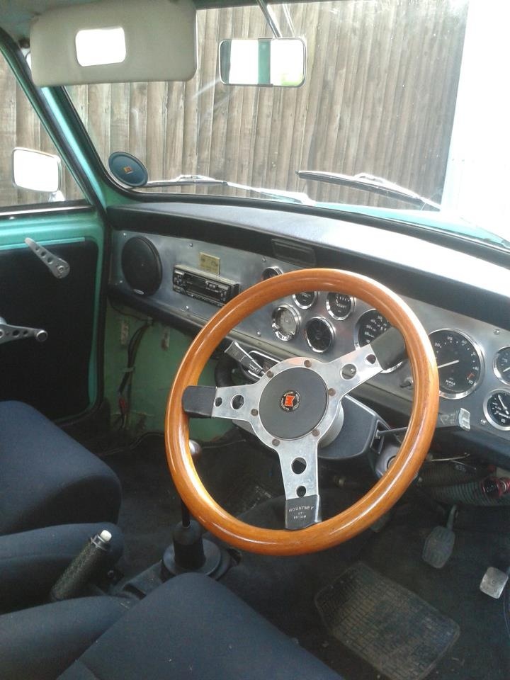

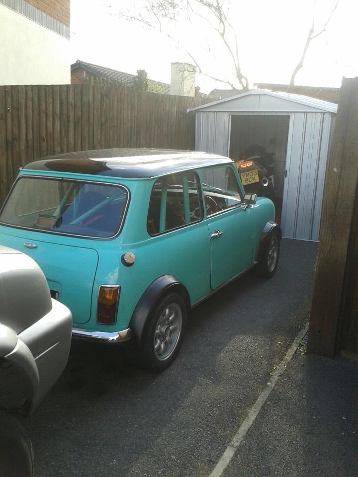

Here's the car I am talking about.
There is not enough detail in those pictures to justify buying a car from, engine bay shots needed
I dont like the deseaming you dont know if its been done well under the filler
That's a post 76 round nose shell - no drip rails. Ringer. Buyer beware.
Surface rust on pic also horible wireing
Rear window leaking signs in pic 3 had the same on muy old mini.

I quite like the colour

Wouldn't get too precious about it being reshelled. Just value it accordingly as its not a GT. Minis have been reshelled since the early sixties and nobody ever minded.
If the engine is in the boot and and it's all completely solid, I'd personally pay £1200 ABSOLUTE MAX for that.
I would have agreed if it had been reshelled with a clubby front, the danger here is if it gets stopped and the police or vosa know minis and know it should have a clubby front its going to be very hard to prove its not a ringer and in that case the car will be removed to an impound and possibly scrapped

could have been welded on as a roundnose
but most likely stuck on for the tax free status
especially as pointed out, its a later shell!
Edited by WRLondon on 30th May, 2013.
Reading up on RTS Clutches
I personally think a reshelled mini is no issue. But this is not a reshelled mini. It's one mini with a different logbook.
The fact that it is neither the correct age or shape is a big give away. this has been done to get free road tax, no other reason.
It would be worth more in my eyes on the original V5.
