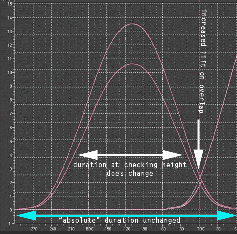

I would suggest first doing some reading about ''normal'' cams, that is quite complicated to start with. A turbo cam could be quite like a normal NA cam(for a very optimised modern design with low back pressure ) or more like the often advocated short(ish) duration & low overlap and wide LCA .
a simple google search for ''camshaft theory'' will keep you reading for a few hours.
As for the rocker ratio's. If you change the ratio you change quite a bit of variables on a cam.
It makes it ''longer'' , at least sort off..not if you define the duration at 0.000000001 micron lift which would be the ''true'' cam duration starting at the first inkling of a opening ramp.
but it will if you measure it at say 2mm or at 0.050'
so you basically stretch the curve upward while keeping the duration including ramps the same .
I made this illustration .. probably more insightful.
It also increases lift on overlap which might be good in some cases , but if you have high back-pressure it could well be rather bad.
