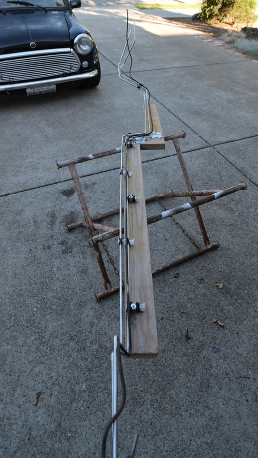

I am adding 5/16 fuel and return lines to a MK 1 Traveller. It is left hand drive so it may not be standard for most people on this forum.
I am looking for pictures of how the lines route past the rack. On my car the pinion is on that side. I did not take a picture of where the original line routed but it looks like it comes up on the inside of the pinion

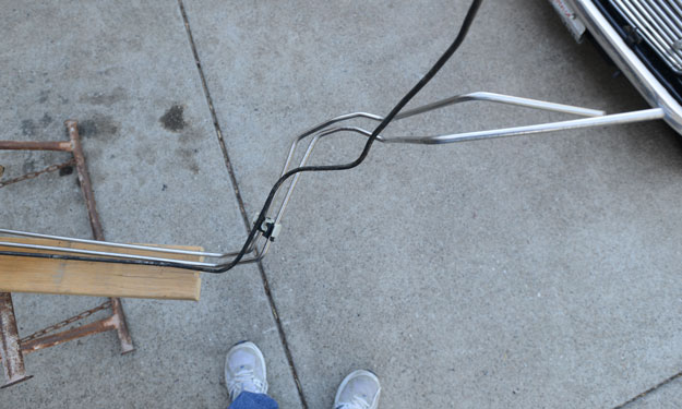

I wll post a picture of the the current mess I have made. I am attempting to use stainless which requires a little finess in bending. Unfortuantely it is finesse I do not posess.
So for now I am just looking for photos showing hoe other people have done it.
Terry

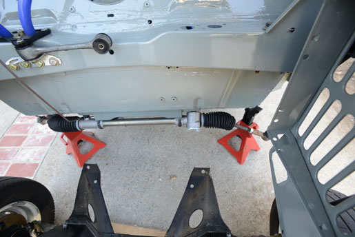

Best photo I've got mate hope it helps. Alan.

Have you thought about using aluminium hardline instead? It will be 10 times easier to bend and work with? Though i suppose it depends on what fittings you are using.
tmsmini
186 Posts
Member #: 7637
Fremont California
I did think of or am thinking of aluminum or plain steel as well. My tube bending skills are not up to using stainless.
I made a jig to help me with the bends on the long run and I thought I could pass the two lines by the pinion on the outside, but I failed. I mesured and checked many times, but in the end, it is not working

I used copper, microbore central heating tube, 8mm and 10mm.
Same route as the original, just two next to each other.
Because it is a common plumbing material there are proper bending/forming tools readily available to get the tight bends to match the original.
I tried the semi-rigid nylon first (as Andy says, because it's what modern cars use) but couldn't get tight radius bends without it kinking (even with warming it first).
Only got photos of the back but it's behind the steering rack at the front.
Also, if you screw a bit up, just cut/join using solder fittings (like it would be on central heating) which take up no space at all unlike compression fittings.
I did initially put my lines above the rear frame, but wasn't confident with the fittings I used. In the end I ran them below the subframe in one length front to back with some nice sweeping bends. Don't forget heat wrap stuff where you pass close to the exhaust.
Found a picture of the front (it was in my "bodywork" directory instead of the ""fuel lines" directory...)
The grey stuff is heat shrink sleeving which I put over it in any location where vibration might cause it to touch anything and also at every clip location as steel touching copper and salt water isn't a good mix (I used the original steel clips). The earlier photo was a trial fit, the heat shrink went on later.
EDIT - although it's a RHD rack mounting plate, you can see the place where the LHD hole would be and they would clear it, just like the brake pipe clears the RHD pinion shaft.
