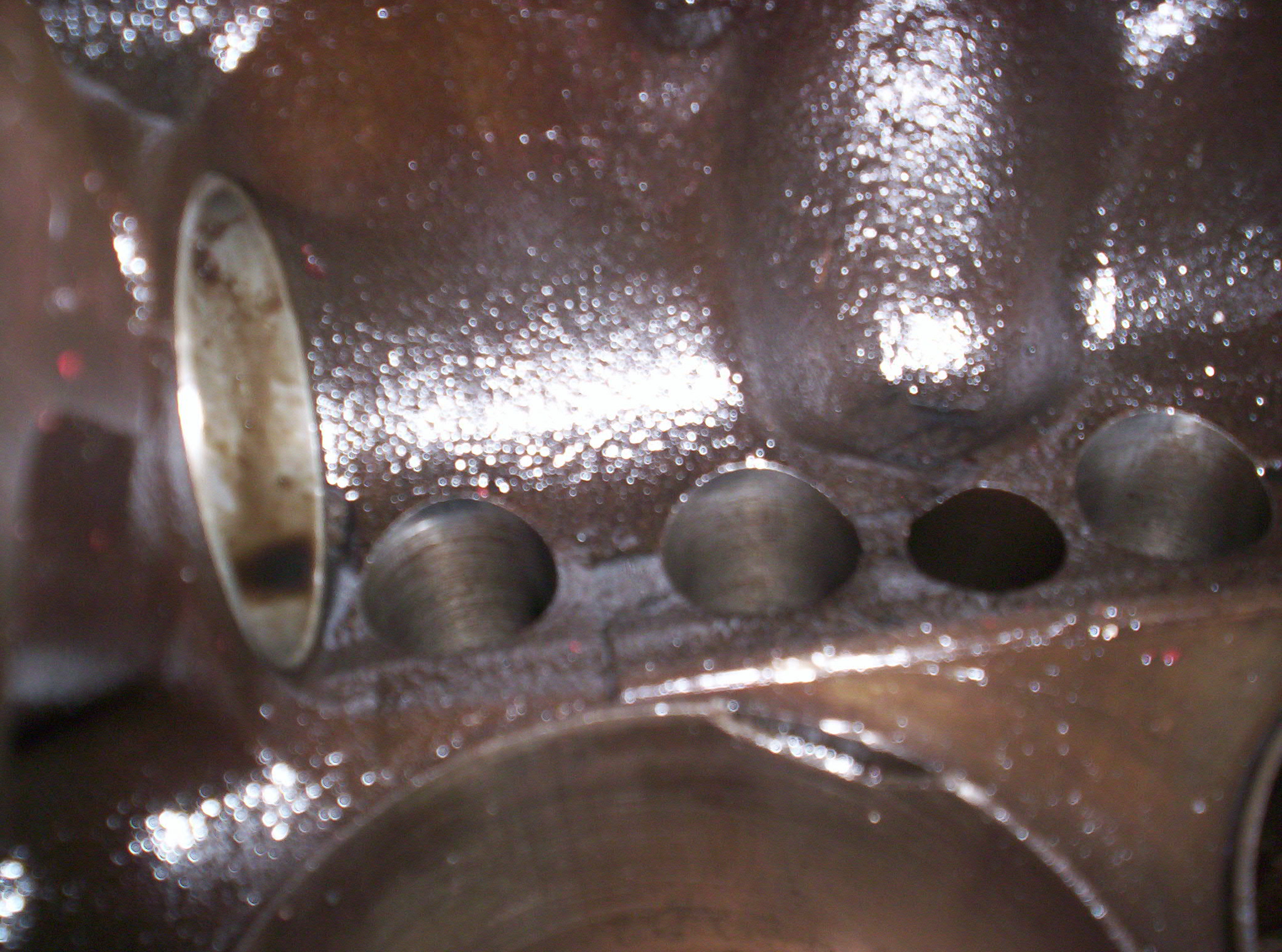

Been rebuilding one of my turbo lumps and waiting 4 my new camshaft so thats as far I can get with that one but ive decided to rebuild another to sell how ever on close inspection I think the block has been resleved and there is a large chunk missing from the bottom of one bore has anybody seen this before? If so is it a problem would I need to get it resleved or would it be ok if the piston dosnt go to the bottom of the bore never seen this before so best ask before I start |

Large chunk 4mm or Large chunk 40mm???

Sorry ill add a picture of it give me 5 mins and be4 I get another spank on the ass ive tryed the search |

picture as promised so any help would be much appreciated |

chip |

I'd deburr that, and use it. On 13th Jul, 2012 Ben H said:

so would it still be ok with omegas in ? |
9th Jul, 2013 at 09:42:49pm
I'd use that too, with a bit of deburage...
9th Jul, 2013 at 09:47:13pm
On 9th Jul, 2013 kezzboycat said:
so would it still be ok with omegas in ? YES as the gents say with deburing, the omega skirts wont come near it on std stroke crank

ok thanks all and yes its a standard stroke well at least it good news saved me some money :) :) :) :) |

The block needs to be honed anyway, that will remove the burrs. On 13th Jul, 2012 Ben H said:

ok thanks its going to a machine shop soon anyway
