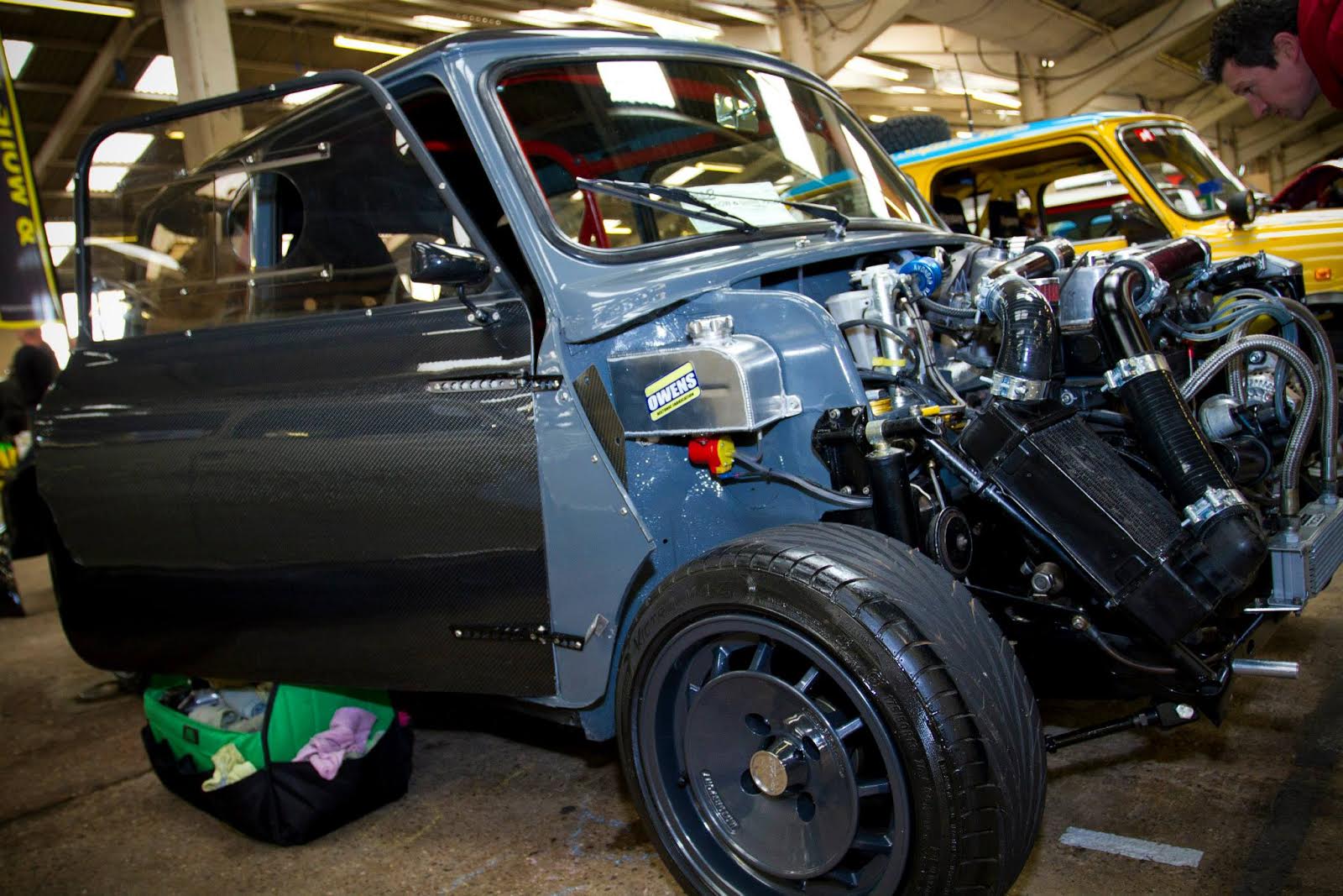

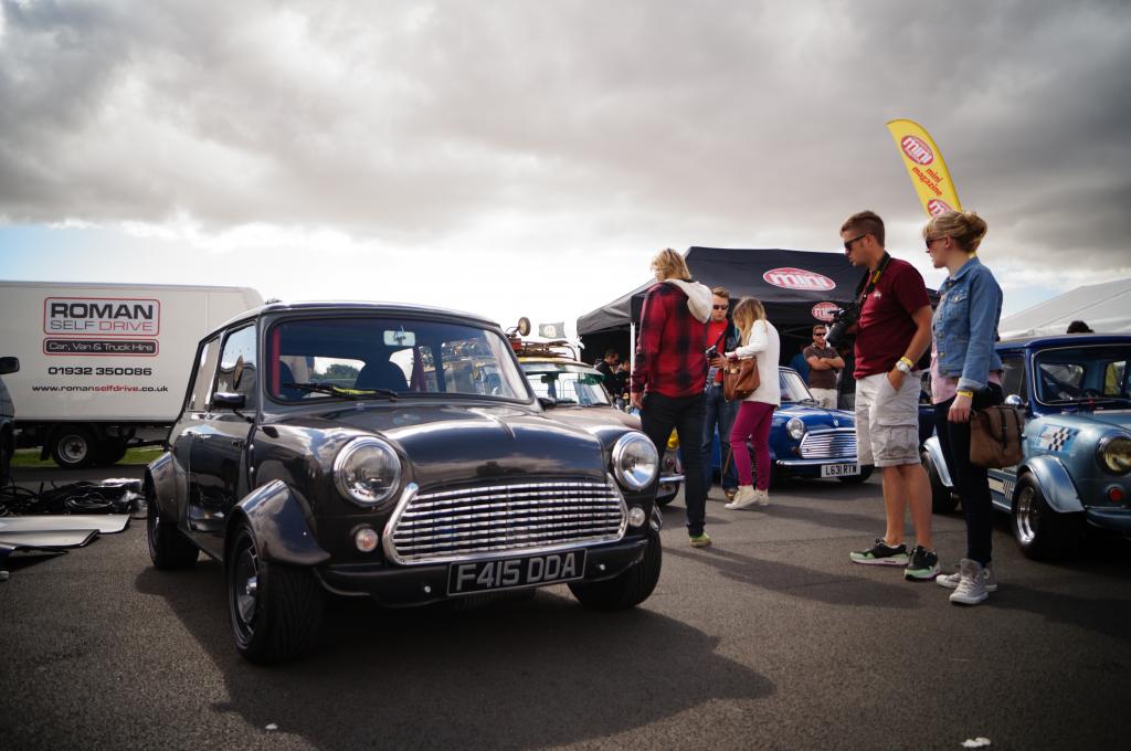

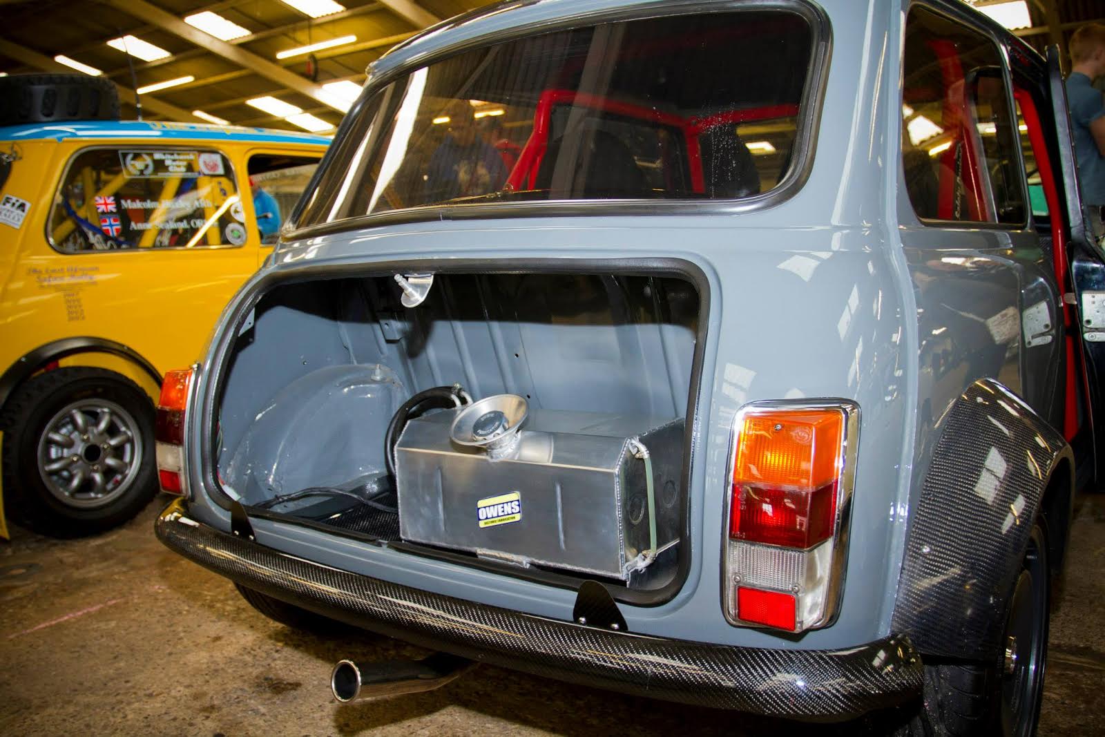

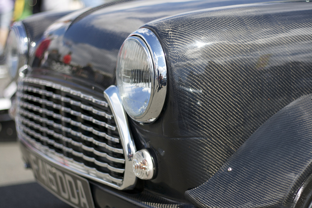

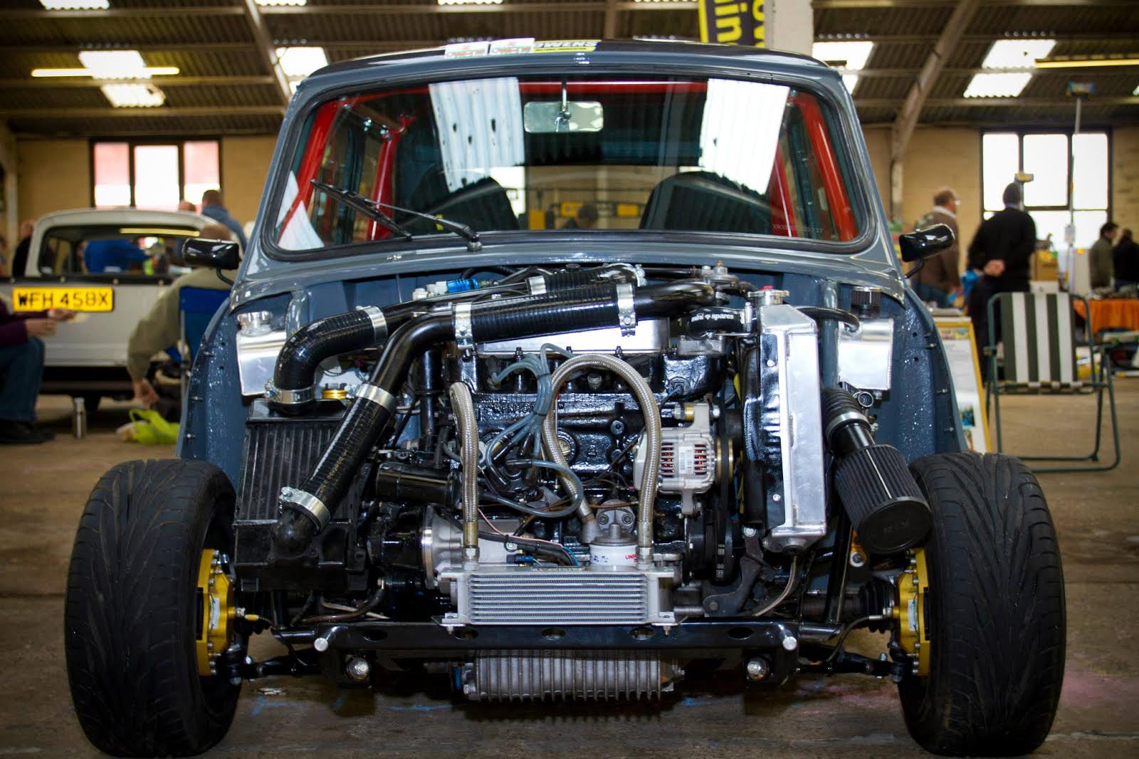

Hi guys, still quite new too the forum, just a few pictures of my turbo mini
Cheers lee.

Seriously smart mate!
Love the wheels
How did you make the inner wings like that? Bent tube?
Does the air filter not take a beating there?
I like it :)

thanks mate! yeah bent a tube, haven't had any problems so far, cheers lee

nice looking setup. any chance of a few photos showing how you route'd the air intake from the rad area to the turbo?
nice custom wiring loom *wink*

nice, whats the engine spec?

1293 morepseed engine, omega pistons,modified t3 turbo,hardened and balanced crankshaft, avon bar actuator,med 4 core radiator,stage 5 super squish head, fiesta rs turbo intercooler,quaife straight cut dog box probably forgot a lot, cheers lee.

I like that washer bottle

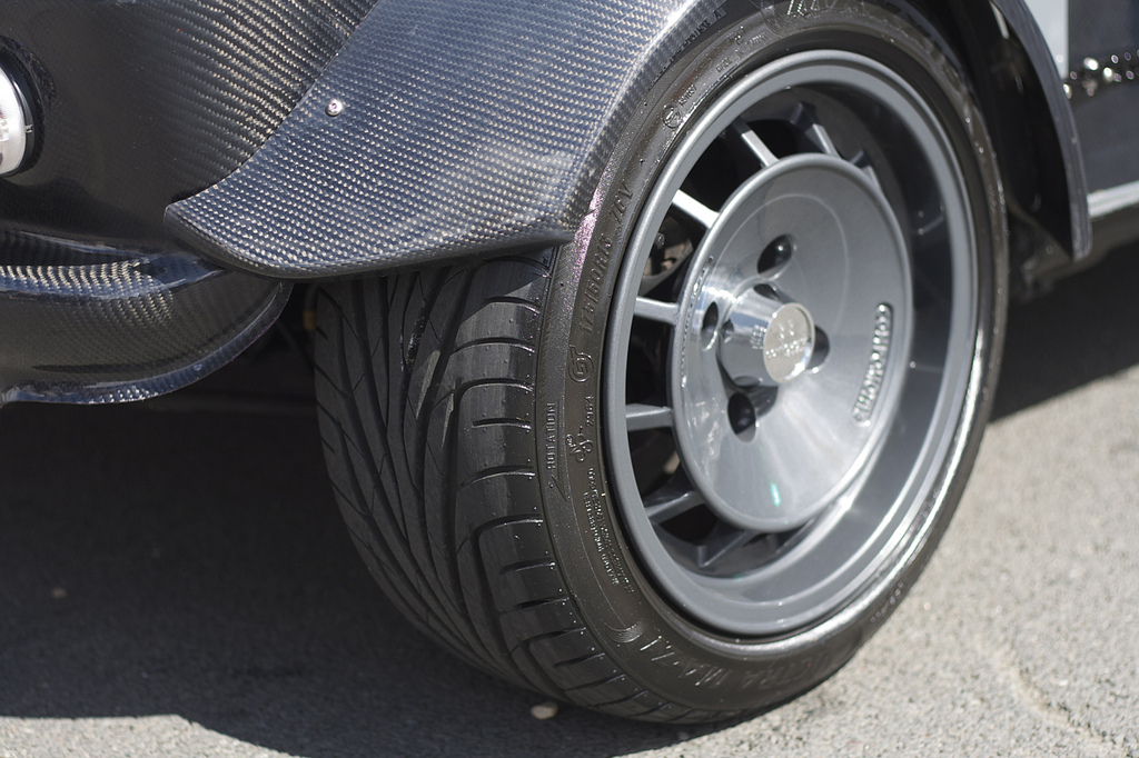

Nice wheels

Love the wheels!

nice doors and hinges whats their weight?

Thanks ladz! Unsure on exact weight but way lighter than steel ones.

look like force racing items :)

nice looking mini as many have alreay said, do like the OZ motorsport wheels.

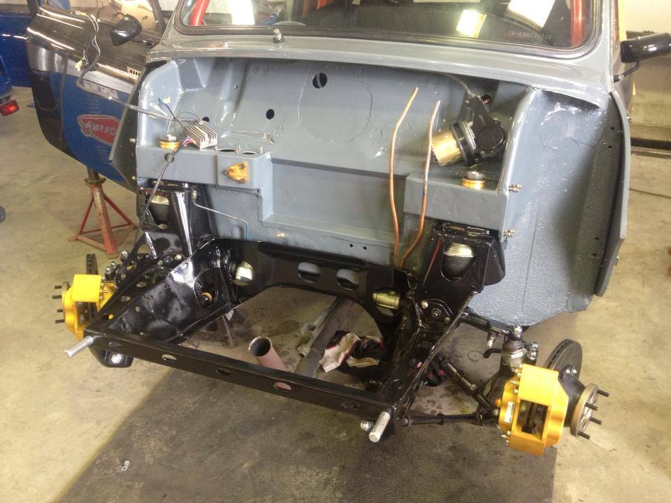

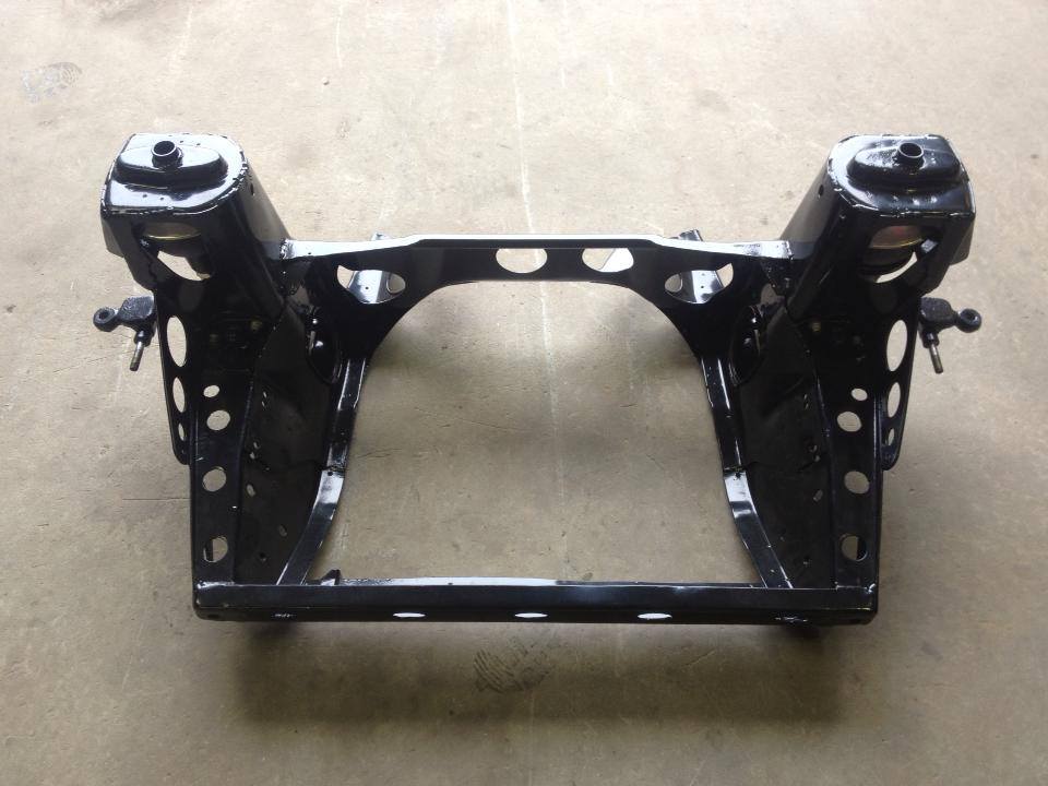

a few pics of my new miglia spec subframe.
