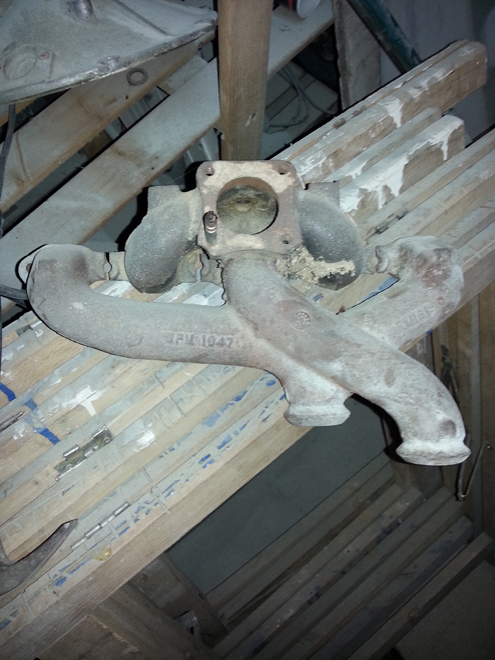

Does anyone know what inlet wfn 1047 is? Has a second cast number rmi81
It has 2 down pipes and inlet peace is only attached in the midle. Has a Leyland stamp on it vacuum brake conection on top. Is it from a 1000 or 1275 engine? Anny good as oldschool performance part?

just from the description it sounds like the "none performance" 1300 metro manifold

Looks like a standard Metro or Ital 1.3 combined inlet and exhaust manifold
Yeah that's a metro manifold

Yes I did - the A35 ran and ITAL manifold like that when it was N/A and I still have it.
Its not so bad because with the right pipes you have an effective LCB.

The exhaust part of this manifold is kinda worth getting.

yeah had a bit of a thought like that. just cut the inlet and get a aluminum one on it to avoid heat transfer. but then hey... what is a manifold costing these days.

The exhaust manifold is actually rather a nice bit of kit.
Flows very well (as pretty much all Leyland exhaust manifolds do) withe gains of an LCB, but the extra advantage of be massively quieter than a tubular LCB and easier to live with as you don't have to dismantle it to remove it.

hi. i was looking around the shed for engine parts to mach the 1100 engine that i would fit into the mk1 traveler. al original inlets that i have are for su 4 carbs. now i dont like su so much so would like to mount a hif 38 to it. the only original inlet i have is this one.
would it mach the 1100 or would it be overkill? and if yes what exhaust am i looking for? i would weld a original exhaust to it to give it the standard look and to make as quit as possible ( the wife demands it)

Works fine on an 1100 with an HIF38 - you may find that you have bulkhead clearance issues though.

Okey. So have asked around. Now i got some things offered either i use the twin inlet and weld an original exhaust to it or i use a single inlet where i can put a standard exhaust to without welding. How ever the twin fits my 1100 head the single one commes from a 1300 so not sure...
What would be the best option?

so i got offered a matching downpipe for the inlet here above. i would or use this downpipe and weld an original exhaust on to that downpipe or i also have found a inlet that has a single downpipe but that one came from a 1300 while the exhaust i have is one from a 998... so what would be the best thing to go for?
grts
Probably the metro item, it's closer in design to an lcb etc
