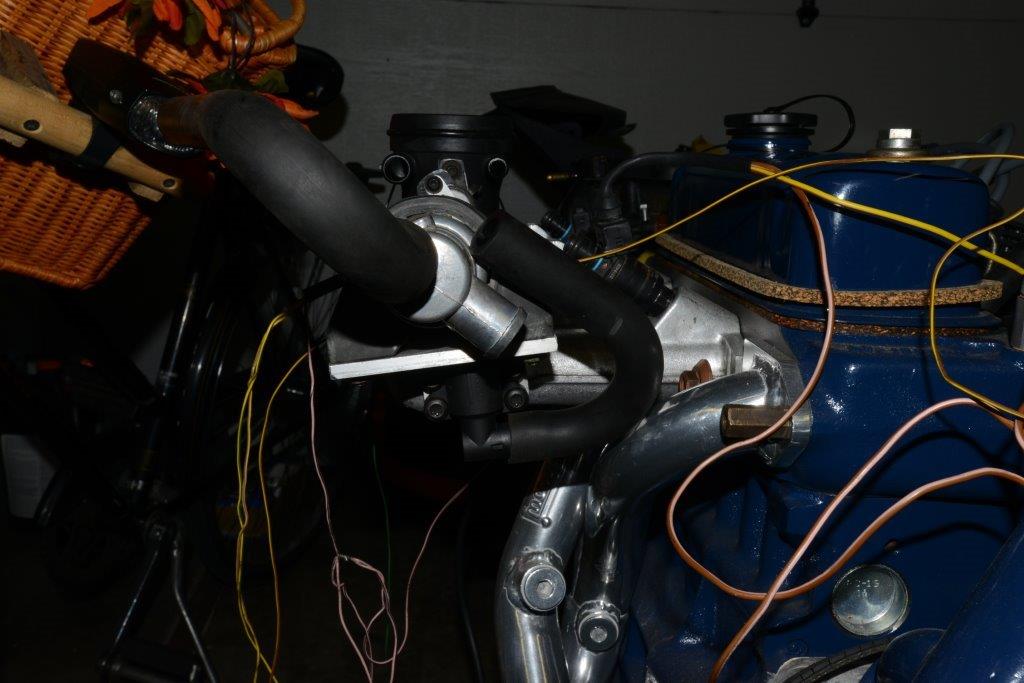

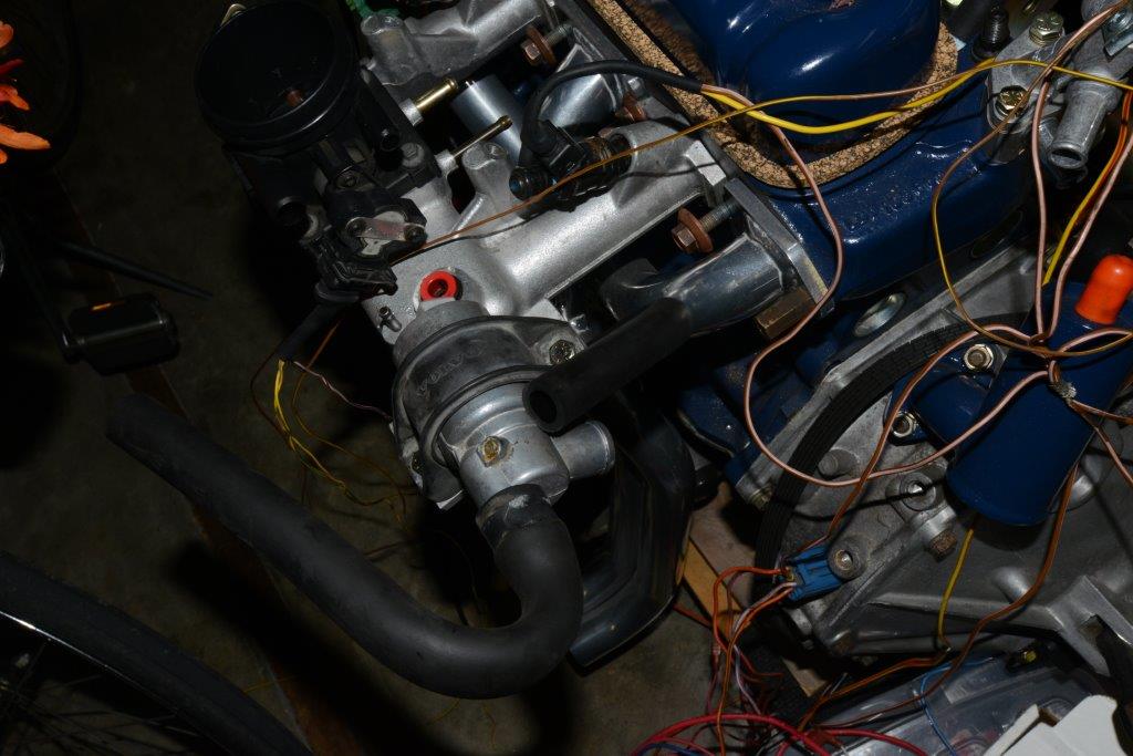

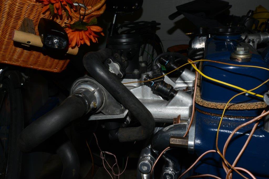

Terrible photos, but I made a little progress in finding a potential place to mount the Bosch IAC.
Blocked off the port for the Rover valve, mounted a plate for the Bosch, just trying to figure out hoses. In one of the photos you can see the Rover hose. I just need to insert the Bosch IAC inline. Also need to make sure my crude plate will seal properly. And I am worried that the weight of the Bosch IAC may be too much for the plastic Rover IAC mounting body.
