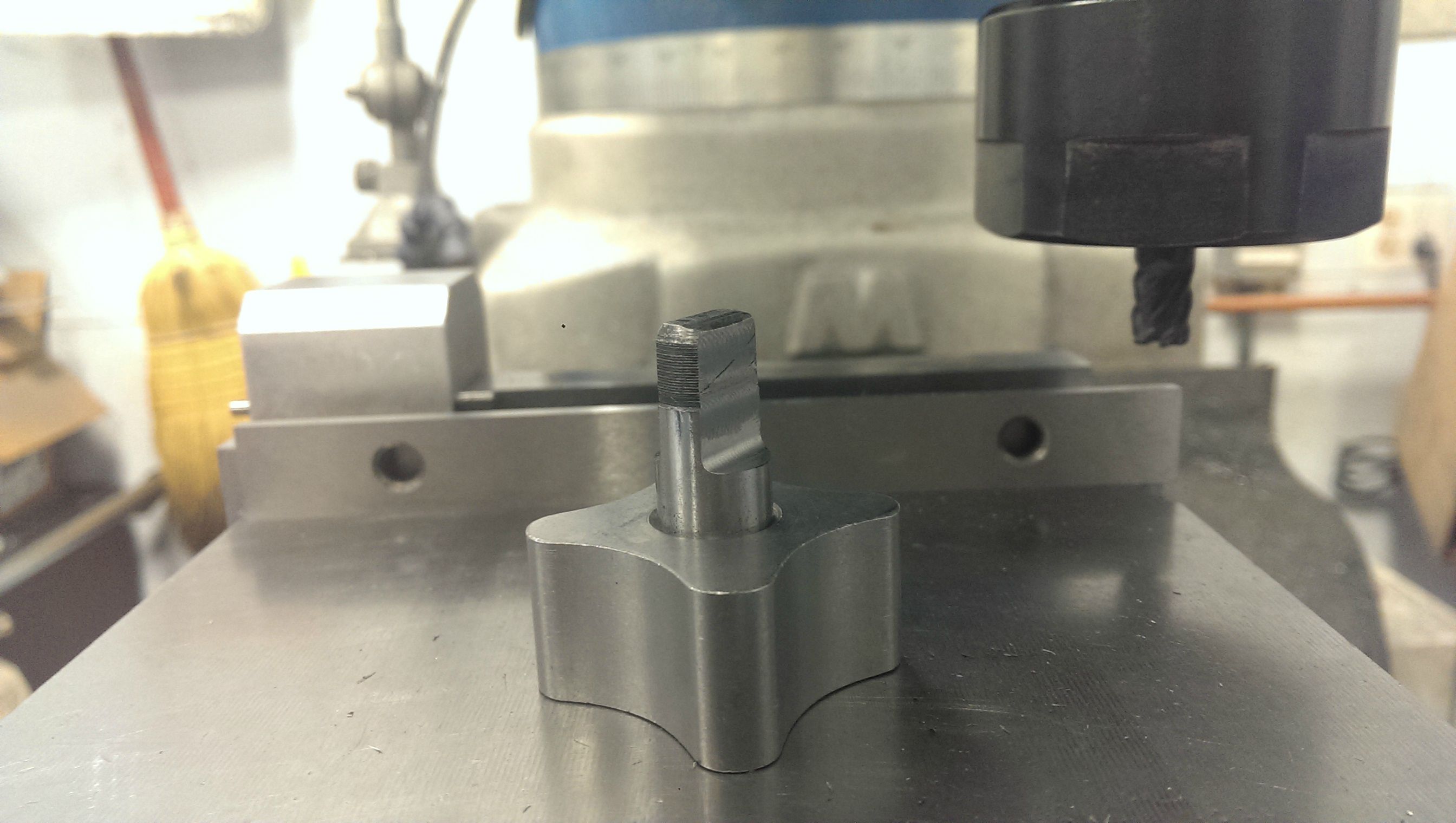

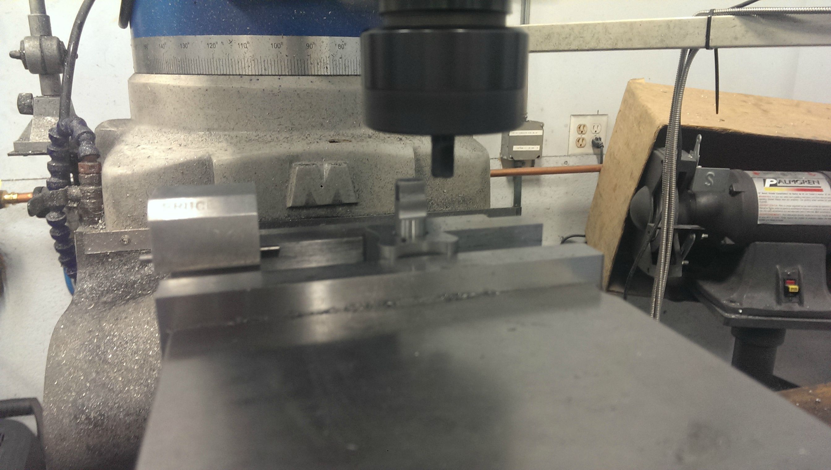

It took me a while to get my head around how to do it but this is what I came up with. The big difficulty was that the slot drive needs to be extended (there isn't enough extra length to just cut a new one). To do this, I used a parellel on the vise as shown. Checking it with a level showed that it was close.

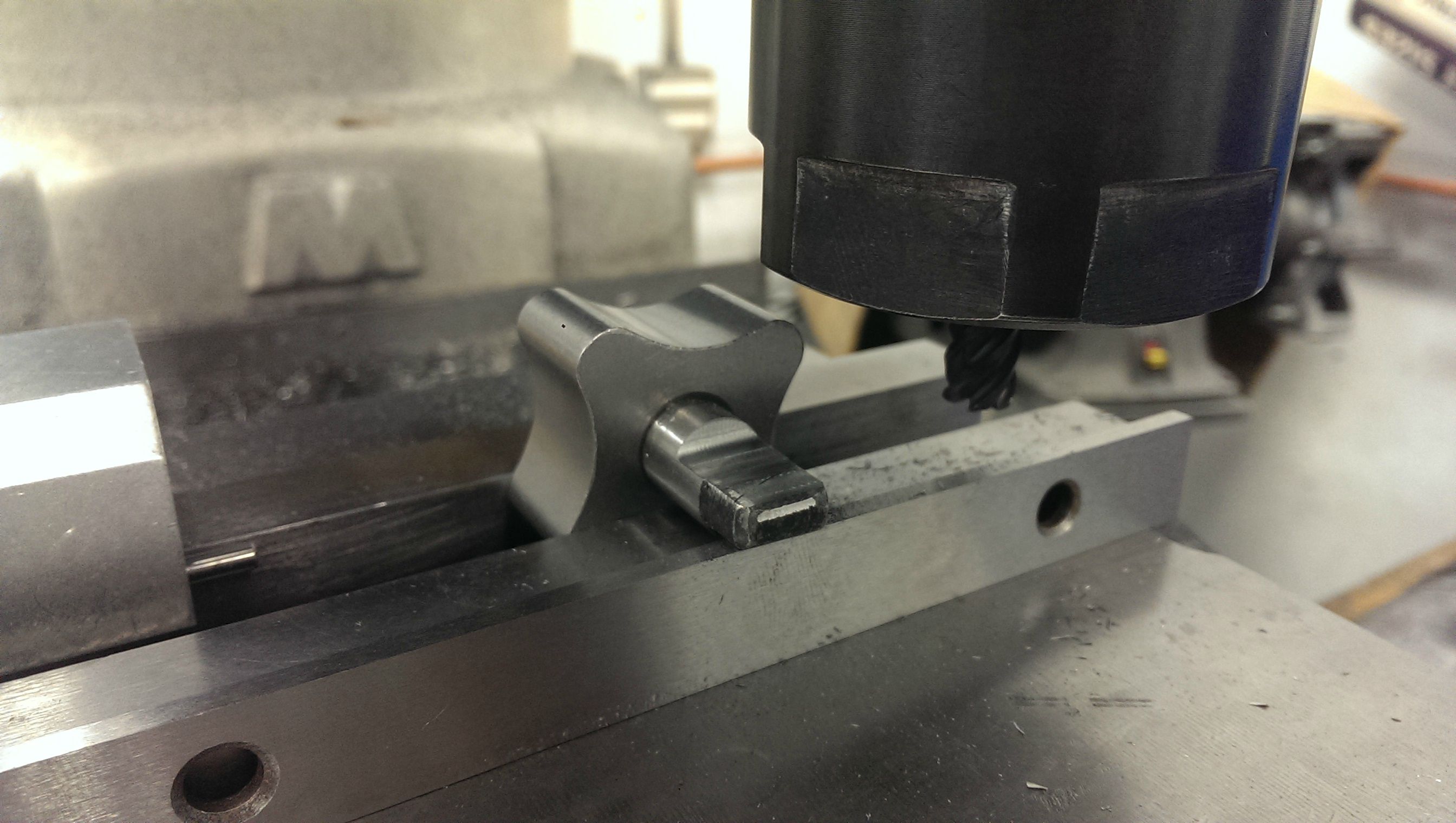

Then I milled the slot deeper (slot length for me was .601" from the tip):
After that, I removed material so that the slot length was (.328"):
Finished product!

I was surprised how well it cut because I figured it would be case hardened (difficult to file) but the carbide cut it like buttah.

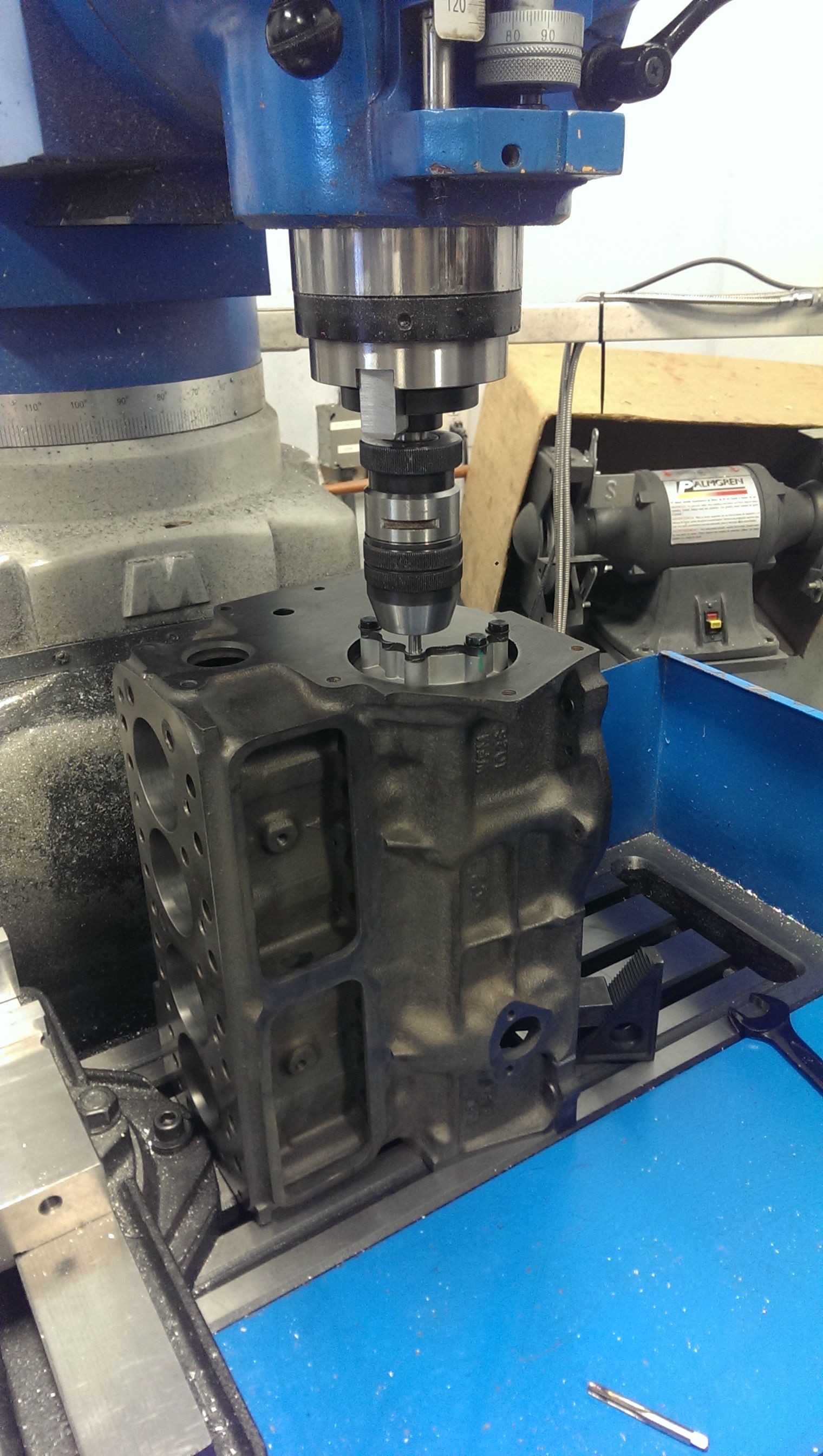

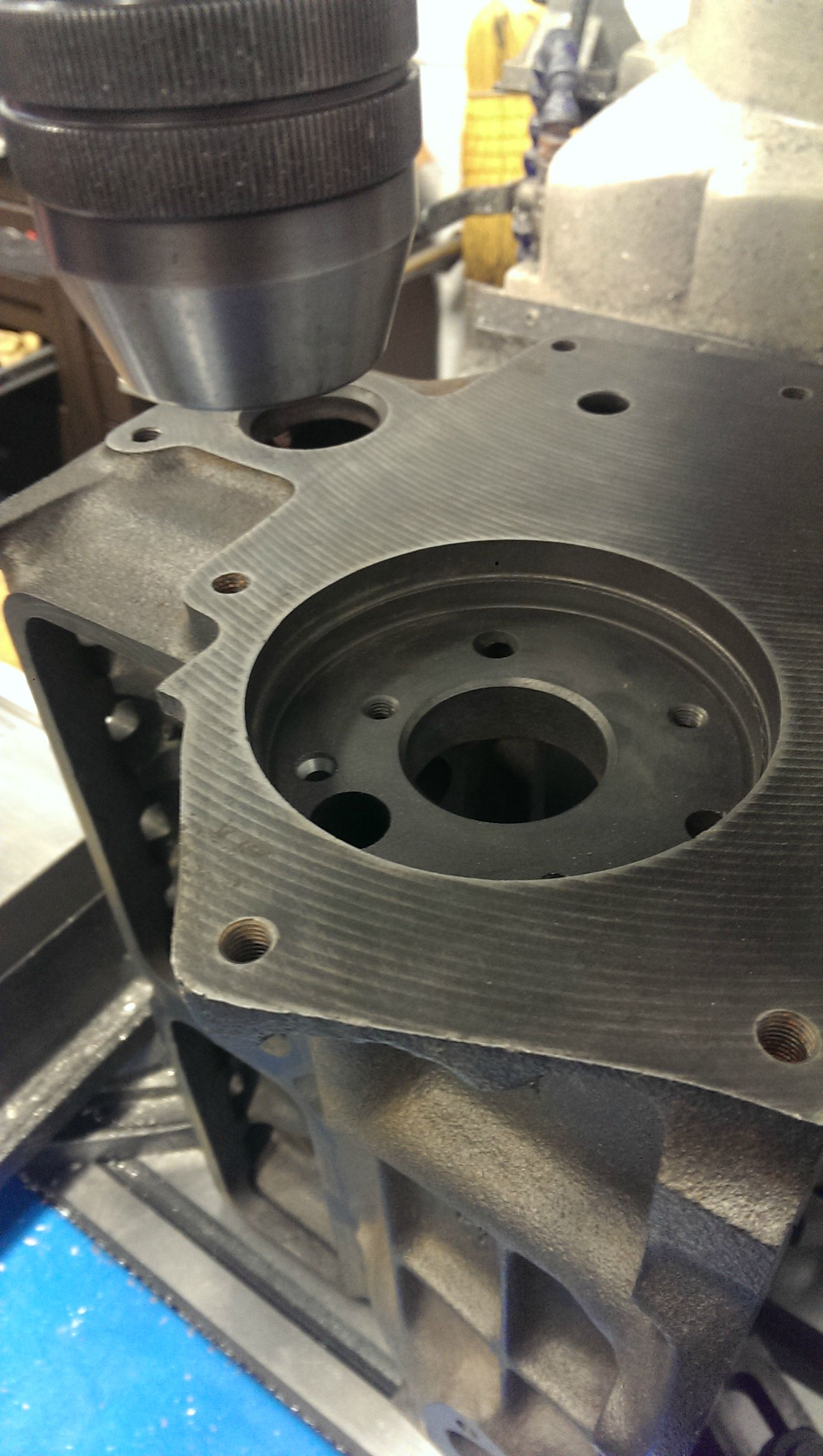

Got the block tapped last night. I may as well share the pictures for future reference:
Mounted the block on the table and then clamped on the bearing cap area. I then put the oil pump in and mounted it up with the hole that fits.
I then put a dowel pin in the chuck and move around X and Y until the pin slid with no binding.
Next, it's just a matter of drilling and tapping the hole. I went .70" deep on the drilled hole and used a bottoming tap as far as it would go.
