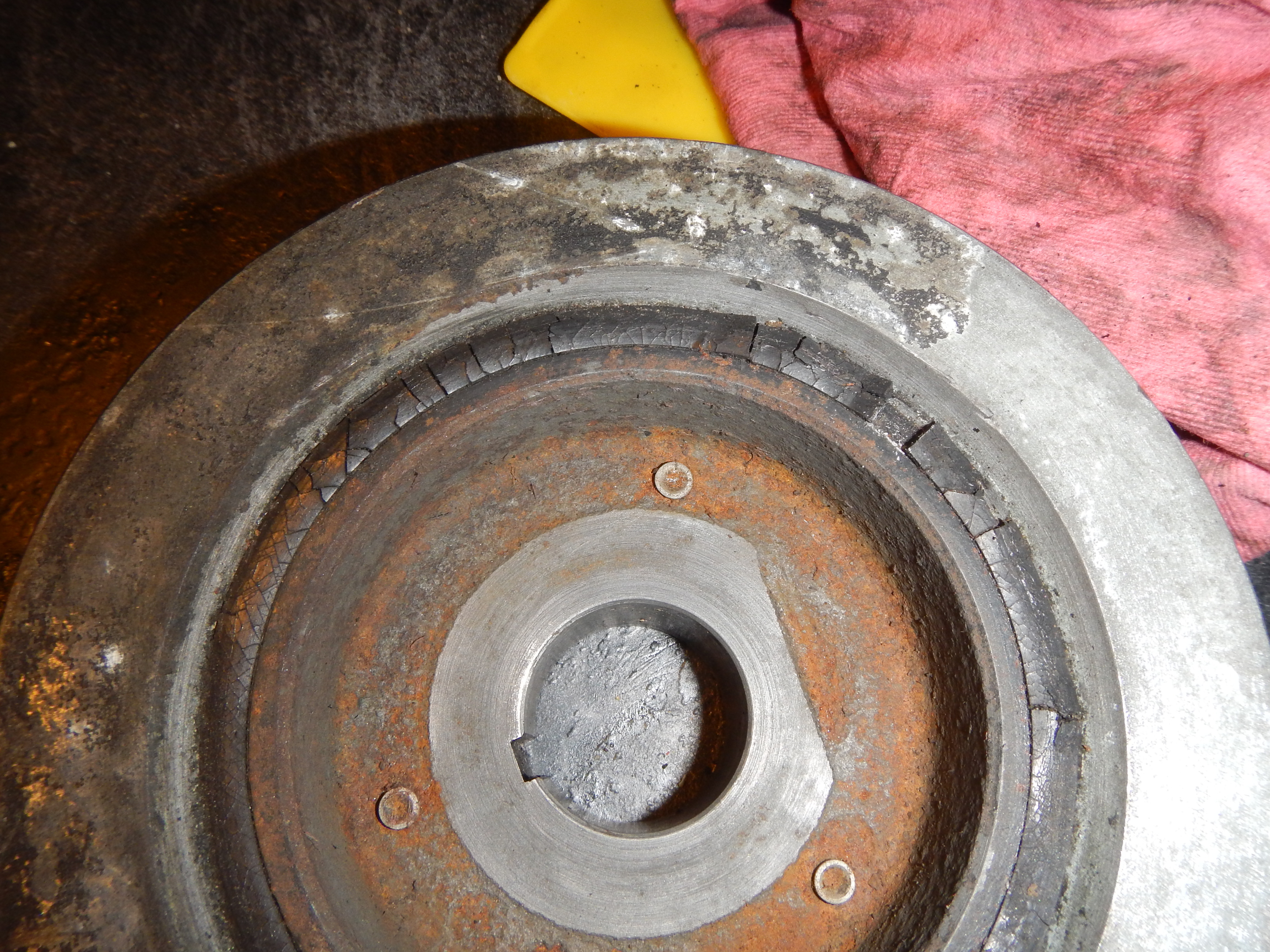

I'm hoping to use an old crank pulley with the extra counterweight and machine it for a Megajolt setup but amd worried about what looks like dry rot on the rubber in it. I'm not sure what this rubber does or if it would be an issue? Maybe it can be repaired?

I think you need a new one...

Try cutting a bit of the rubber and see if the cracking continues inside, if not then it's ok to use.

Roger that, thanks for the replies. I think I'd rather not risk it coming free.
Is the damper important or could a standard pulley work fine? I'm going to be balancing crank, flywheel, con-rods and pistons which should hopefully help remove a need for much damping

The idea of the rubber (?) bonded pulley is that it damps out harmonic vibrations on the crankshaft.(it is sometimes referred to as a harmonic balancer)
The 1275 is a long stroke engine and needs something like this, or very accurate balancing of the entire crank, clutch, flywheel etc if it is going to be used hard.I,m not sure that you could make a bonded pulley yourself, but I may be doubting your ability !
Most roadgoing 1275 engines survive pretty well on the standard "harmonic"pulley

That makes sense, I should note that this is for a 998 engine which, I believe, were fitted with the lighter stamped version or the harmonic style depending on the year. I'm not sure if the harmonic balancer is needed for these.
I'm not sure that I could handle the bonding myself but I was looking to take a go at something like the MED trigger wheel. I guess the question will be if I need the harmonic balancer.
and you cant balance the damper

Brett, why not?
Pedro Silva
4310 Posts
If its a 998 then most didn't have dampers. I would say you will be fine without one. Just fit a trigger wheel in addition to the pulley.

Fit a new one

Still curious to hear about why the damper can't be balance but that Selby trigger wheel looks awesome. I wonder if I can get a verto option?

Of course you can and must balance the damper. However, when it's as fucked as the pictured one, it might need it again.
If you're serious about your engine, you bin that!

I thought that the damper should be balanced. Definitely binning the one I have, now I'm just considering my other options.

So I ended up not taking any gambles and getting the new damper.
