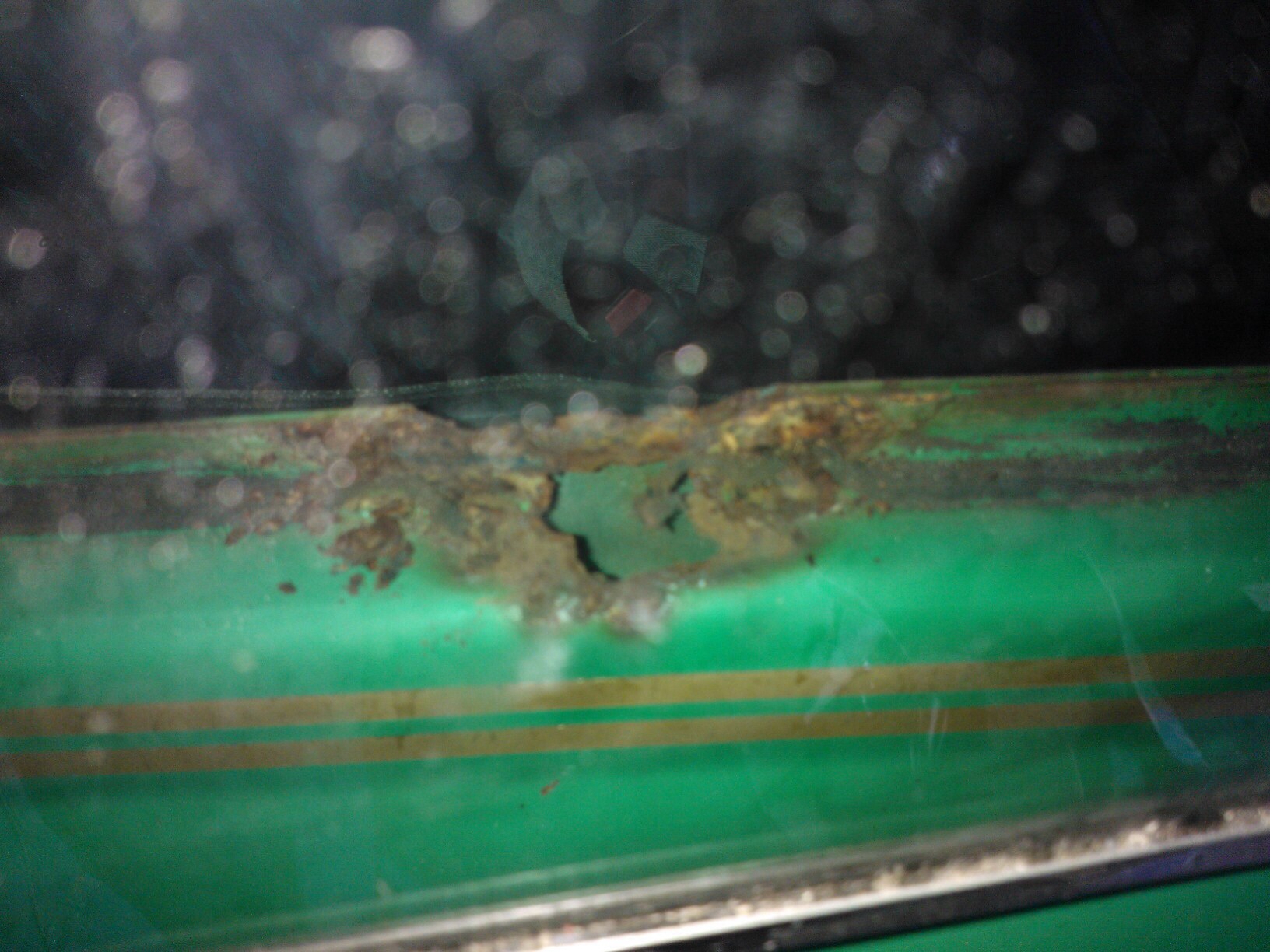

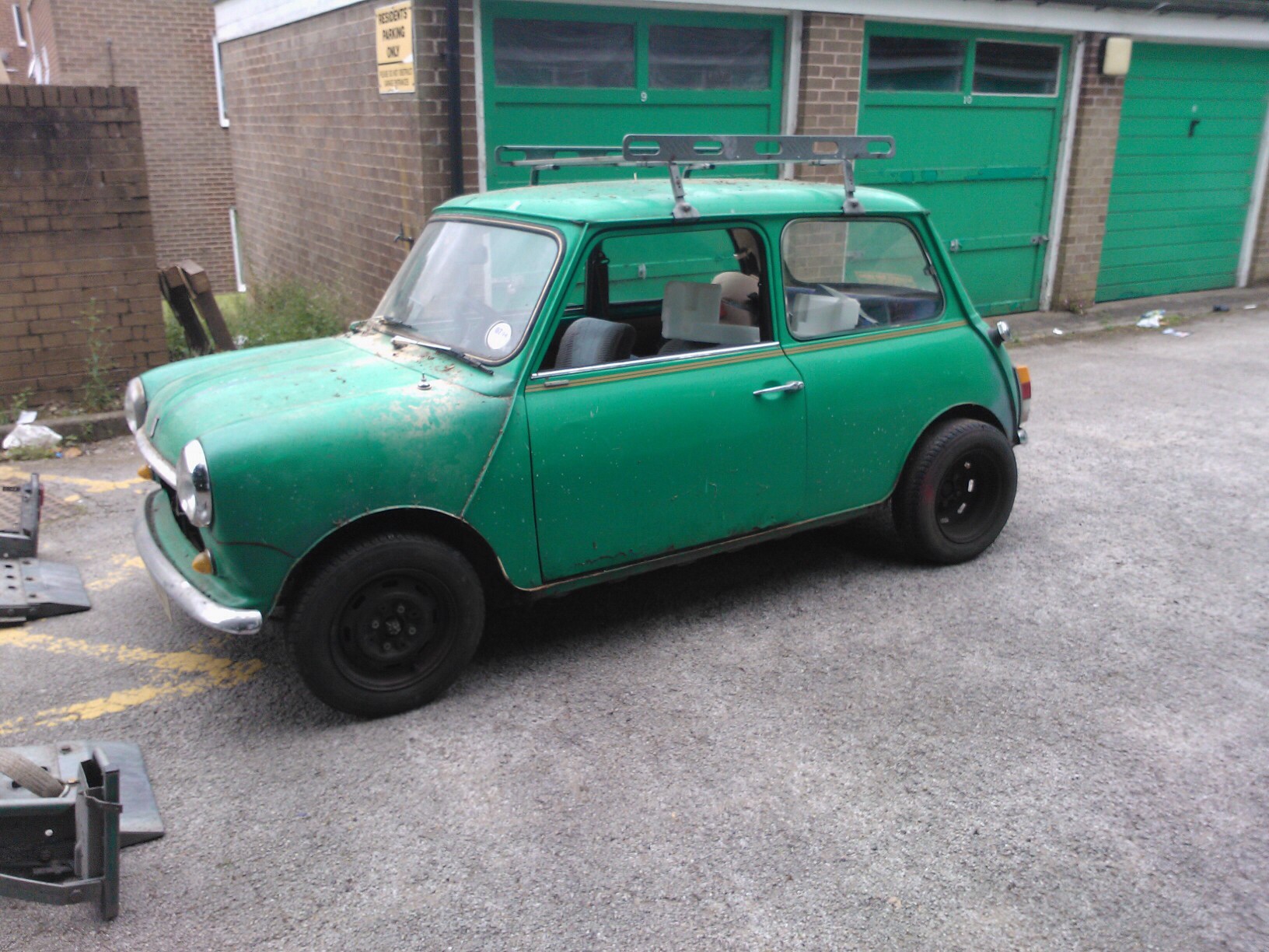

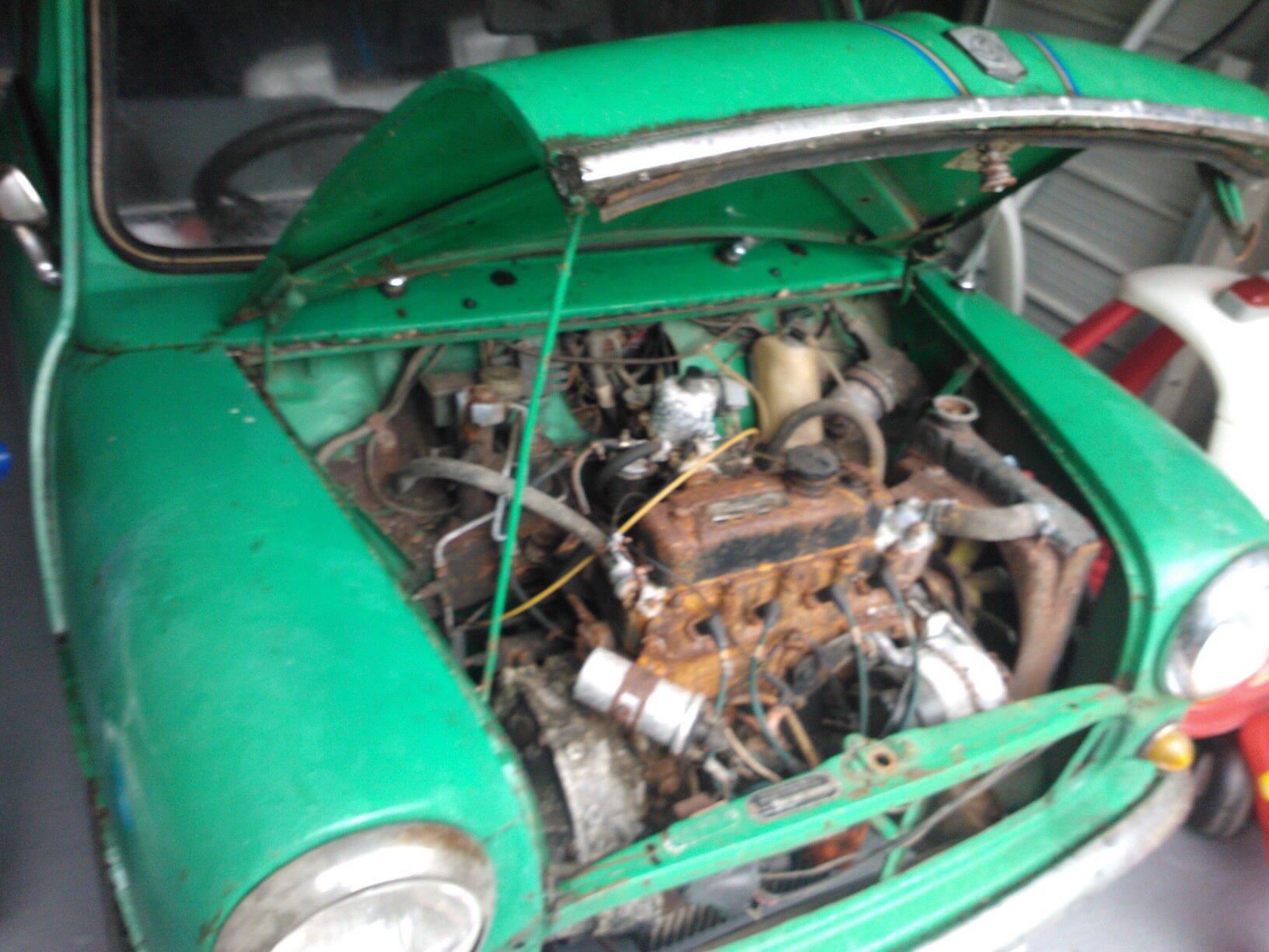

It's home! Got my work cut out here.....this one will take a few years. Let me know what you think!

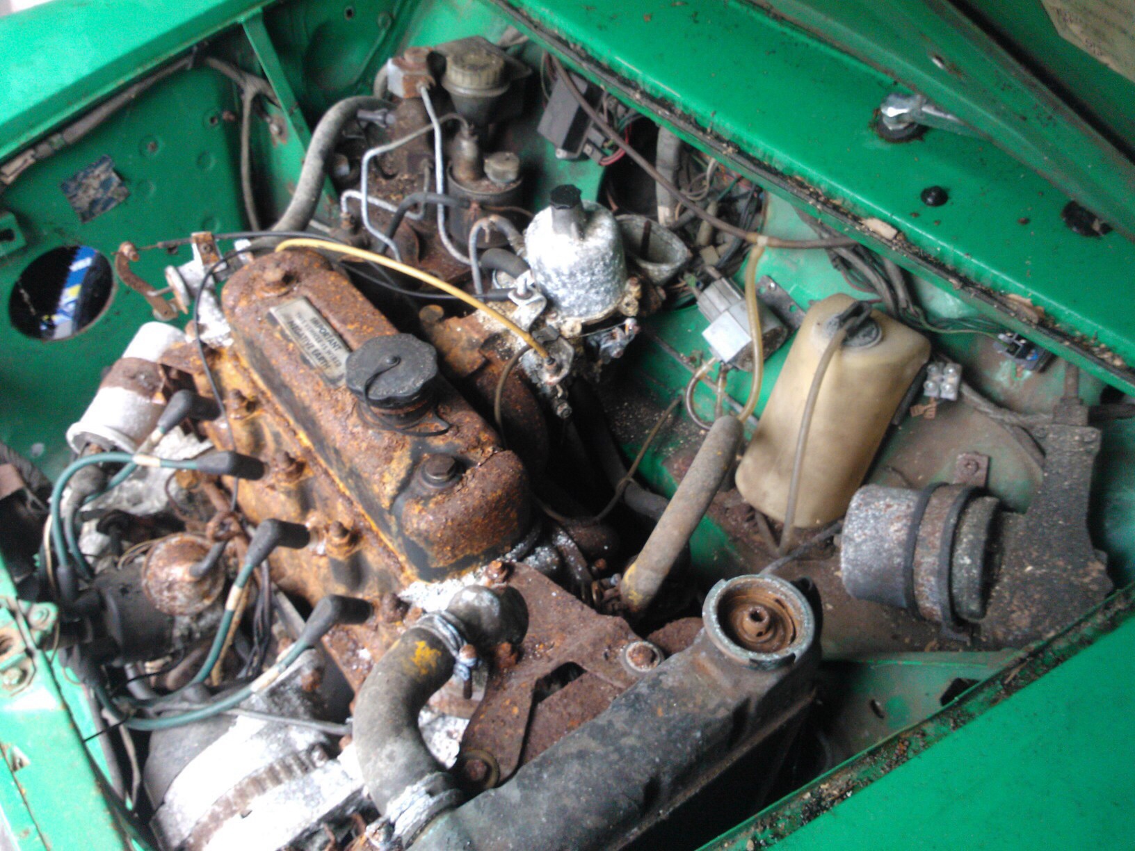

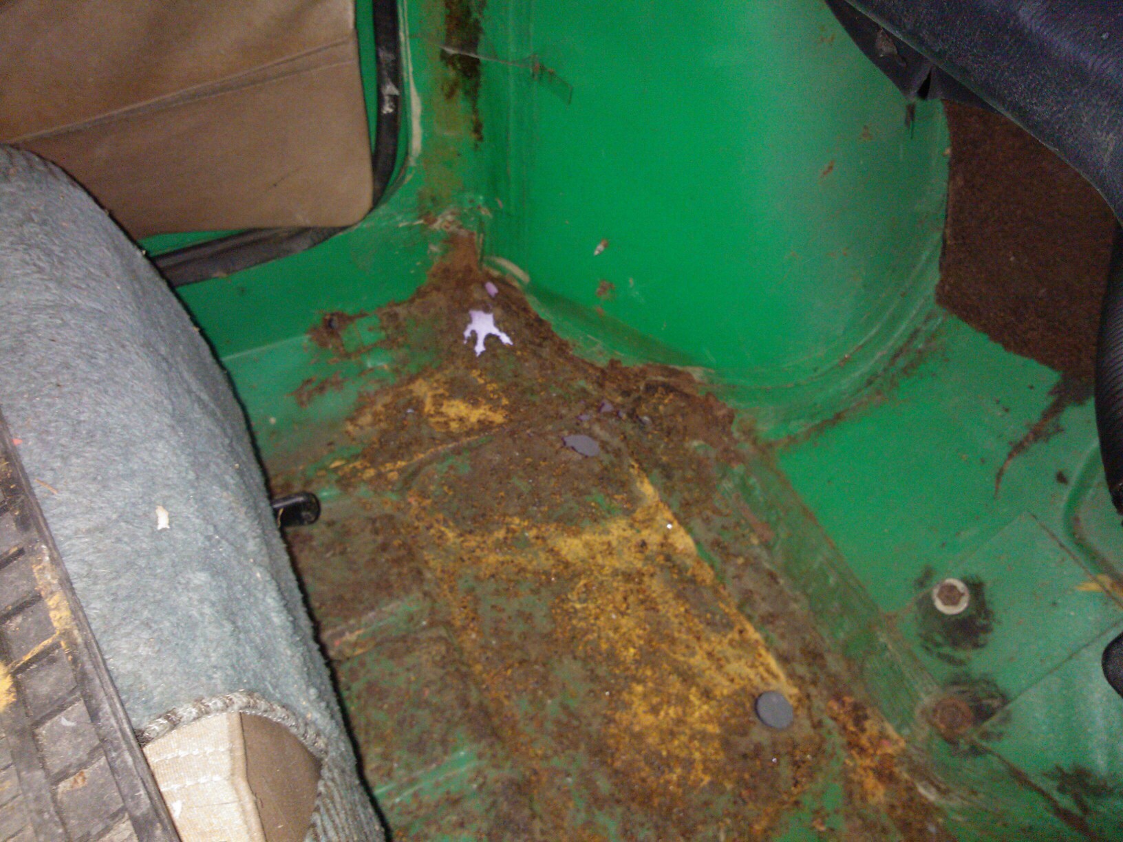

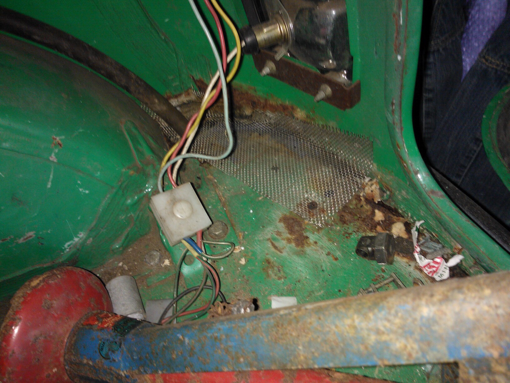

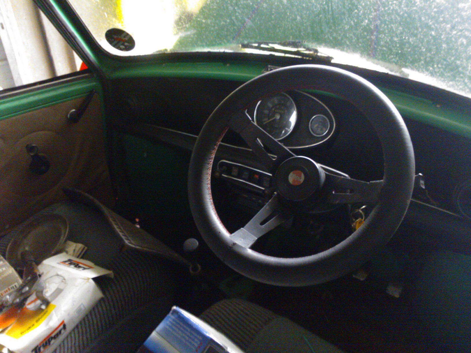

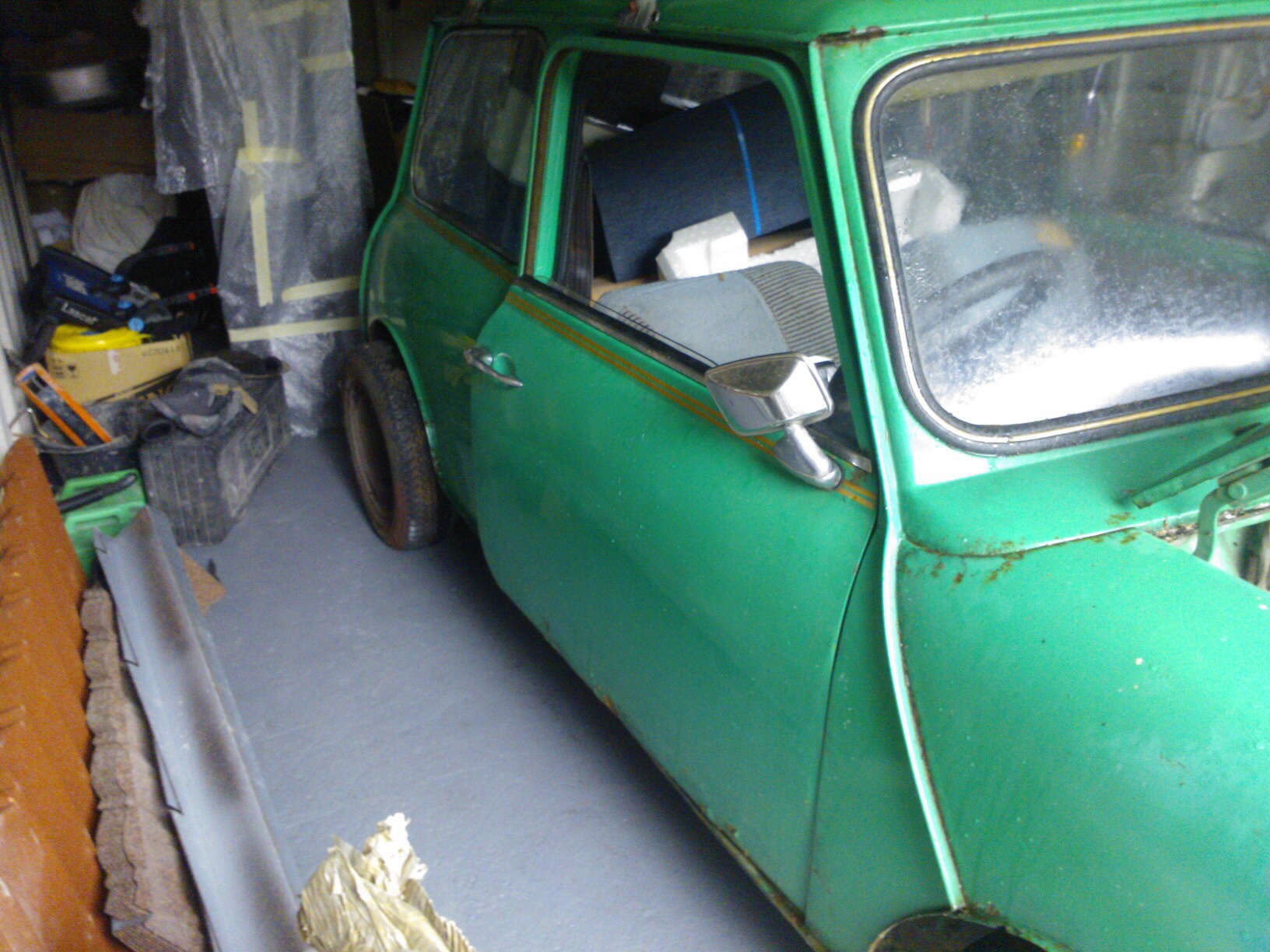

A few more

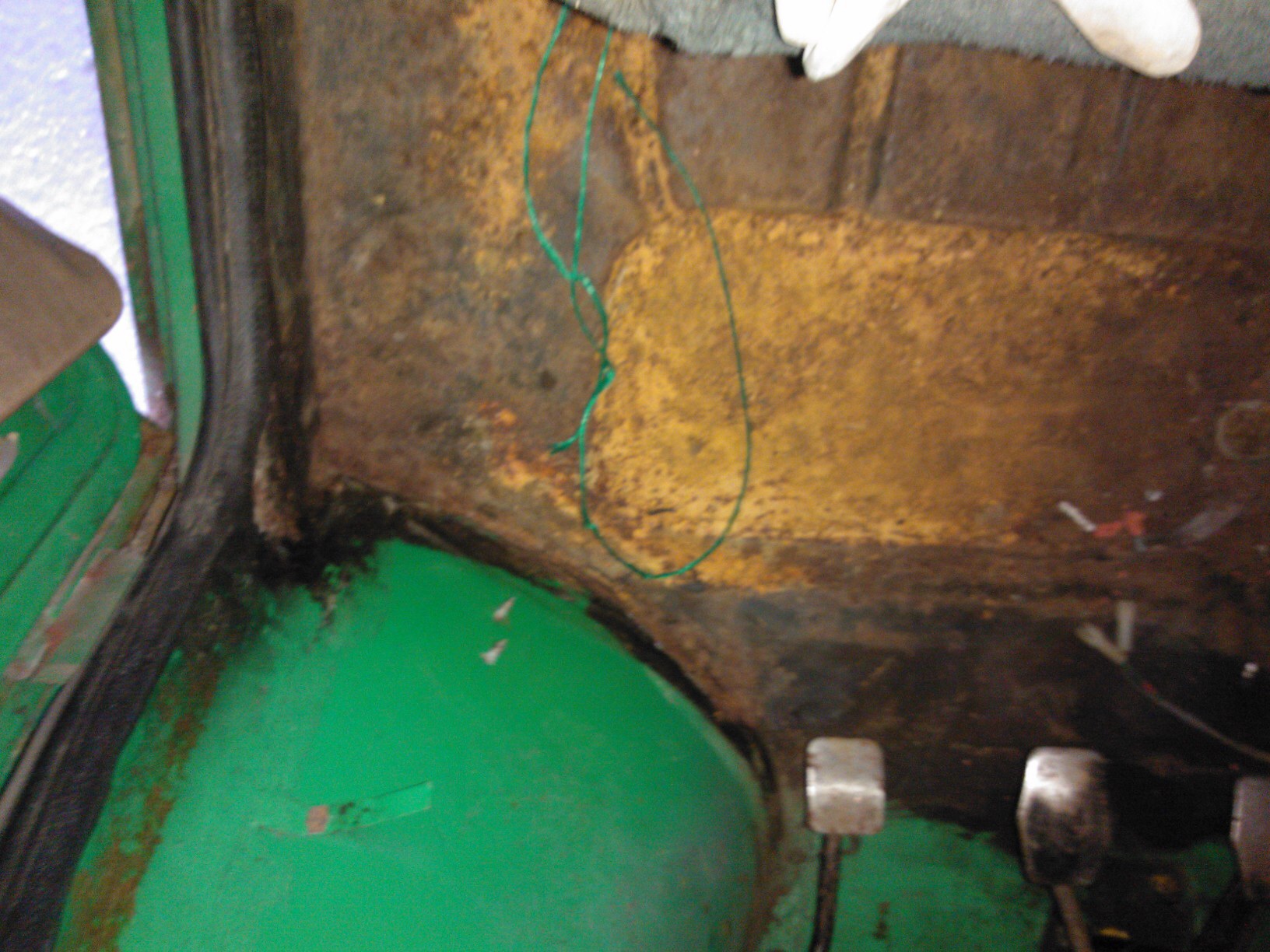

Boots a bit holey as well!
Billus89
359 Posts
Member #: 8931
Doesn't look half bad at all! Nice project
Doesn't look terrible. Considering that colour for my t'other mini.

That steering wheel is so chunky!

What colour is it Andy? I actually quite like it ad well!
I know...Astrali's finest!
Java Green IIRC.
