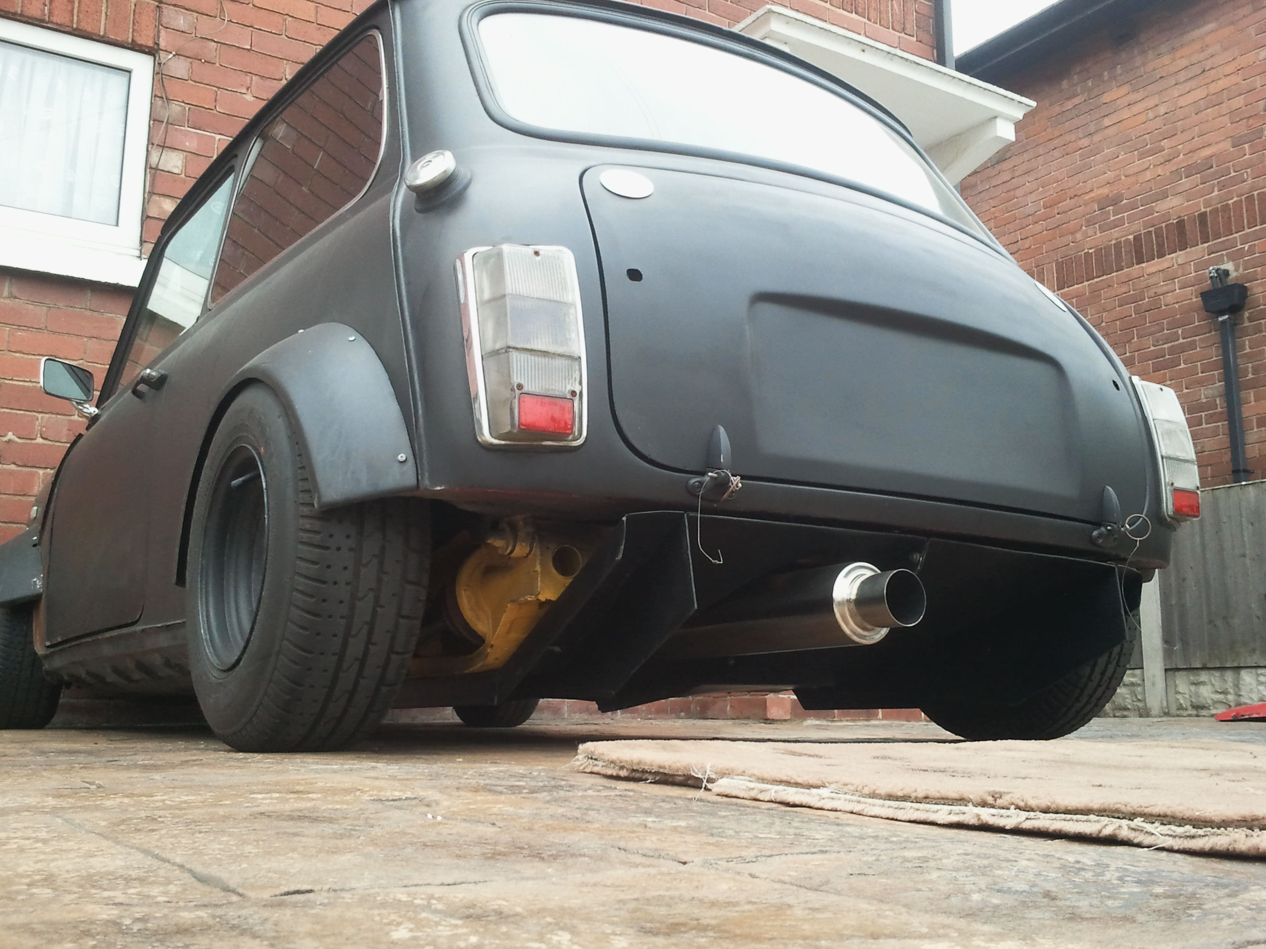

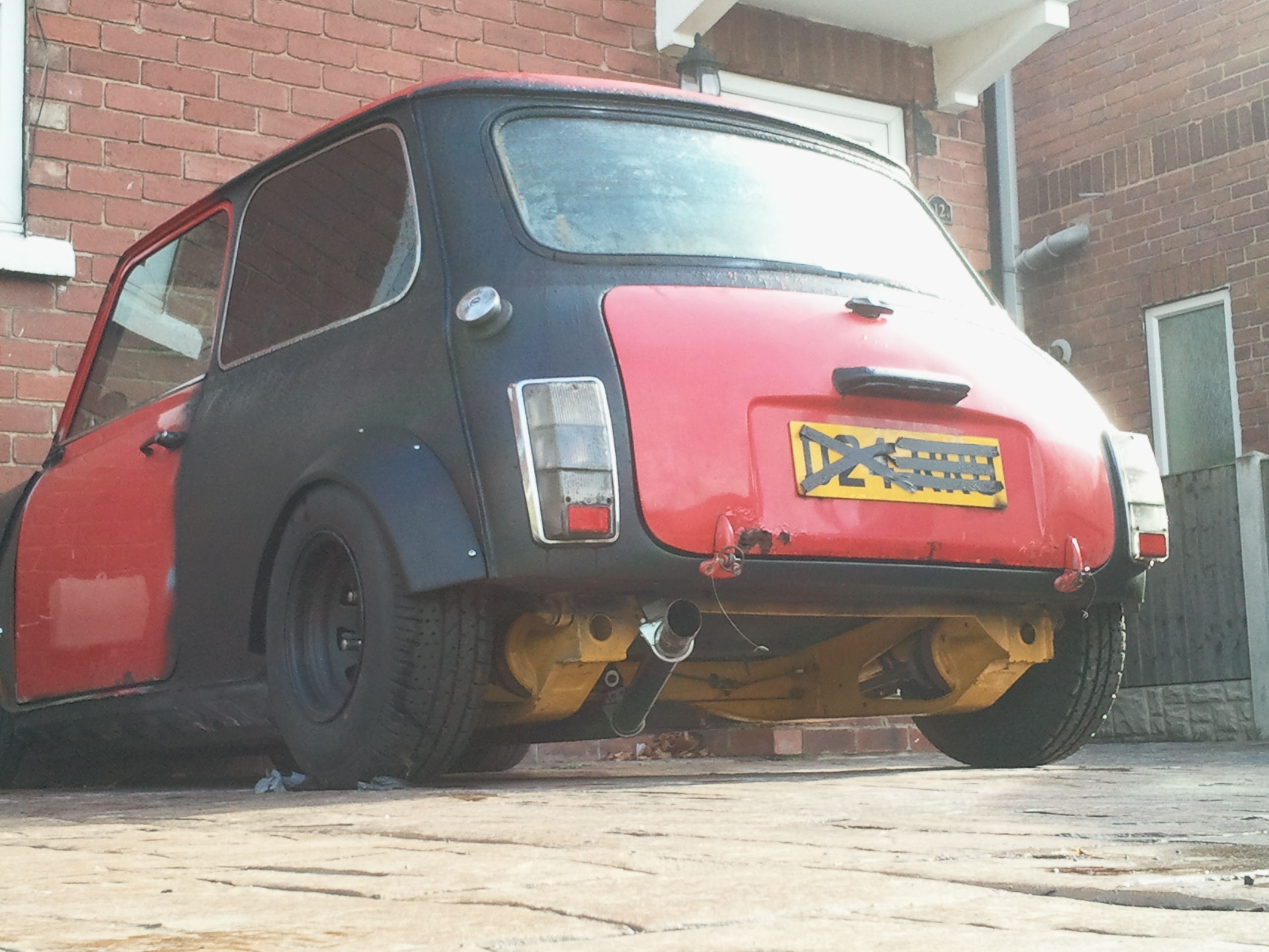

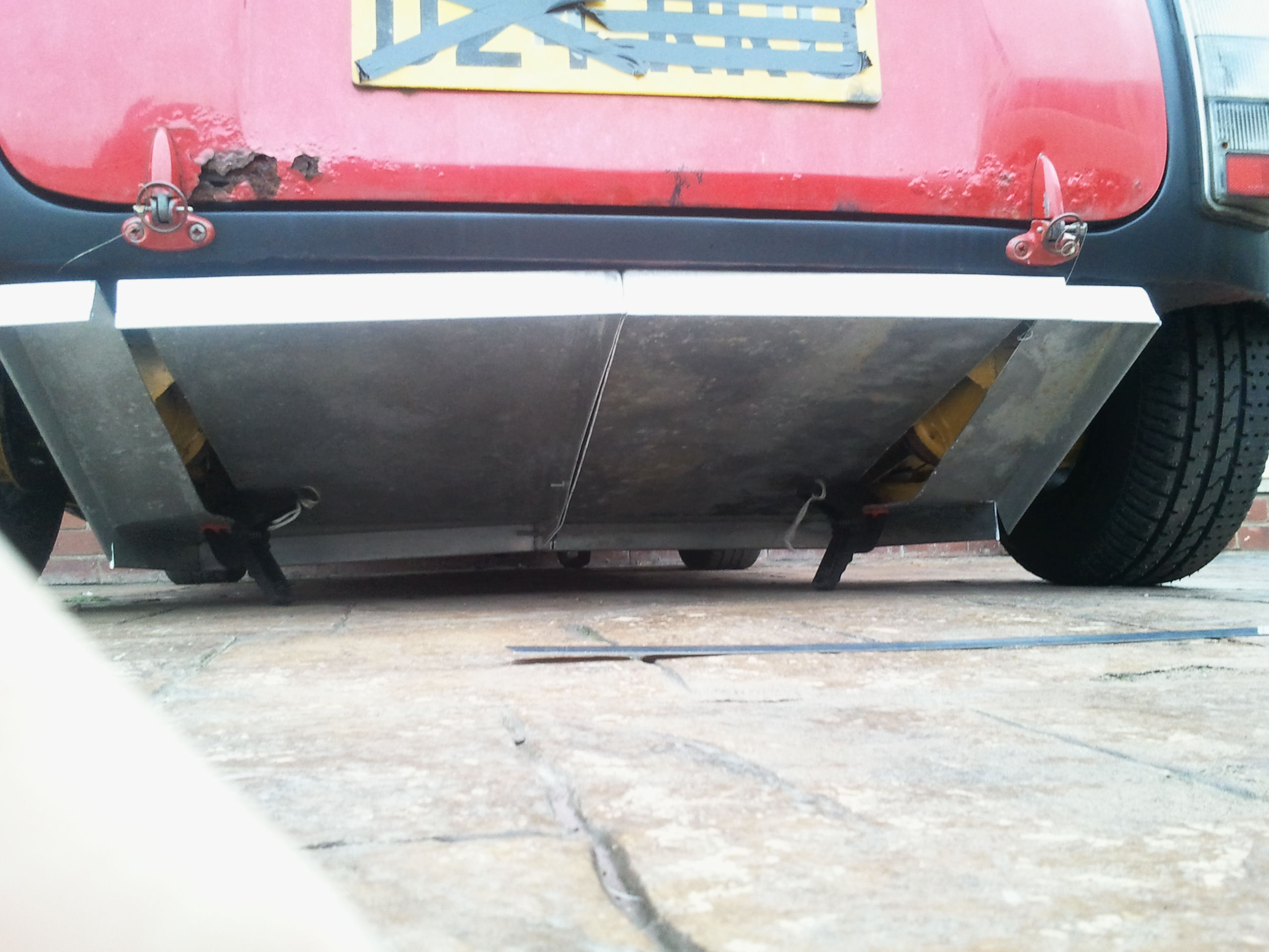

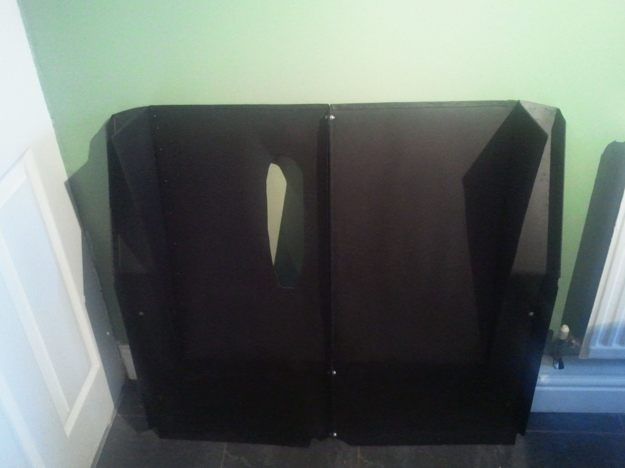

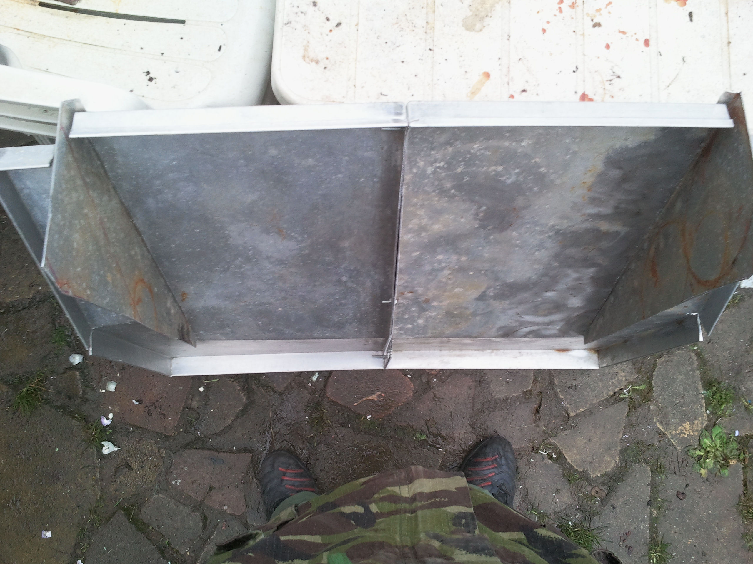

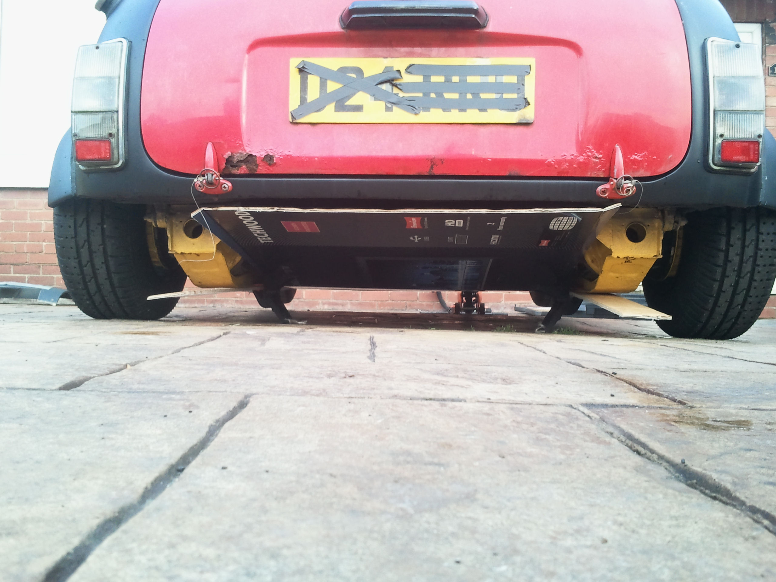

this is mine, i apologise is it will look like i took over your thread lol
the whole rear end was built to accommodate the diffuser flat bottomed boot floor, modified subframe
CAD *happy*
cut out and test fitted
vertical sides
finnished
fitted and trimmed as it wouldnt get off the drive *happy*
bolts direct to subframe and a blade bolted in the centre of the boot the forward most part onto the heel board
no idea how much grip it gave i only ever had it on the dragstrip one day without it and on the road once, it made the car super stable at speed and alot more planted in the bends
made out of an ex mod serving trolly *happy* 2 full shelfs *tongue*, still have it no idea what im going to do with it as my rear diff gets in the way, it wont fit a standard subby so may donate it self towards the new back seat / bulkhead area
