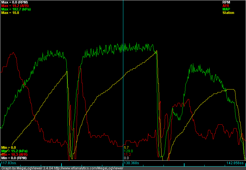

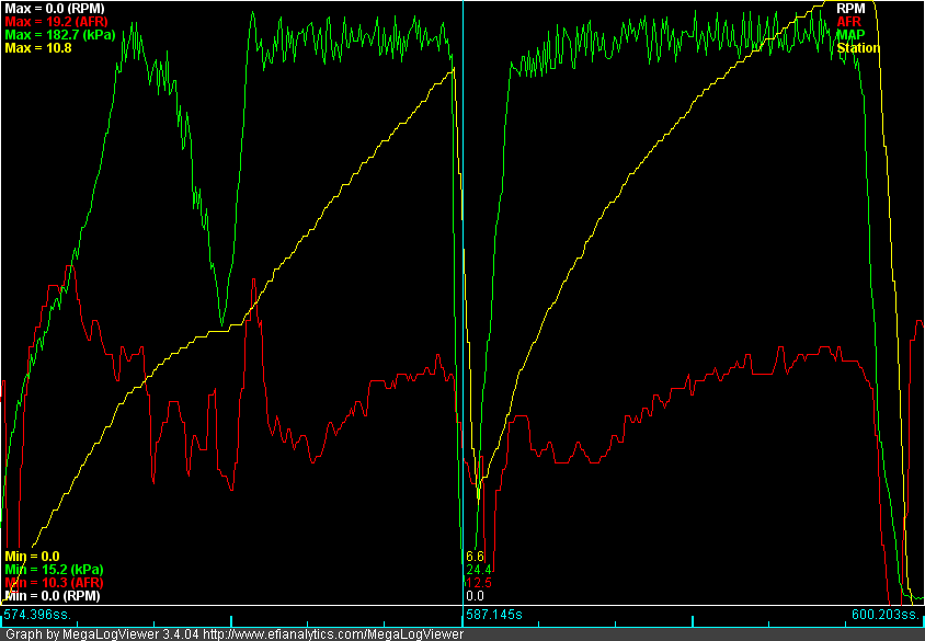

yeah it works well,
a couple screen shots from when i was profiling johns needle
this is my sensor logging on ms2 piggybacking over mjlj lol
