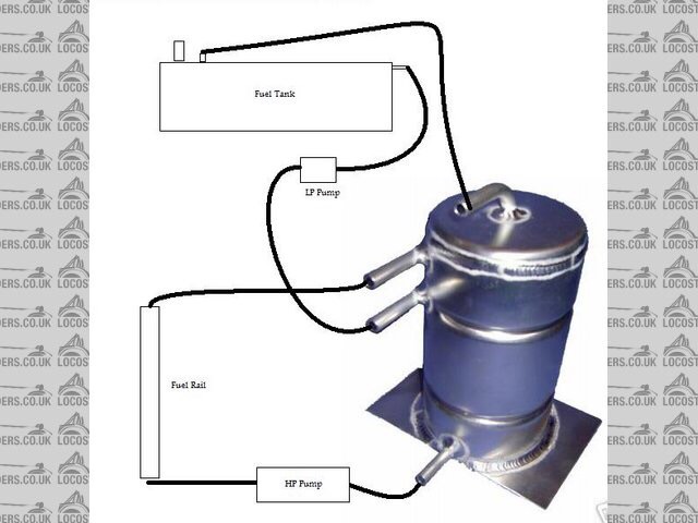

Just what to check with you guys before I start drilling holes in my van floor! Can I mount a swirl pot upside down? I know it's designed to be upright but surely if I reverse the outlet to inlets and vice verser it would serve the same purpose?? The reason being is I don't want fuel line running inside the car for obvious reasons! The pot I have this.

You probably could. But bare in mind a lot of cheap swirl tanks will not be made to carry the weight of fuel/tank on their thin bases which may lead to a failure.
If you want one specific to your needs, just get one made.

Yea I'll keep that in mind. Maybe 2 long thick steel cable ties as added support. Should take most of the strain off the welds! Mines only a litre in capacity so it's not carrying massive amount/weight of fuel!

If you mount it upside down it won't work connected as shown (as you say). But even if you swap it all over the lifter pump input will be in the wrong place, it might work, but it won't be ideal.
When I did mine, I put the bracket on the top and bolted it through the floor. It was fine. I ran the return through the car no problem.

Do u happen to have a pic of how u mounted it? The pic I attached was just a random one from Google that I put on my phone to explain to my had the principle of the swirl pot

Does this help?

Yea that's how I am thinking of mounting my one! If I had a salon I'd mount it upright as it should be in the boot but I have a van and seen as there's no where really to mount it!

You have pipes slap bang in the middle of a "swirl" pot ?

Can you not keep it up correct way just get some mounts on the top?

Yeah, that's the lifter pump input. I would have liked it a bit higher, but that's the way it came, worked ok.
