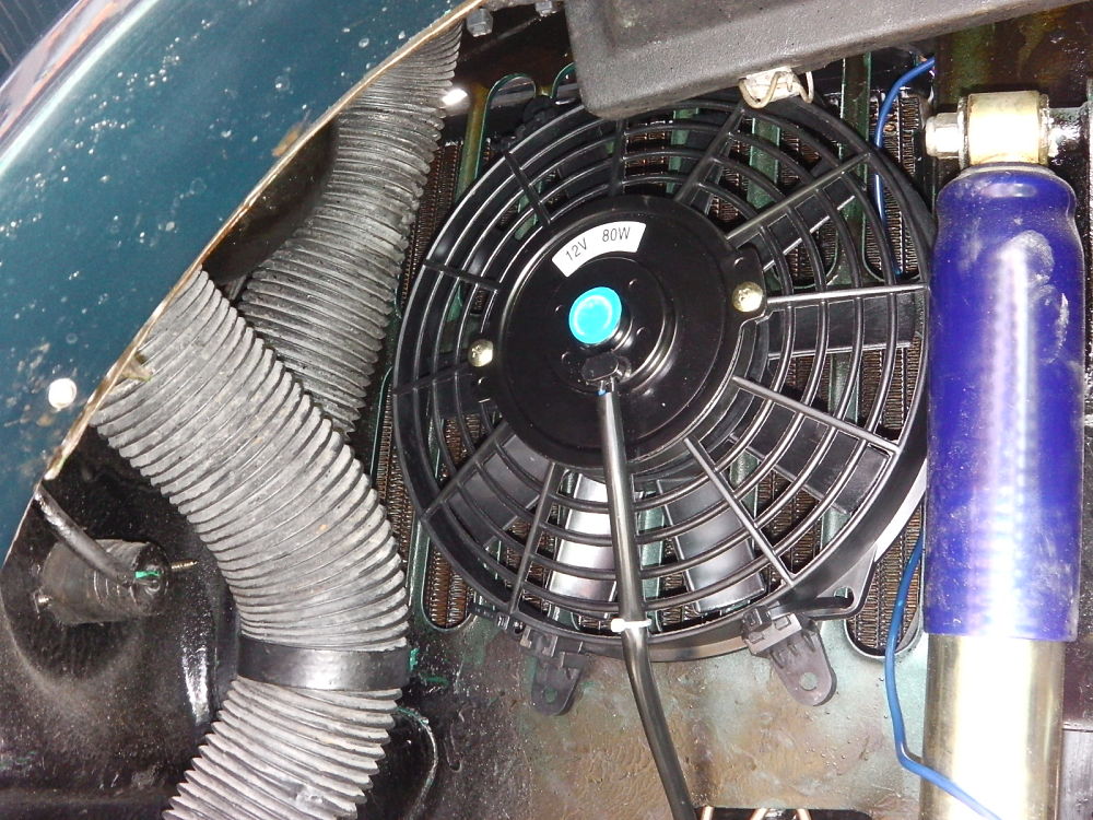

I fitted a fan under the wing that cuts in automatically at about 90 degrees. It worked very well. It slowed the temperature rise down but it didn't stop it. Fortunately I didn't get stuck in heavy traffic jams during the summer so it was OK.
I thought if I fitted the electric fan to the radiator between the rad and the wing it would pull more air directly through the radiator so stopping the temperature rise when stopped. The fan I have is to deep to fit without wing mods.

In my attempts to stop the overheating I fitted a fan under the wing as in the picture in my first post. It slowed the increase down a lot it worked very well but the temperature still rose. A lot slower but it still rose. I thought if I fitted one closer to the rad in the space between the rad and the inner wing it would pull more air through the rad. I made a shroud to go around the rad to close the gap.

It's difficult to tell from that photo (really need a close-up of it) but could the mechanical fan be on backwards ?
They can be fitted either way around and, although the genuine ones are marked "engine side" I've seen copies that aren't.
If fitted backwards they still blow in the correct direction - because the angle of the blade relative to the airflow is the same whichever way around they are - but the blades themselves are a curved aerofoil shape (like an aircraft wing) so are much more efficient if the leading edge is hitting the air, not the trailing edge.
That could explain poor performance when the fan is turning slowly.
One other thought, is the spacer fitted ?
There seems a lot of blade in view outside the cowl.

There is a spacer fitted at the fan I think it is the camera angle but I will check it when I put it back together. The concave side of the blade is facing the rad. I could have it wrong.
