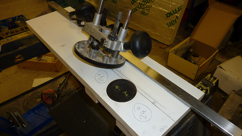

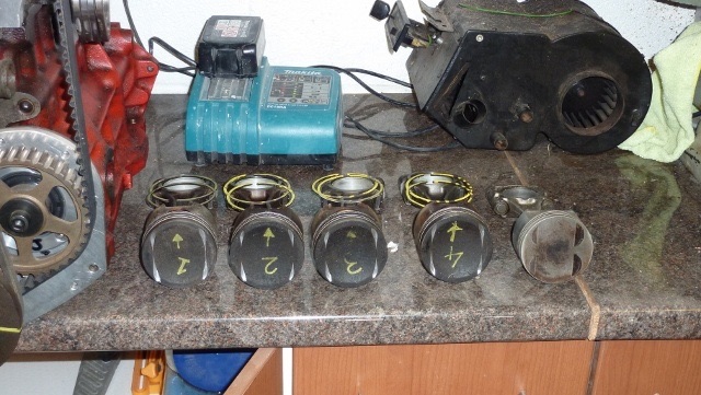

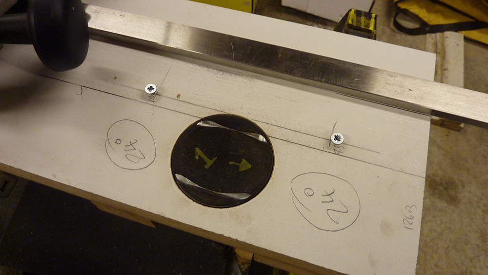

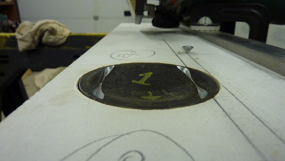

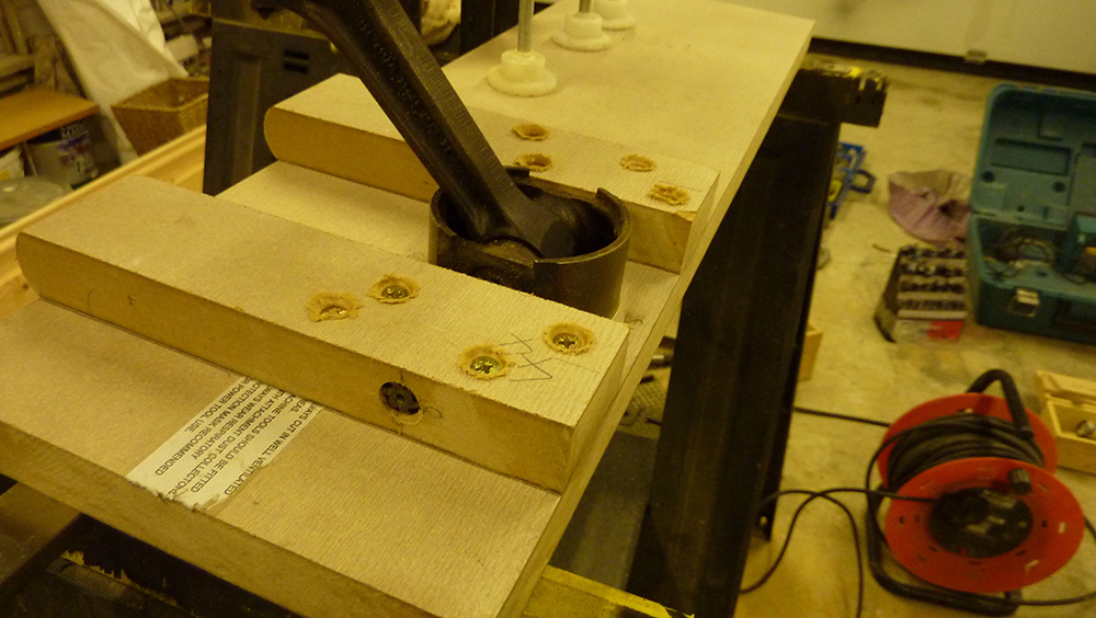

Hi I also wanted to do as much as possible myself, I wanted to do the complete conversion by making and modifying everything myself, I just cut the pockets in the original 1275 Pistons and I coppied the bmw pistons. It was an engineering challenge more that a quest for power. At the risk of ridicule I'll post a few pics of how I did it in the 'garden shed', please be kind with your comments.

Once I go the jig and tool set up I simply 'production lined' the set.

ok i get how you held the piston. but you didn't use the router for cutting the pockets did you???
terry
erm,
so you copyed the position from the BMW piston to the A series piston?
if so you havent allowed for a series pistons not being in the same positon as the Bimmer ones

Terry yep I did use the router :) , tungsten tip cutter, same princible as a tipped milling cutter, worked a treat , the Pistons are only aluminium type alloy, soft for any cutter, you not like the idea.
Joe I made them symmetrical around the centre line, for ease of "production lining". Yeh I figured out the head/combustion chamber wasn't exactly on the centre of the bores, I alowed for this and cut a little bigger than the sample but then the Pistons on the bmw at tdc where flush with the block, the a series Pistons at tdc are about 1 mm low and it's only clearance, again negating the need for being too accurate. As I said the conversion was an exersize in garden shed engineering not a quest for power. Although it has now become the latter.
