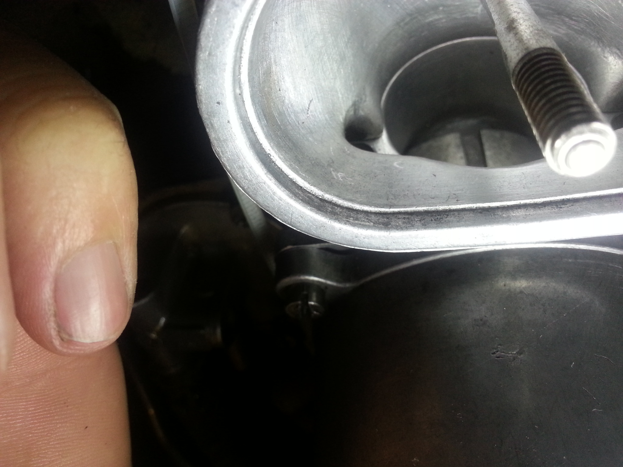

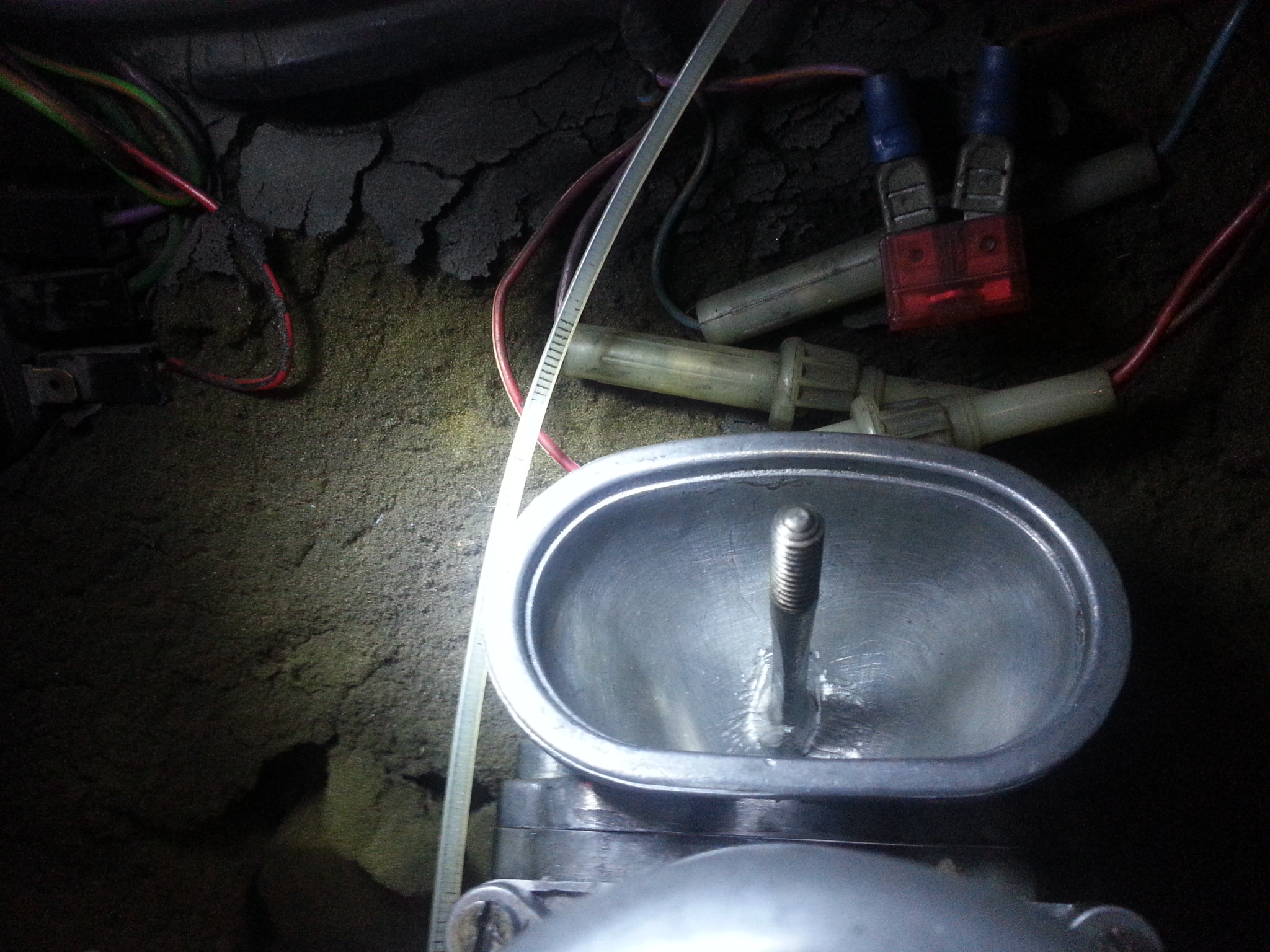

stage 1 kit with a freeflow (temperature wrapped) and RC40 side exit

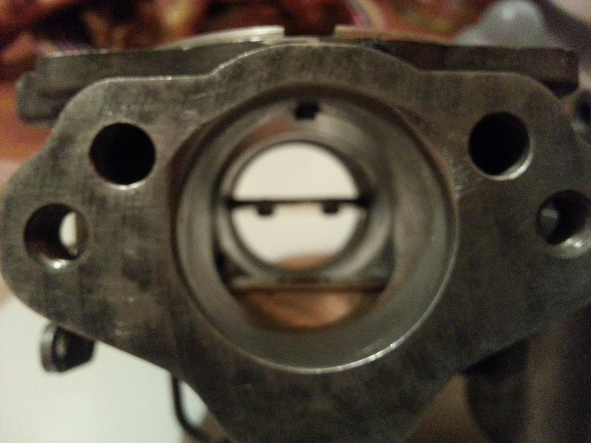

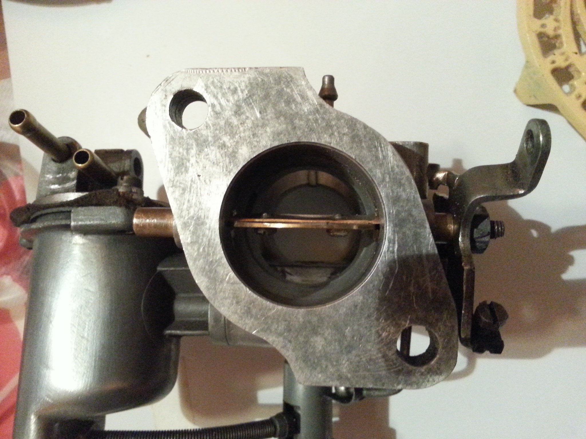

HS4 flowed carb
the head had the inlet rounded to better match the "one size fits all" stage 1 inlet from Minispares ...

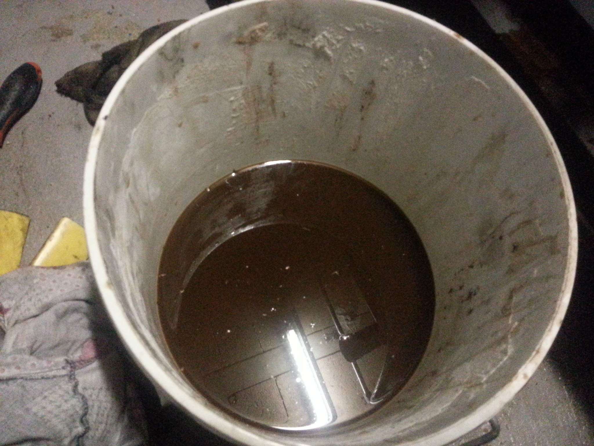

removing the mechanical fan (the car being '92, it has electric fan in the wing), add electric fan switch and clean up the cooling circuit *surprised*

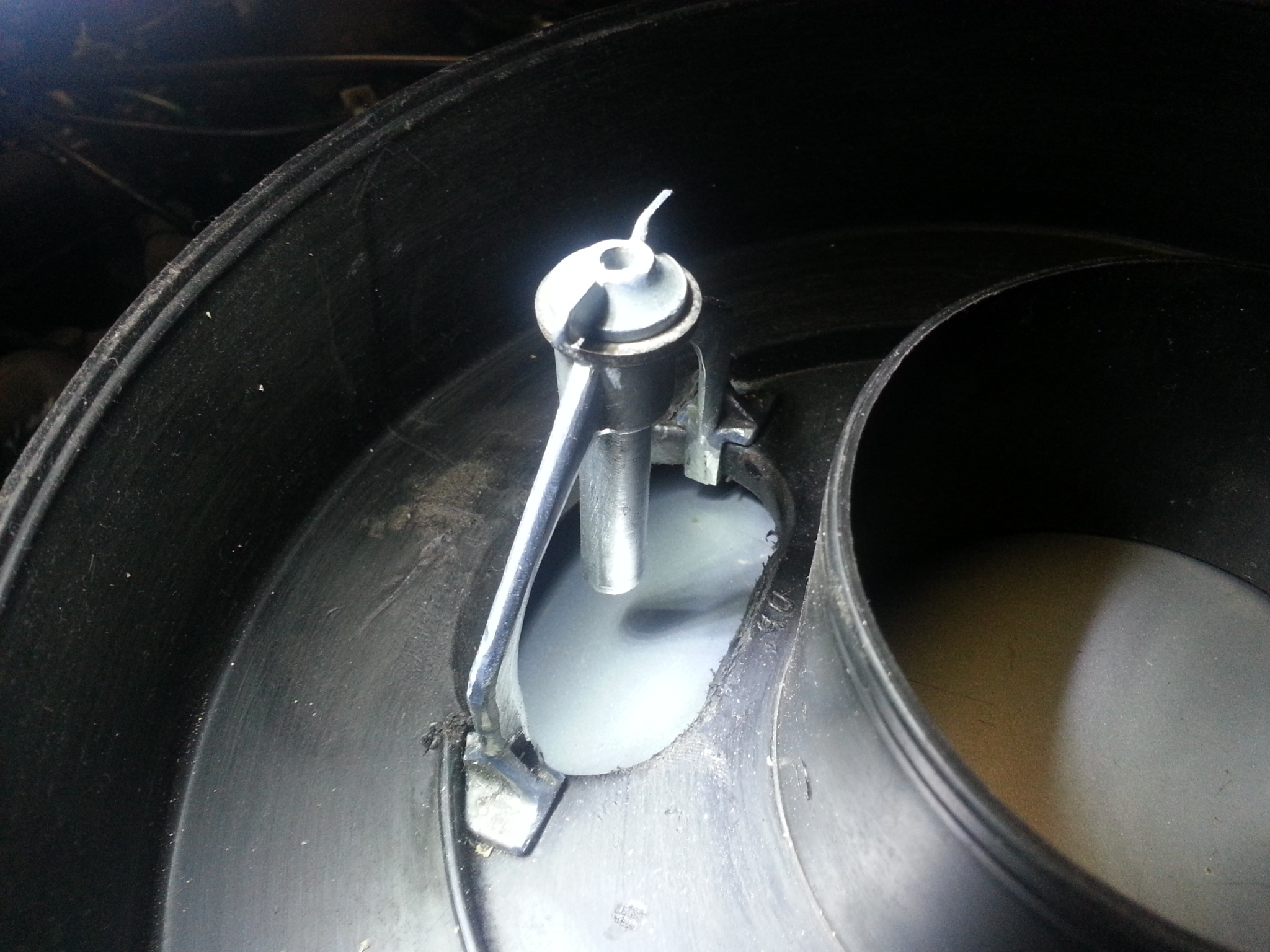

fancy up my standard air box (bigger inlet, flowed internals)
