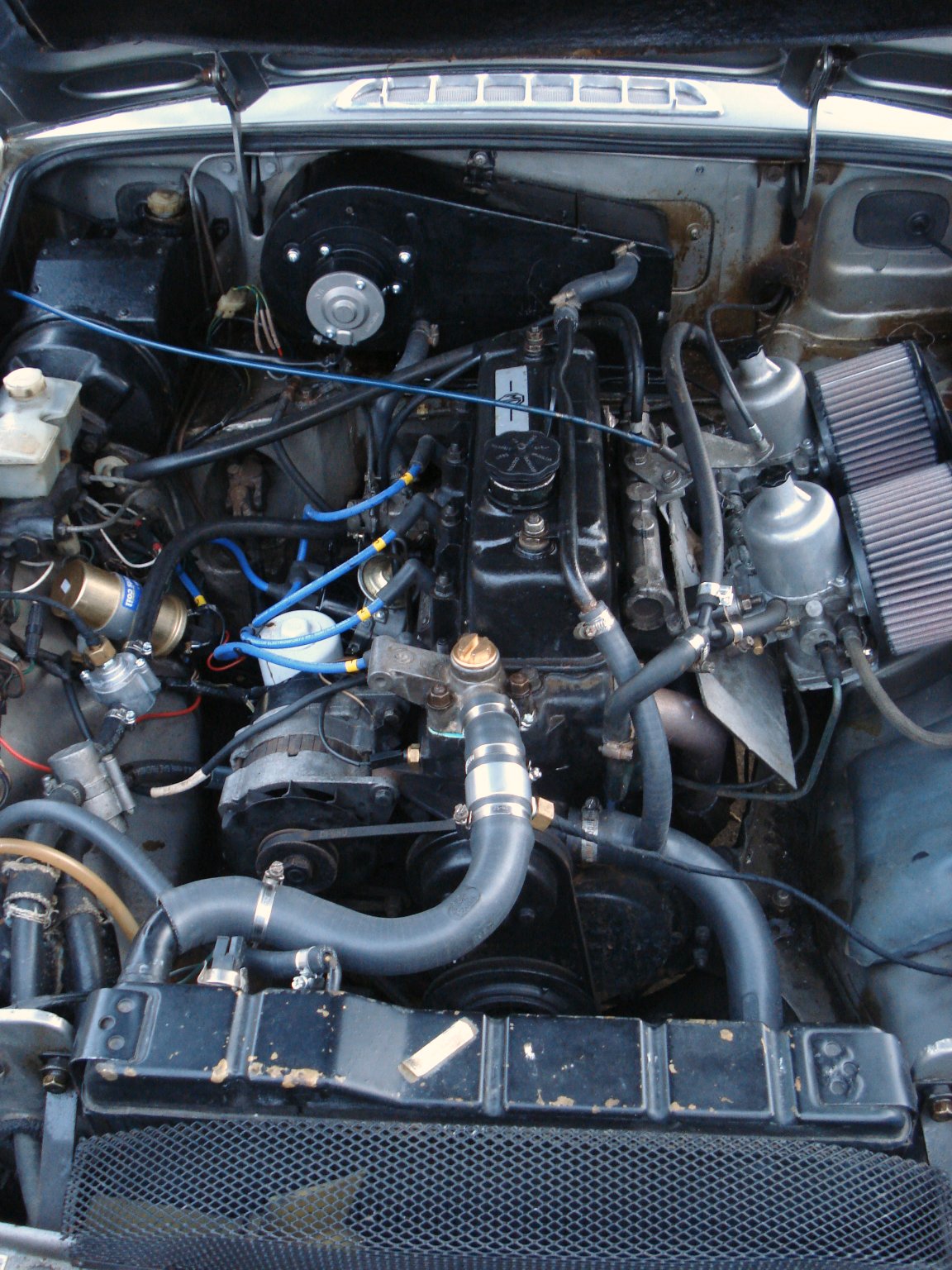

Another question would be is there enough room? I'm thinking that the turbo would be in the space above the chassis rail, with just down pipe running close to the rail.
A GT17 on an appropriately shaped manifold should fit in that gap. lots more room than a mini!

Just to add I've not had a chance to compare a mg inlet manifold (or exhaust) to an a-series one. I wonder if its possible to cut and extend them or modify them to fit.
