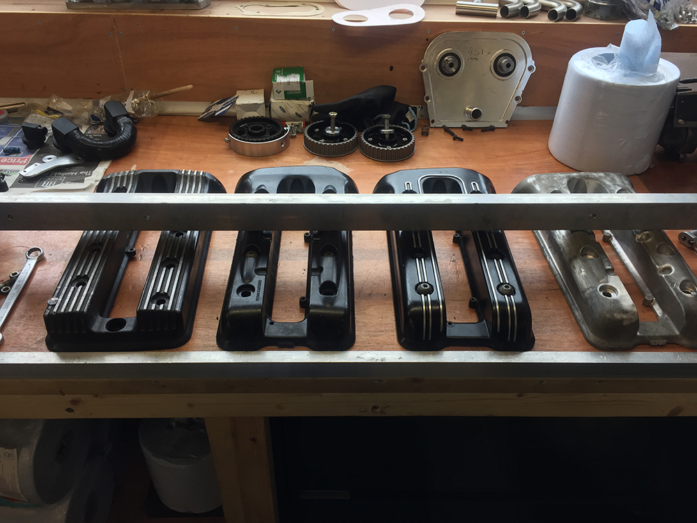

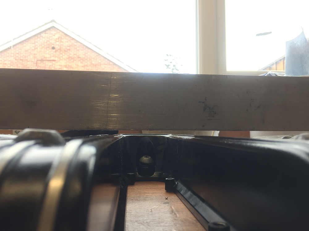

I had similar issues when lowering my engine for my K build.
I found there is some gains in your rocker cover choice meaning a reduction in the required drop to allow clearance. the LT cover gives a height reduction of 5mm over the RS item, the 8V being the lowest (clearance issues were only discovered when making the transition from 8v to 16v).
I also fell foul of having the engine onset to the offside.
Shane
Edited by shane on 27th Jul, 2020.
