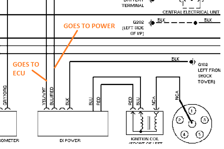

Im now struggling to get a spark, the Volvo runs a Dizzy Setup with a single coil.
Below is a diagram taken from a the Volvo wiring Diag. Now ive basically wired the 12v to 12v, the ground to chassis and the Output to ECU IGN1 on the Megasquirt, when going into the testing bit on TunerStudio I cant get an spark what soever.
Can anyone shed any light?

From what you've posted above that looks like some kind of ignition amplifier to fire the single coil but what are your crank/cam inputs to the Megasquirt to tell it when to fire ?
Hi Rod, thanks for the reply,
Its Ms2 Extra. Ive got a crank sensor, ive tested it using the tooth logger and it appears to be picking up a signal fine.

I used MS2 to fire a single coil and dizzy on my SPI Mini. 3 things I found:
1) I did something wrong when I assembled the engine and the dizzy was out by 180 degrees. Stupid, but then the easy thins are easy to miss. Bypass the dizzy and put the coil output straight to a single spark plug and see if it fires.
2) On my V3.0 board the driver was shorting out straight from the metal back to the PCB. I don't know how I managed that as the Mica insulator and bolt appeared to be positioned perfectly - but still something to check. A continuity check with a meter didn't show this up as it had to arc to short circuit, but the arc was visible with dim lights and higher dwell settings.
3) Get a Volt Meter and check continuity from the driver middle pin to pin36 in the connector. You need to solder a bridge soldered to connect them; I assume you've done this, but still check continuity as the wide copper track doesn't go right to the pins, but turns into 2 thin track right before the pin. With a high dwell setting, or some other wrong setting, there's a slight chance you could've blown those tiny tracks:
Also:
Make sure you can see 12V at the ignition pin (pin 36). If not, check at the coil for 12V to make sure you've actually tripped whatever relays / immobilisers you need to to get power to it. Also check the settings in TunerStudio. I can't remember the setting, but it lets you switch between pulling the ignition wire down to 0V to create a spark (for coils) or pulling the wire up to 12V (external ignition module)
Despite the injectors firing, make sure that Tunerstudio reports a good crank signal and cam signal. Just wondering if your setup only requires one signal for the injectors, but both for the ignition.

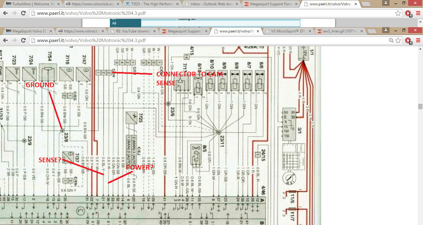

Chaps, looking at this diagram.
The Brown and Black is Sensor Ground.
And the one the Power and Other Sense. So the sense would go to a Spare Input right?
Ive added as an attachment as its quite small
