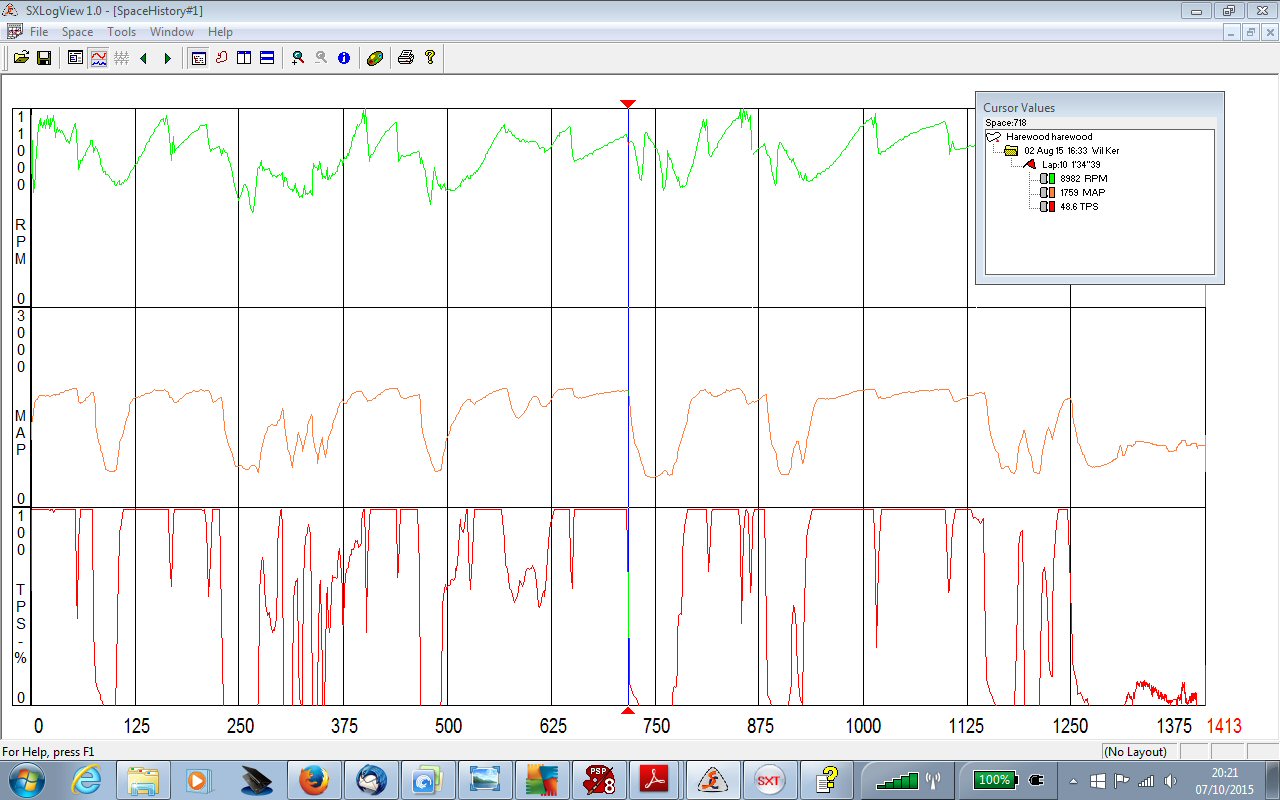

I'm trying to create a base open loop map for the boost duty cycle.
I have a log of the boost/tps/rpm (below). Any clues on how to get a rough map from this?
I'm really only interested in mapping the WOT boost at the moment.
