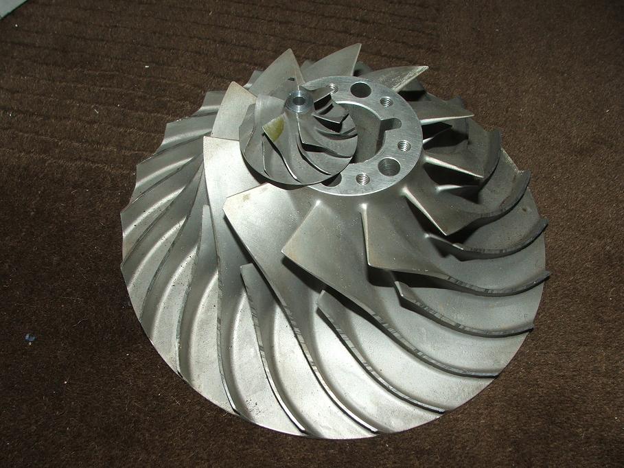

From reading an article about these Chinese copy turbos and working for a manufacturer of what is pretty much a huge centrifugal supercharger, the important difference might not be instantaneously obvious.
the thing most of us cannot easily determine is the unit's efficiency. The Real GT1752 is a fairly efficient unit to begin with. I'm not so sure that the Chinese ones will be as efficient, that is not to say they do not work, but rather, that they do it by producing more heat for less mass air flow.
The things to look for are how sloppy the bearings are to begin with. A sloppy bearing on a new unit will require a larger impeller to shroud clearance to prevent them touching, and it is this clearance that reduces the efficiency significantly. In fact, the bearings needn't be sloppy for the impeller clearance to be a bit baggier than it aught to be. A subtle difference not many people would consider.
At work we've rebuilt machines in the past that had less than desirable impeller spacing on tear down see a significant reduction in discharge superheat when rebuilt within tolerance.
As such I'm still not convinced these budget turbos would be better than a good used unit. I remain skeptical.

Comparison of a GT1752 impeller sat on top of an impeller from one of compressors, which is half the diameter of its biggest sister.
