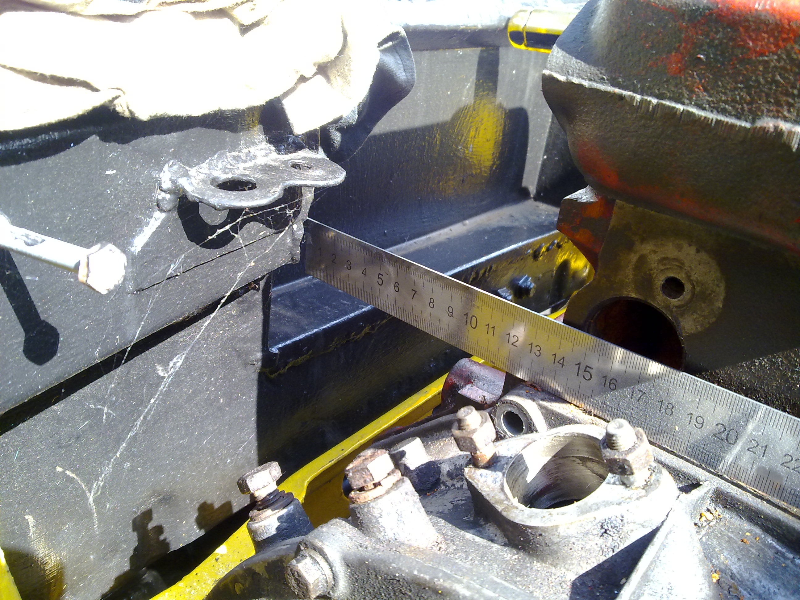

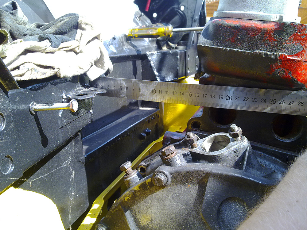

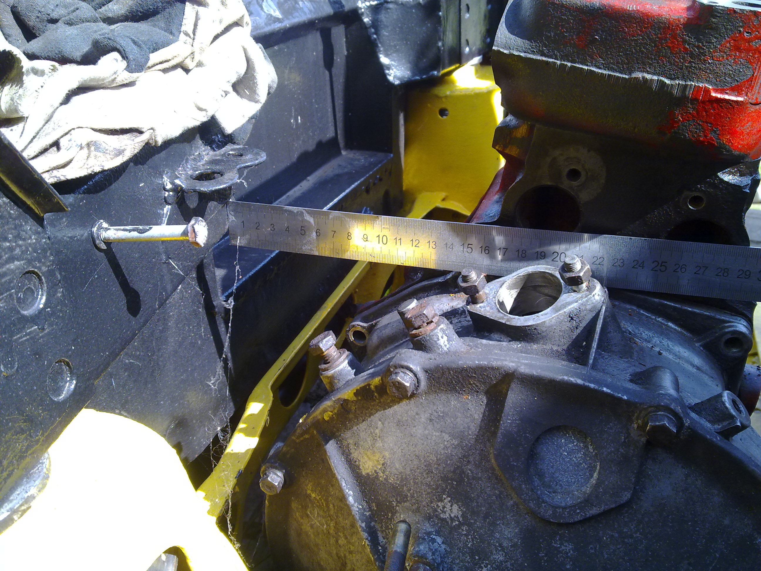

I'll get a measurement of mine when I get home from work for you, about time I popped the hood haha!
any good for you to you?
that is with the engine lent slightly forward
Edited by Brett on 10th Mar, 2016.

Mines not far off 6 1/2 inches so similar to Bretts. It is tight on a mirage!

Brett, are those measurements in a 1275 block?
yes, my last turbo engine 1275
i used an adjustable top steady to lean it forward, i then used the 2 minispares lower steadys aswell
