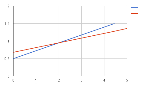

Just checked again and while on the Lambda Input page live, I see the voltage fluctuating as well which I think means that even if I had more or different reference points, the sensor output still appears to be fluctuating greatly.
If am reading correctly from the 14point7 documentation, these are the values that should be in place:
Green Linear Output
Interfacing device; ECU/Gauge/datalogger/etc...
0[v] @ 0.68 [Lambda] Linear to 5[v] @ 1.36 [Lambda]
, equivalent to 10-20 [AFR] for gasoline fuel

Input 0V ---> means Lambda 0.5 --> 7.35 AFR
Input 4.45 V ---> means Lambda 1.5 --> 22.05 AFR
The measuring range is between these values.

Assuming the responses from 4.2 and 4.9 are linear which means they only need two values and the software interpolates from that, the attachment is the values in a simple graph.

The response from the sensor is not linear but the output from the controller is. So you indeed only need 2 values to fully define the output.
And the 14point7 controllers use the same output calibration regardless of the sensor used (as long as you use the correct one). Note that there is an exception for their lean burn product which has its own specific calibration.
