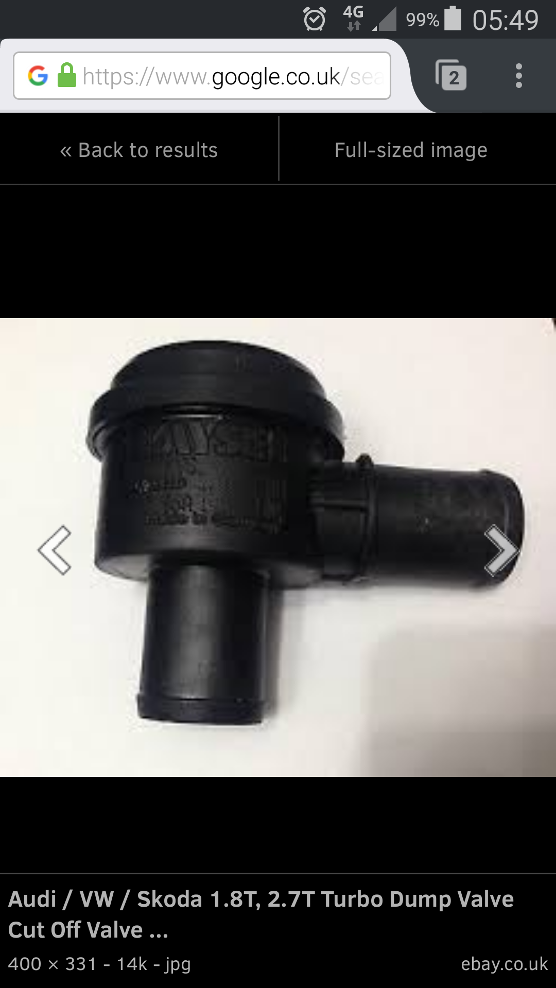

Recirc ones are almost totally silent
If you look for one of an audi you can pick them up for pennies of ebay
These.. even says at bottom what there off
Turbo This..

I have fitted a few cars with the Bosch plastic valve above, good value for money I think I have bought them for £8 from ebay before now!
