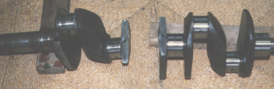

A firend sent me this. Non boosted 1100cc

To be fair the very first A-Series i built was a 1098cc. It was on really tight budget and couldn't afford a 1275. Revved to 7k without issue but i did do the full works to the bottom end. Couldn't even afford ARP bolts so used 12.9 cap heads instead. Im pretty sure it made more go than a 998 would have. Was about 65-70hp if i remember rightly, not bad for a road engine with zero budget.
As the others have sad tho. Useless for hill climbs. You either need an overbored 1275 or a 998 with a turbo.
