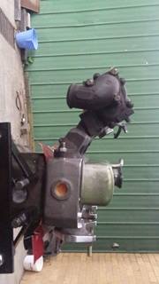

This turned up in the mail today :)

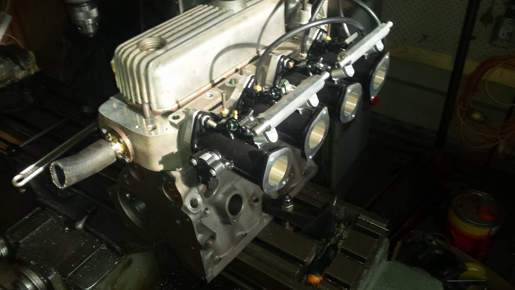

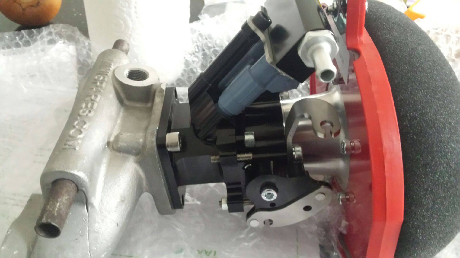

so after lots of thinking and homework I've gone down the 7 port road with efi. N I've started building my inlet manifold, which is taking some time as I drive a truck and trailer { you guys call em lorries } 14ish hrs a day.
Over a few beers and a bbq the other weekend my brother inlaw and I looked in a box and went " ohh .... that will help "
so this is what I have, yes the manifold i upside down but that mean I don't have to cut the crossmember to get it to fit, just need a bonet bulgde ....read POWA bubble :)
1977 Leyland mini Sunshine -- moleseted -- Named " Ray" becoming a 7 port efi slowly
1971 Nota Fang 145 bhp 5 port fun @ 450 kg
1969 Austin 1800 ute, 1800S running gear, tip rat and hardware store runner
you might be able to just get away with kicking the back edge of the bonet up by bolting it to the higes with the rear stud on top of the hinge instead of through it. that giveabout 1.5" lift iirc.

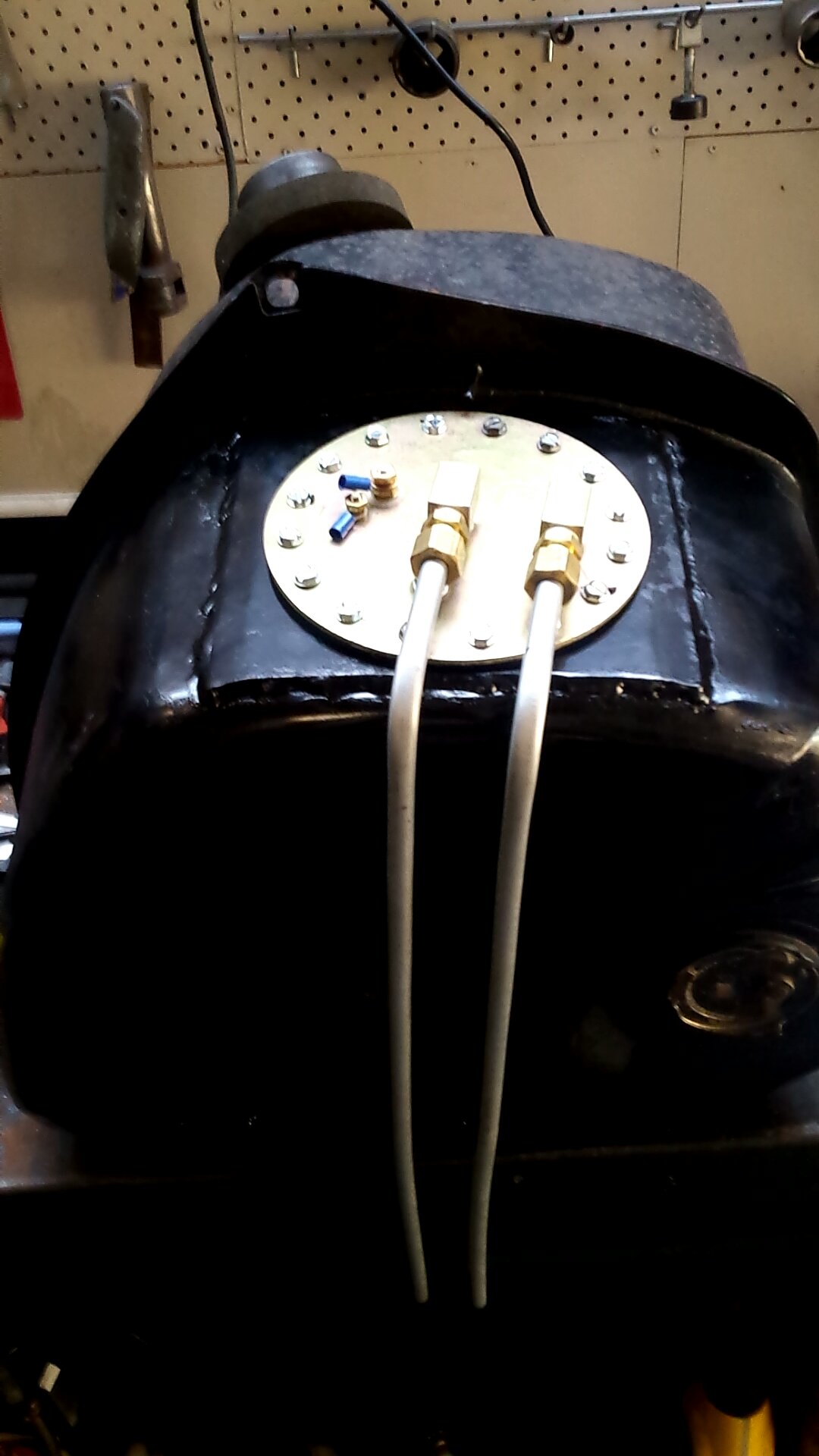

well I got some more time in the shed this weekend and have managed to finish the pump mount and tank set up
clbm4n
62 Posts
Member #: 11458
Melbourne Australia ... not a convict
this is the tank and pump so far, 190lt Walbro pump with in tank "sump " and filter.

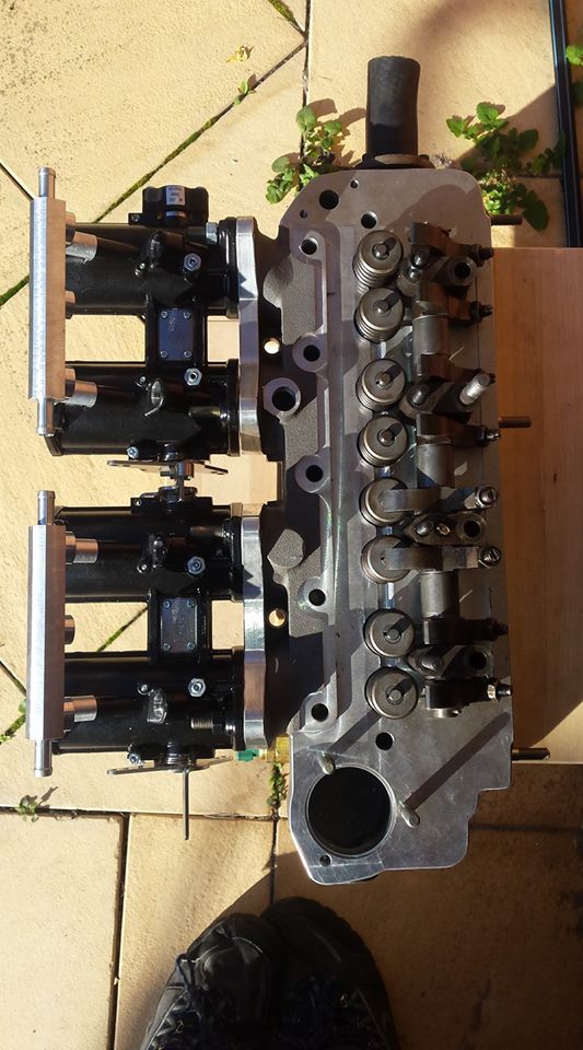

So this happened yesterday *Clapping*
pair of 40's with mahoosive 370 cc injectors, now to make a throttle cable linkage and then send to head off to get tickled. Kawasaki valves are apparently the thing to help with gaining valve lift.

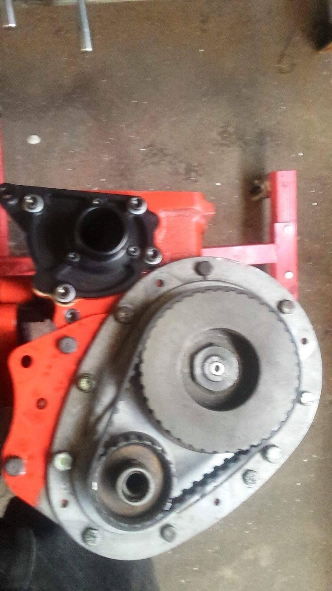

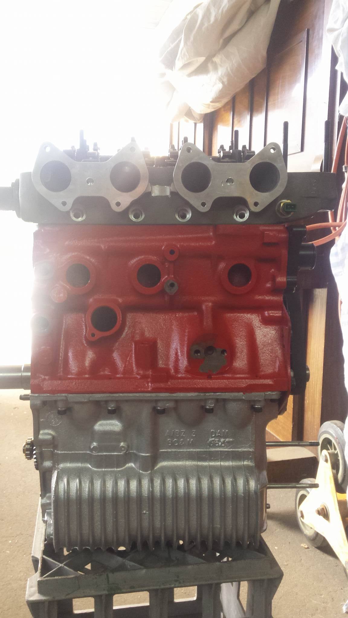

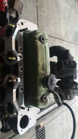

So as it continues at a galical pace .... don't want to work too hard lol
It's a 110S block, Dam 5626 box with Guessworks x-pin centre ,3.44, bored to 73.5 with a set of cast pistons, 81A cam { 292" lift @ lobe, 106 deg lobe sep, 228 deg lobe duration} A+ crank @ 10-10 with A+ rods lightened and balanced, dry decked, cam belt kit and MED water pump plate.
slowly slowly ..... soon it will get it's 40mm tb's for it's last time.
Just trying to decide on what rocker cover to use, std steel, classic alloy { in pic .. period part} or the square alloy box.
Those throttle bodies would never fit under a roundnose with a plenum, its one of the reasons mine took so long.
