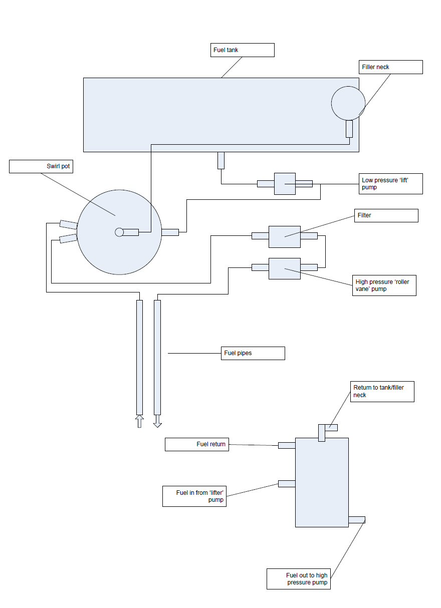

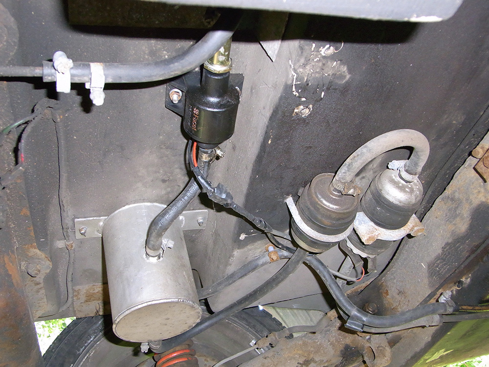

I fitted an external swirl pot. Pumped fuel into that and then returned to the filler neck.
Like this
This is a schematic of how it's all piped up.
www.twin-turbo.co.uk

Ah right that looks alright thanks for that. So no mods were needed to the tank?
pickupmad87
15 Posts
Member #: 10647
Did you buy that swirl pot from somewhere or had it fabricated?
Ive bought a swirl pot with integrated fuel pump off ebay. It was about 130 for China iirc.
Came with a load on AN-6 fitting and braided hose too :)
