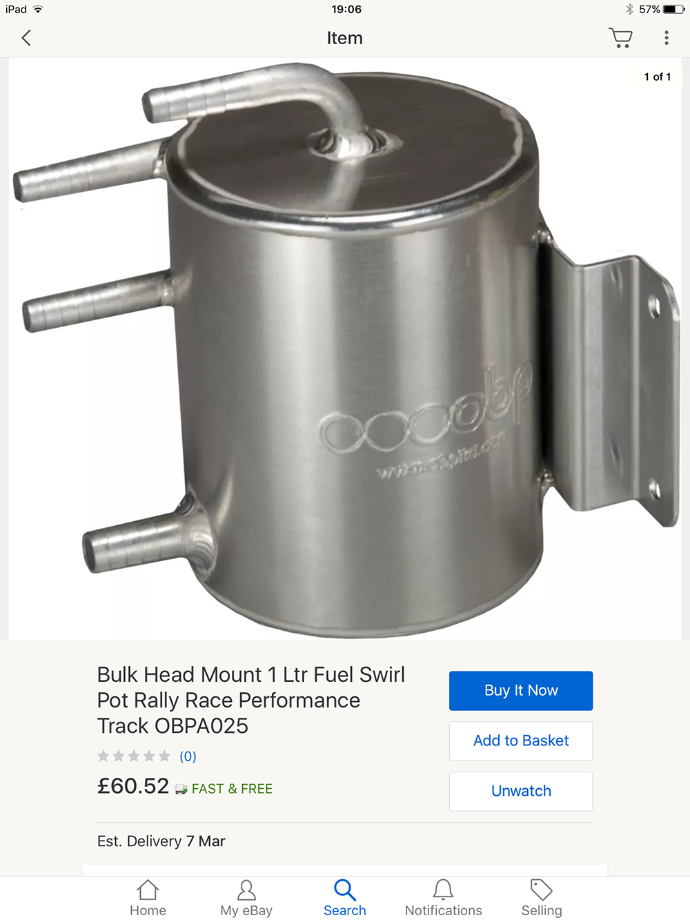

Ok it looks like I'm getting somewhere, I am going to buy a metro turbo fuel pump but I also need a lp lift pump ! Is there any kind that anyone can recommend and also a suitable swirl pot please , thank you 😃
Hoops
94 Posts
Member #: 10338
Huddersfield
Is this swirl pot above suitable chaps ? It's 1 litre
I've got a pump in the for sale section that would be fine for a lift pump.

Great il take a look 😀
Do you think the above swirl is suitable ?

This looked spot on but the swirl pot doesn't look like it's available at the mo , so I need to be looking at other options, cheers
