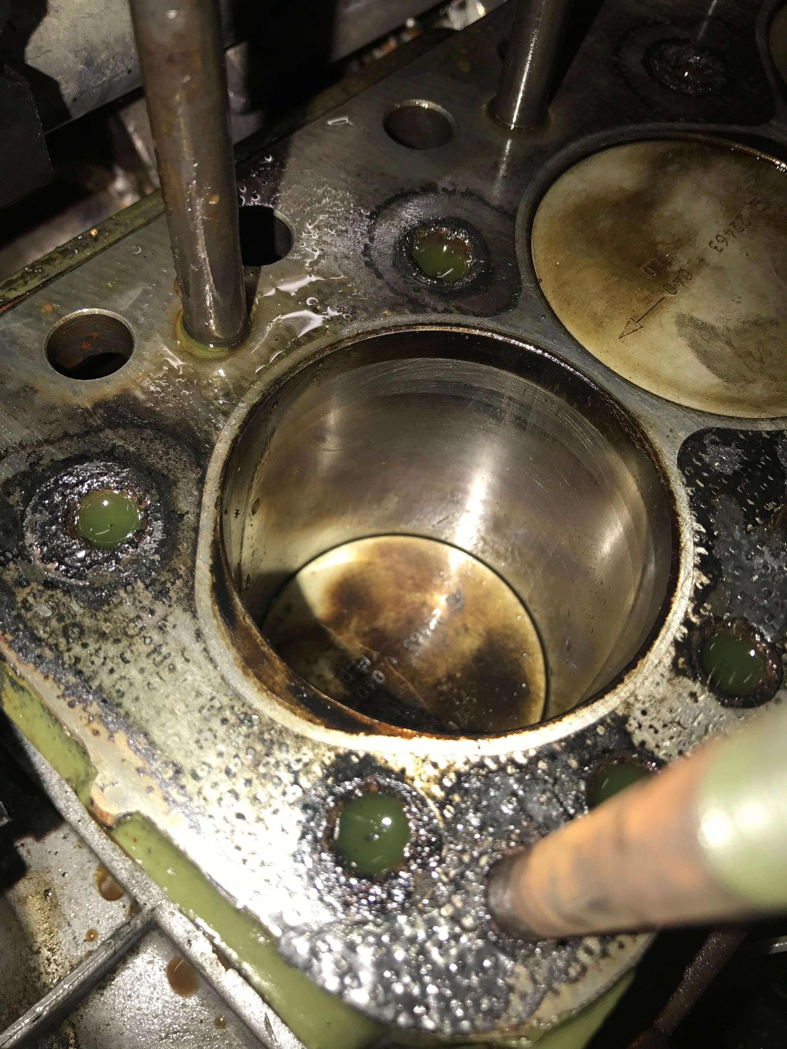

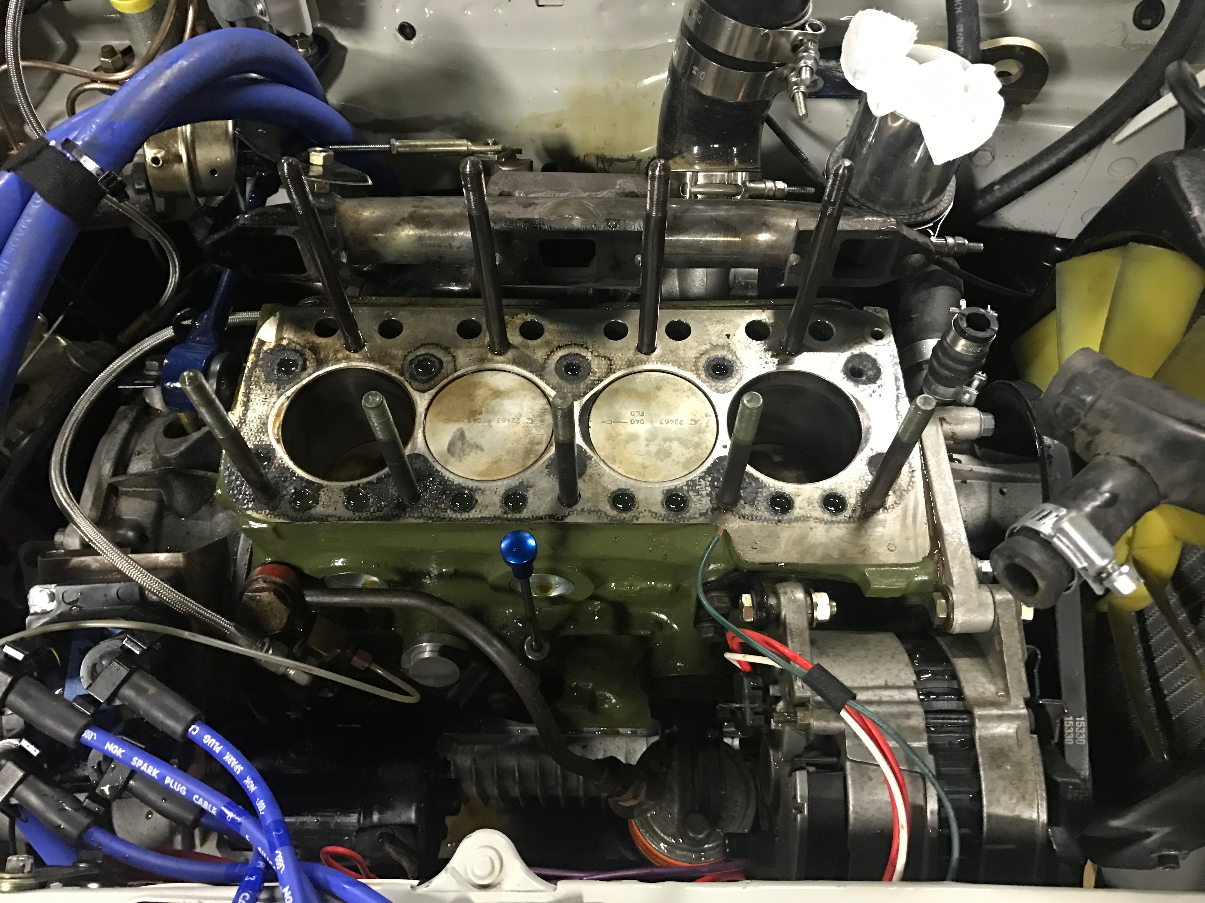

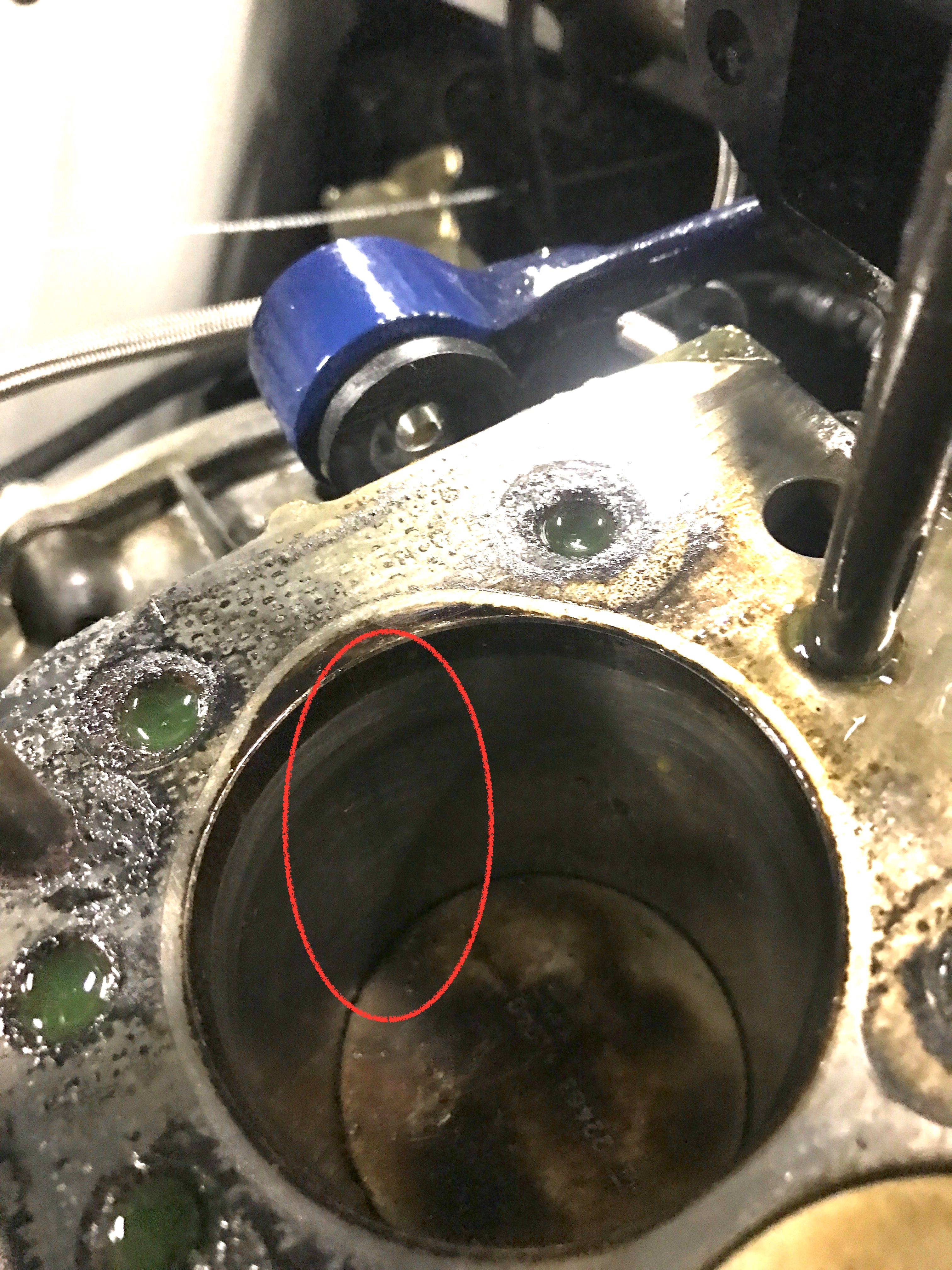

Okay well, I took of the head today to see what I could find. Here's what I got. Is there anything else I can check in this state or is the short block destined to need to come out.
![]() 1849 Posts Member #: 672 The oversills police Oslo, Norway |
15th Jun, 2017 at 06:09:29am
I would say those bores are very shiny for 2 hour runtime only. those vertical lines are difficult to see in picture, but does not look bad to me. |
15th Jun, 2017 at 07:01:07am
As above, I've seen cross hatch honing still visible on engines after thousands of miles.
Edited by Rod S on 15th Jun, 2017. Schrödinger's cat - so which one am I ??? |
![]() 6754 Posts Member #: 828 Post Whore uranus |
15th Jun, 2017 at 07:32:55am
have you a spare piston you can measure the skirt of, then pop it in the top of the bore and see what size feeler gauge you can get i the piston to bore gap ?

1767 Posts Member #: 9165 Previously josh4444 Australia, brisbane |
15th Jun, 2017 at 10:30:52am
the vertical line is the ring gap ether the ring is not turning free or the ring had a burr on it when installed

15th Jun, 2017 at 10:01:16pm
Those bores do look as though they have suffered fuel wash....... How rich was rich and for how long before it was fixed if at all? You can clearly see the first, second and oil ring wear pattern in the hone on the bore
Yep I agree with TD........ |
