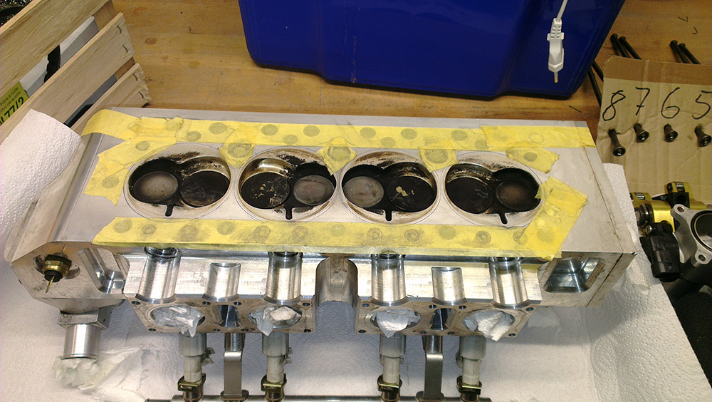

Have you spoken to SC? Have you checked to see if it is true in that area?
evolotion
2909 Posts
Member #: 83
Glasgow, Scotland

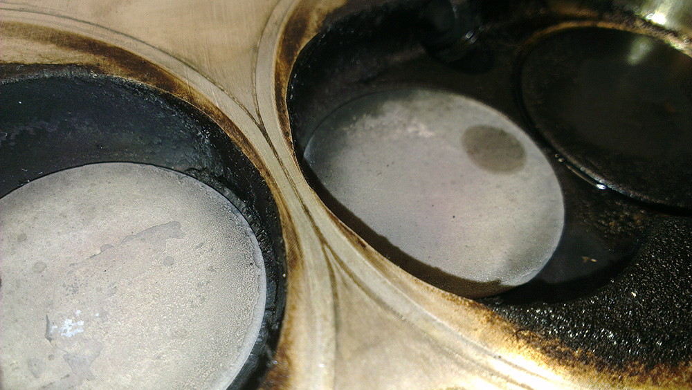

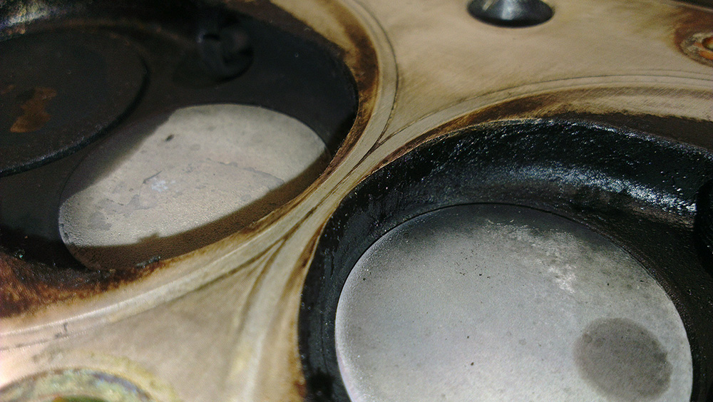

any chance of a pic showing all 4 cylinders? got to be honest they look oily as hell, and the fire ring doesnt look breached. :/ how does the block look too?
Denis O'Brien.
how come cyls 2 and 3 are on compression at the same time?

It does look very oily and the exhaust valves look very lean.
Do you have a photo of the failed gasket?

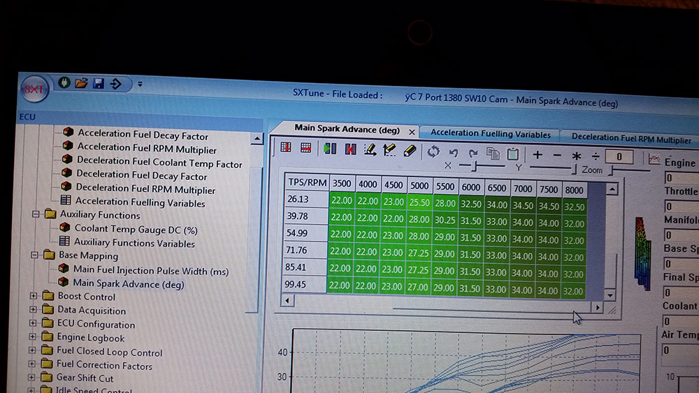

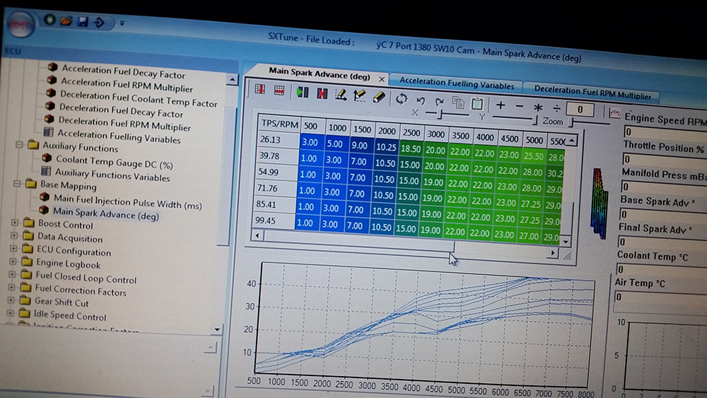

Ignition Timing

Looking at the valves it looks lean.

timig chart looks good, but is the timing confirmed with a strobe? as the trigger wheels have been known to slip,
I'm thinking extra heat build up from retarded timing
I'm thinking maybe a random timing value ATDC.................. Maybe

pistons are well oily and bores are shiny from the pics hes put up on TMF.
i's starting to wonder if its got any ring lands left.
