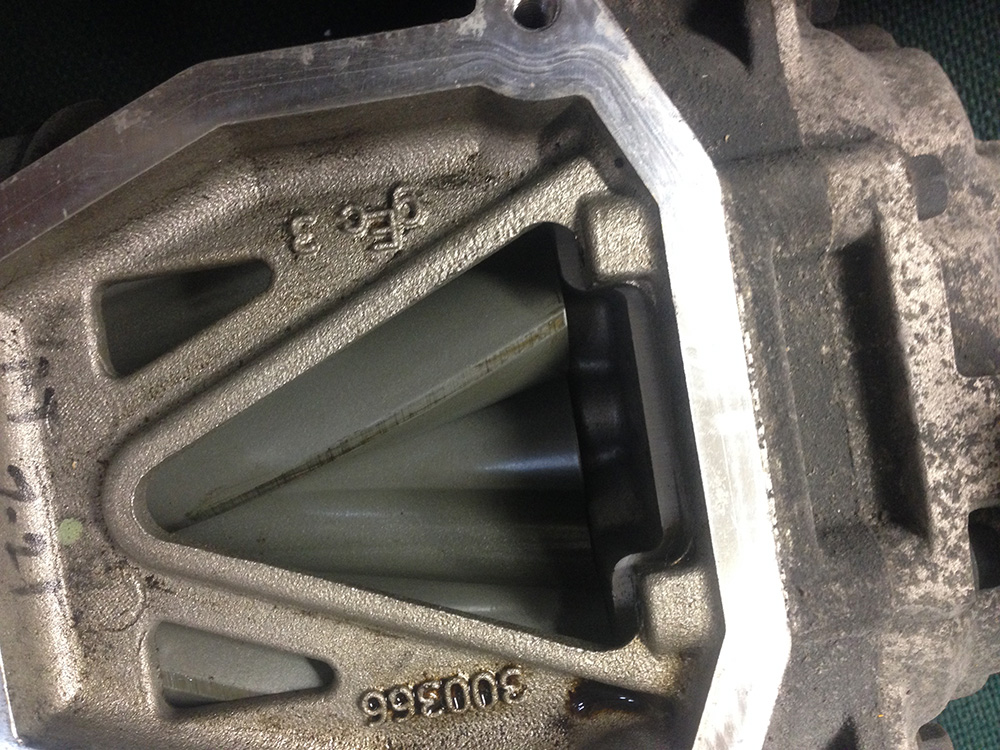

Hi Guys,
New to the forum and forced induction. Looking at purchasing a Eaton M45 from a new mini. I managed to get a jonspeed kit for cheap so now I just need a supercharger.
Found this one for £100, which seems super cheap atm. (They're £200+ on ebay). However I'm worried about the blade damage. Whats everyone's thoughts on it?
I'm picking it up this weekend, so I'd love your advice before I go.
Rob

I see your point Brett, but you could easily get a fooked SC for £200.
I know nothing about the tip condition of SCs, they look ok to me.
www.twin-turbo.co.uk
These are notorious for the rota coating coming off with fuel going through. I don't run an eaton but the look ok I had some score marks on my sc12 where they meet, but I guess when you think about it, it will have some liquid in there and not just air, should help seal them up😀
yeah i agree, i dont know how to spot a good or bad one either, i think £200 for a good supercharger is cheap anyway, i did not know they was available for that sort of money

i would assume the rotor tips have contacted the housing due to worn bearings or a bit of dirt/grit has gone in there to create marks like that
That SC looks ok to me. I've seen a hell of a lot worse.

Another vote for it being fine.. Or at least as good as you will find. Even the low milage ones you used to get off the early Cooper conversions where the blower had literally run no miles had scoring on them.
300quid is very optimistic tho. You may get the thing bolted on for that but that's the easy bit! You have to think about the ignition timing for one. Then you have to have it set up.. The Jonspeed kit is also shite so you will probably end up binning parts to get it to stop icing the carb up and that sort of thing.
