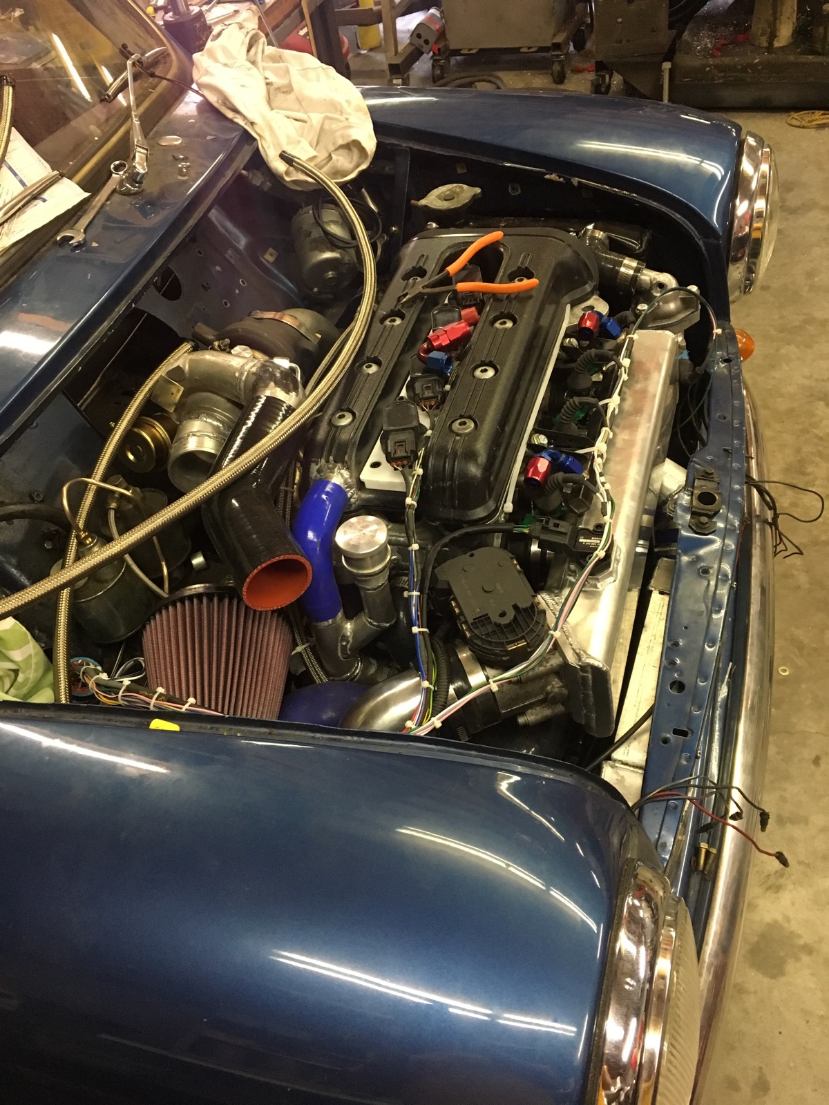

This is something I've honestly never really paid much attention to, but now need to. My bores and piston rings are what I believe can be described as "seasoned" - but aren't worn out, giving quite acceptable leakdown readings. But I seem to be getting a lot of spray out of my breather. Clearly a catch can is in order, but what constitutes a "best practice"? I know bigger is ALWAYS better, but surely I don't want (or need) 30mm hoses everywhere?
I guess we can start critiquing this:
It's a little hard to make out, but the alloy cap is on a 1" dia tube that goes down to the breather flange on the transfer case. The breather hose on the valve cover also connects to this, as does the head oil drain ( level with the bottom of the main oil gallery in the head). At the bottom, just above the flange, is a –6 drain for the head, from one of the two long drains that are cast into the K head as the original drain.
I don't have a breather in the dizzy hole, and the more I think about it, i'm wondering if everything that's trying to drain down out of the head, is simply being blown upwards and out of the breather...
Maybe a dizzy hole breather would help, but I'm starting to think I made a boo boo on putting the drains into what is basically the breather stack?
Edited by turbodave16v on 12th Sep, 2017.
I found this slightly less obstructed picture, but that was before I added the actual breather filter, and you can't see the head drain either...
http://www.turbominis.co.uk/uploads/i/wh12...bodave-4021.JPG

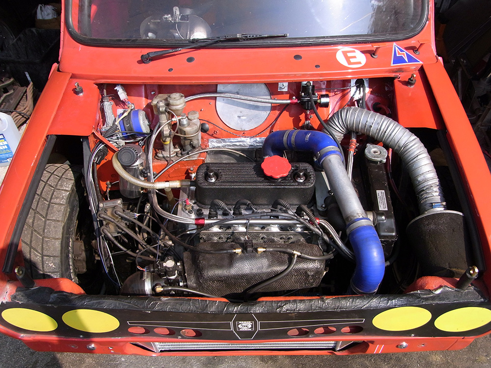

Ive always piped everything into the rocker on 5 ports and used that as a "seperator" I dont like the idea of venting the stack from the transfer housing as the drops can apparently throw up quite a lot of oil.

Can you see how I did mine here?

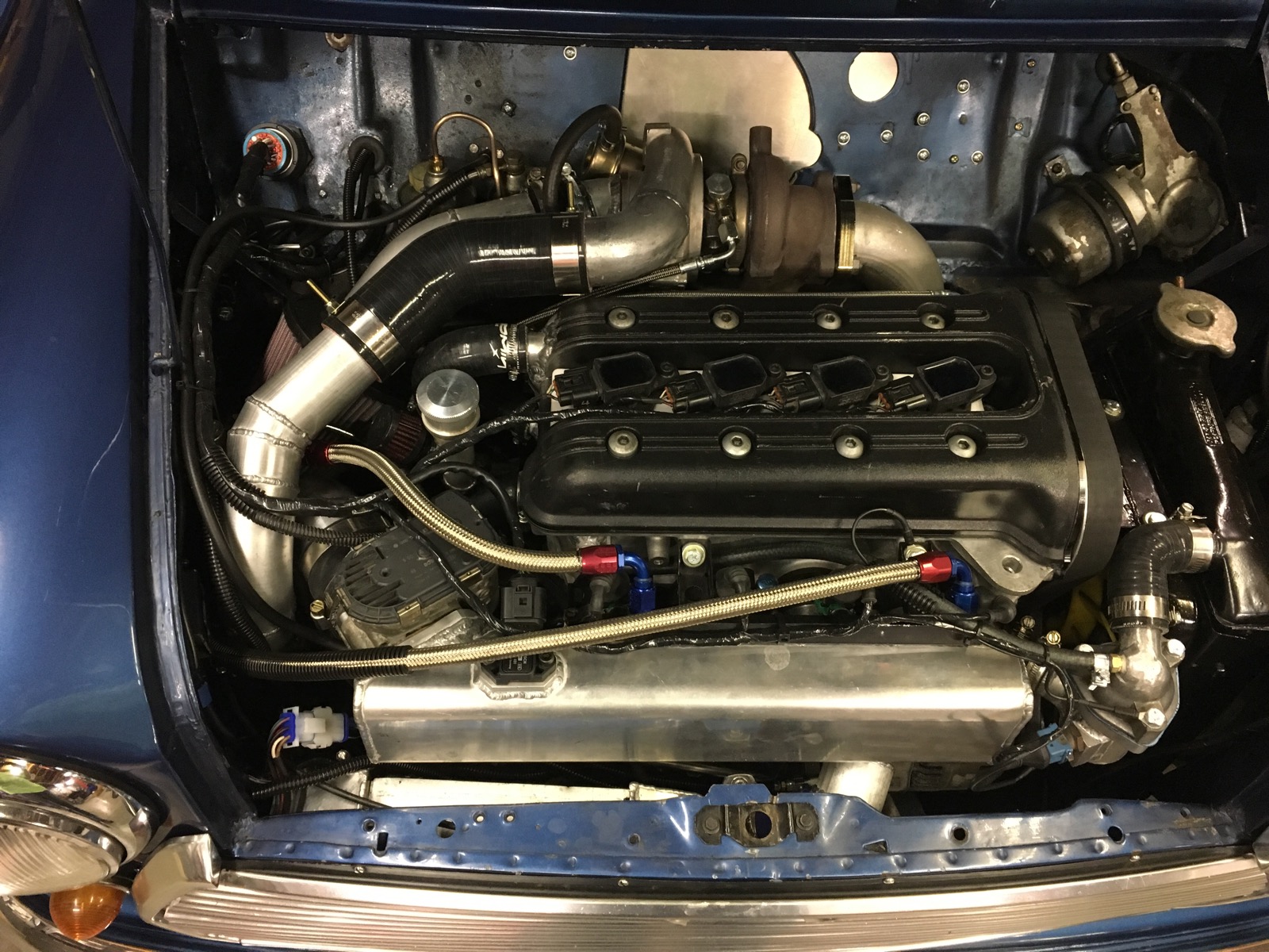

Well I thought I'd post and update as JT bought this to the top again.
I modified all the drains from the head to go down to the fuel pump hole. The 1" pipe going vertically of the transfer case (which also has an oil fill cap on the side) goes into the end of the rear half of the 'K' valve cover, with nothing else plumbed into this.
Out the end of the front half of the valve cover i have a 3/8 bore hose, going to a catch tank I knocked up. The tank has a baffle plate just above where the pipe comes in, in an attempt to separate the mist from the oil.
I routed the outlet of the tank to a temporary plastic water bottle on the inner wing to determine the effectiveness, and it is a world of difference; no oil, no oil mist, just condensate which has gathered.
I'm absolutely sure that dumping the K head drains into the transfer case breather is a very bad idea, and that having two ports (in and out, at opposite ends of the valve/rocker cover) is a good idea, as it aids in seperatimg the oil/air mist from the breathers.
As I'm now very satisfied with my breather setup, I'm going to look to pull even a small vacuum with one of the many ideas above.
