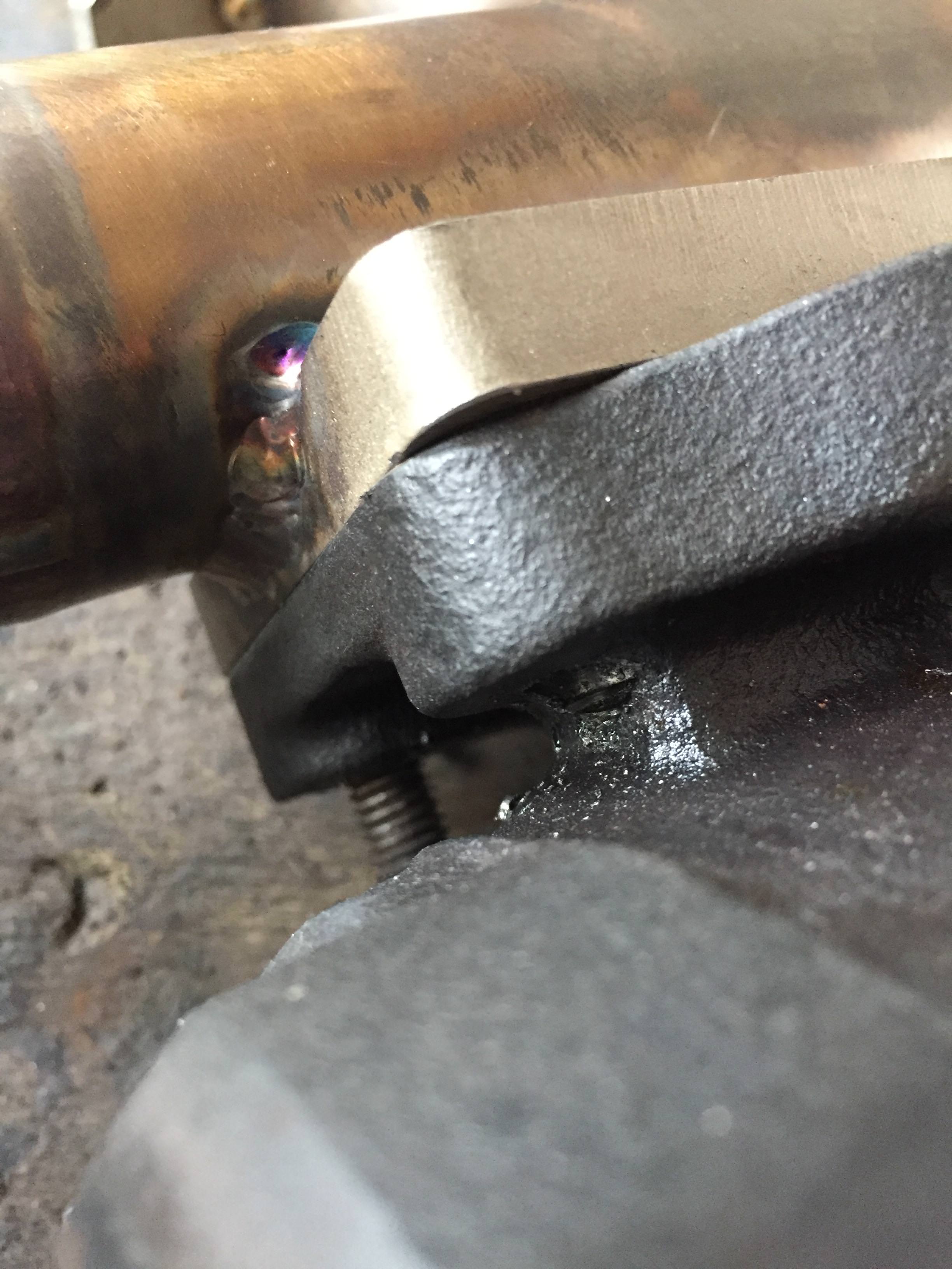

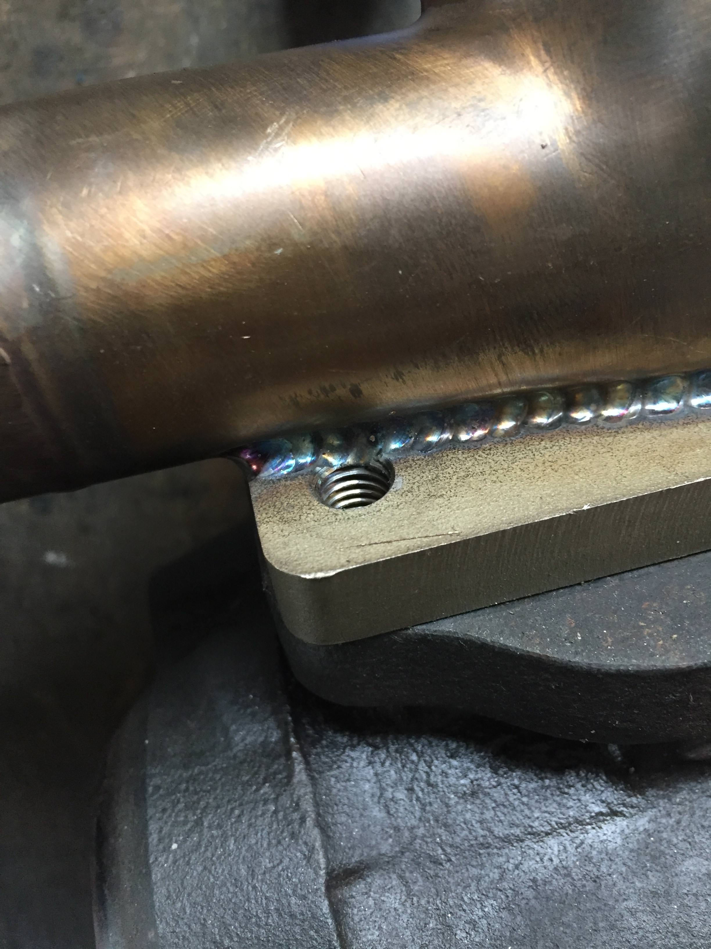

Hi all,
Finally drilled out my GT17 manifold to take Matty's manifold and have come across an issue. The stud location pictured can't have a nut either side, what have people done in similar situations?
Edited by Steve220 on 2nd Nov, 2017.
Slot both, allowing you to slide a nut and bolt sideways in, and tighten.
That’s what I’d do at least.
K-nut and start tightening this one first before you have the turbo fully against the flange
Drill out the turbo hole and grind the back face flat to get a nut in.
That's what I did.
www.twin-turbo.co.uk
this, there is plenty of meat in that section of the turbo, put stud in manifold
That's what I did.
stevieturbo
3597 Posts
Member #: 655
Northern Ireland
Vise grips and just leave them there ?
9.85 @ 145mph
202mph standing mile
stevieturbo
3597 Posts
Member #: 655
Northern Ireland
Or you could drill/tap a new bolt hole entirely
